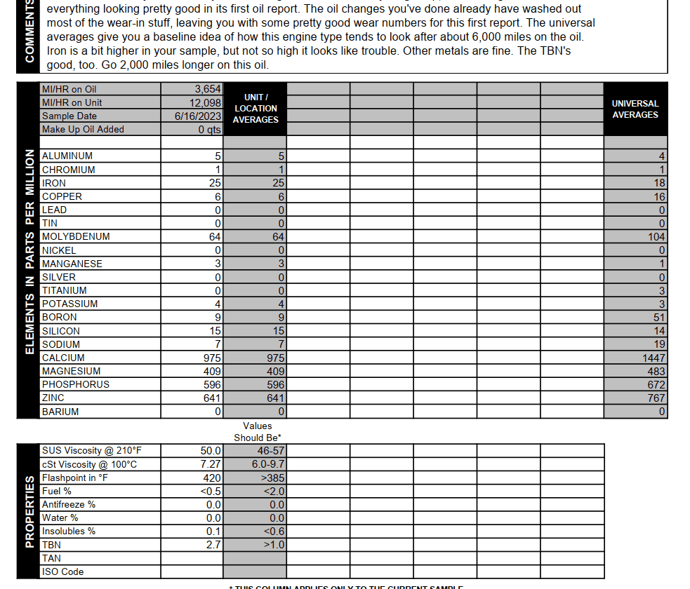

Sent in sample with total of 12,098 miles on engine, 3654 miles on oil.
Sample pulled via dipstick tube after a 20 mile round trip to town and back, stopped truck, pulled sample right away.
So this is the second oil, 12,098 miles on the engine, 3654 miles on the oil as tested.

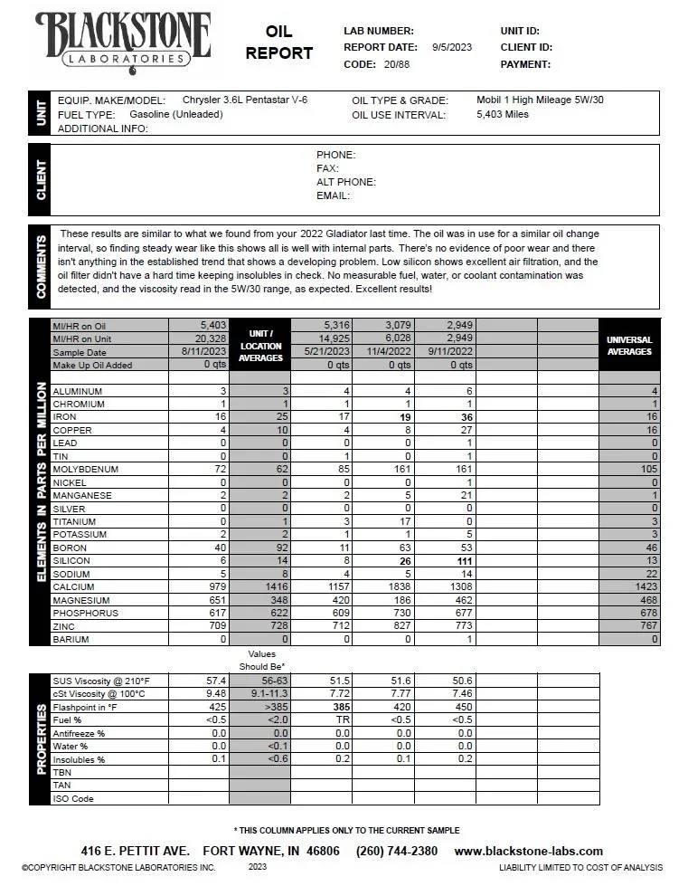

Here is the latest one where I ran a 5K mile OCI of Mobil 1 High Mileage 5W-30 I had on hand. Trends pretty much the same as the previous MOPAR 0W-20 other than viscosity.

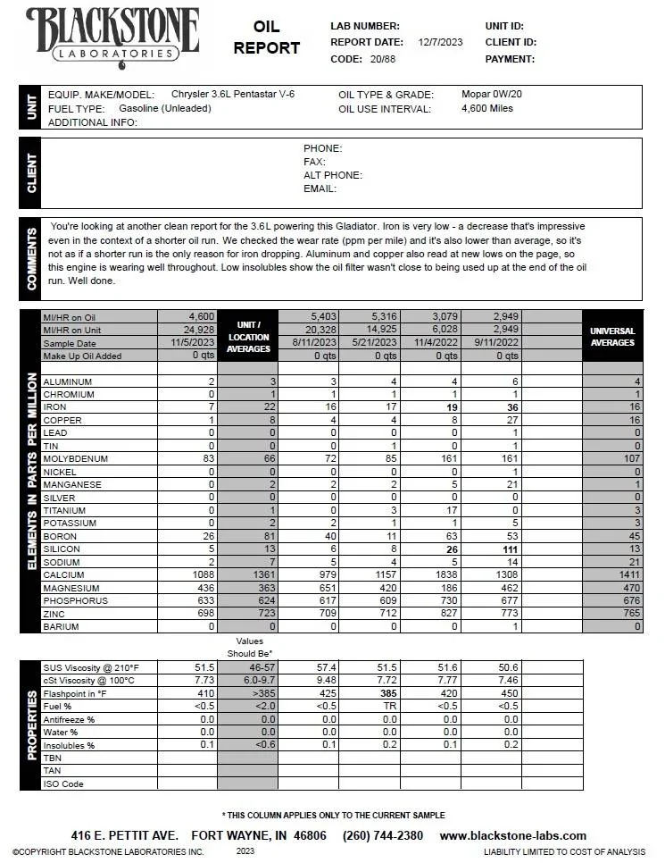

Latest report running my second Jeep Wave oil change. Ran it for 4600 miles this time. This report took 4 weeks this time to get back. Blackstone is slipping hard of late getting things done.
Anyways, things continue to trend down and am pretty happy with the iron levels. Currently running Mobil 1 AFE 0W-20.

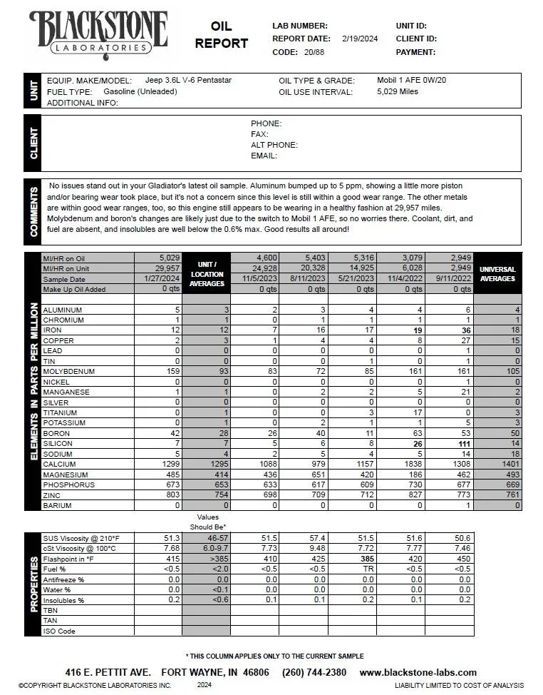

Well, looks like Blackstone is picking up the slack as this latest sample took only 3 weeks when others lately have been reporting a 5 week turn around.
Anyways, ran this for 5,029 miles using Mobil 1 AFE 0W-20. Aluminum did bump up smidge but this is the first oil run with a recently installed Baxter Performance oil filter adapter that is primarily an aluminum body assembly. So I will monitor that going forward.

If I recall, the only aluminum wear area in these is pistons. Not sure why their filter adapter would make such a change but who knows. I'd think it would have to actually erode or wear to contribute to aluminum. Still not a big number.

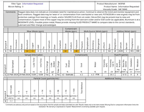

Got my first Oil sample report back..... I'm sure the jeep wave would be ok but I like doing my own as I plan on having this truck for a few years. monitoring the oil while in a stock state allows me to make informed decisions before I add items such as a different tune etc...... as i see what changes data wise. PZ euro 5W-40 for the fill along with a MOPAR filter....Fuel filter will get changed next time. I plan on a 5k change schedule as this is my truck and i can love on it more than the factory recommends. Our other jeep with the 2.0L engine gets a 4K schedule as Italians like being clean. I think this VM Motori is in the same category. I wont really get an accurate read until like oil change #3 or 4 and then will decide if I want to change the tune etc. Been reading how the % fuel dilution in oil is affected by tunes.
been doing more highway miles last couple of tanks and the average mileage is creeping towards 24..... could also be coming out of winter fuels which would do the same thing lol.
You are probably better off starting it's own thread or taking this over to the diesel section. Your wear numbers if I was to look at it through the lens of a Pentastar oil analysis averaging trends, the aluminum and potassium numbers are high even for a new engine.
Thanks will do :) hoping the Aluminum numbers are not a trend but I do have the 125K 8 year max care so not to worried at this point... just documenting as I go ;)

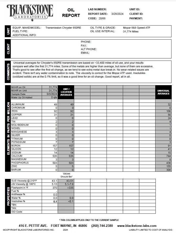

This report I dedicate to @Maximus Gladius
Recently did my 850RE transmission fluid and filter change at 31,774 about three weeks ago.
https://www.jeepgladiatorforum.com/...ning-no-politics.23705/page-1809#post-1267876
Pretty much everything checked out fine. Aluminum was noted to be bit higher than universal averages but not deemed excessive for a initial fill. ZF 8 Speed fluid went back in and will probably change again at the 60K mile just see where the Aluminum is trending and may extend it out to 50K mile changes after that.
