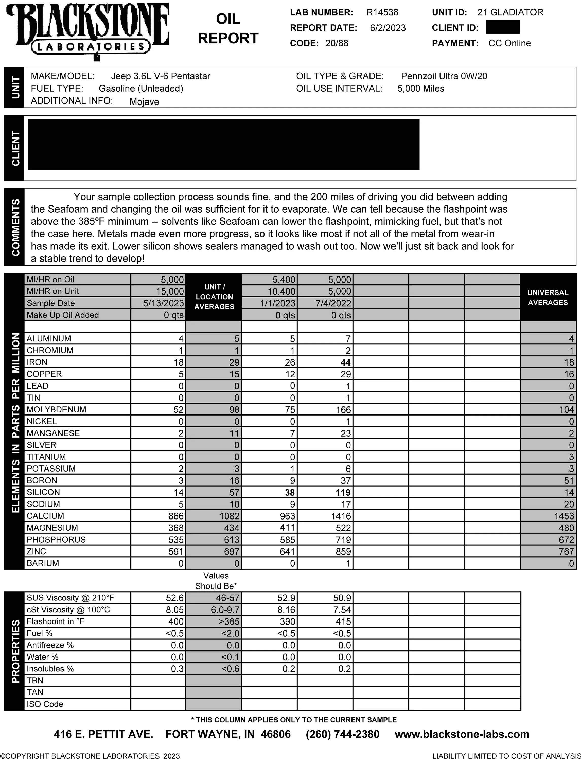

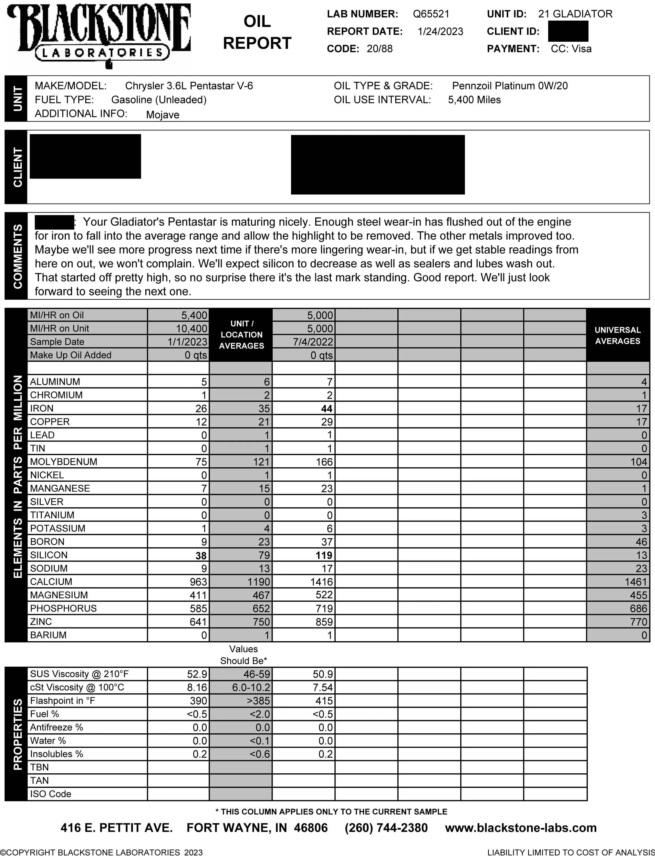

10,000 miles and still looking good.

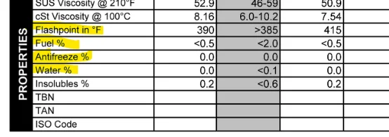

I look at these numbers as it's an indication of not just "wear" vs. "Abnormal wear", but how well the engine is being managed (fuel) and lack of any leaks such as head gaskets, cracks and so on, and the lack of water says there's likely no extreme condensation - it's warming up and keeping water out of the crankcase. The flashpoint states no fuel contamination and it's a decent oil with a high temperature tolerance.
Jeep Gladiator XXXXX Mile Oil Analysis 1674661407389
The zinc and phosphorus I'm still getting my head wrapped around as far as when seen in oil analysis, but if my ducks are lining up, as time passes and the correct combinations of pressures and temperatures are reached, the ZDDP in the oil forms a layer of protection on certain engine parts. There can be too much which actually causes damage, the opposite of what many old farts claim. I'd have to look back at my notes and stuff but it would appear you have decent levels there and indications are you may be getting that protective layer built up. It's more of a "feeling" than something I can point out on a whiteboard.
I guess I'm suggesting - looking decent, don't add crap to the oil LOL

15,000 - Still looking good.
FWIW, in a prior life (I'm retired now) I was a Certified Level 2 Oil Analyst and ran my own analysis lab. Admittedly, my clients were industrial and as such we did not deal with oils that had the same add packs nor the risk of fuel/coolant/combustion contaminants but the premise is still the same.
As you've now done a few oil changes and a few oil analyses, you could make a reliability-based decision to perform an oil analysis only every 5000 miles (at least that's what I would do but you could go 3000 miles if not comfortable) and only change the oil when the indicators of the analysis indicate unfavorable viscosity changes, excessive wear particles, ingress of contaminants, breakdown of add pack, etc.
I had a 350Z when I was running the lab and had fun doing this. I would pull samples at 1000 miles and then base my oil changes on the same advice I would give clients. Interestingly enough, on that car and it's use case, it worked out to essentially every 5000 miles that I was changing the oil...LOL.
