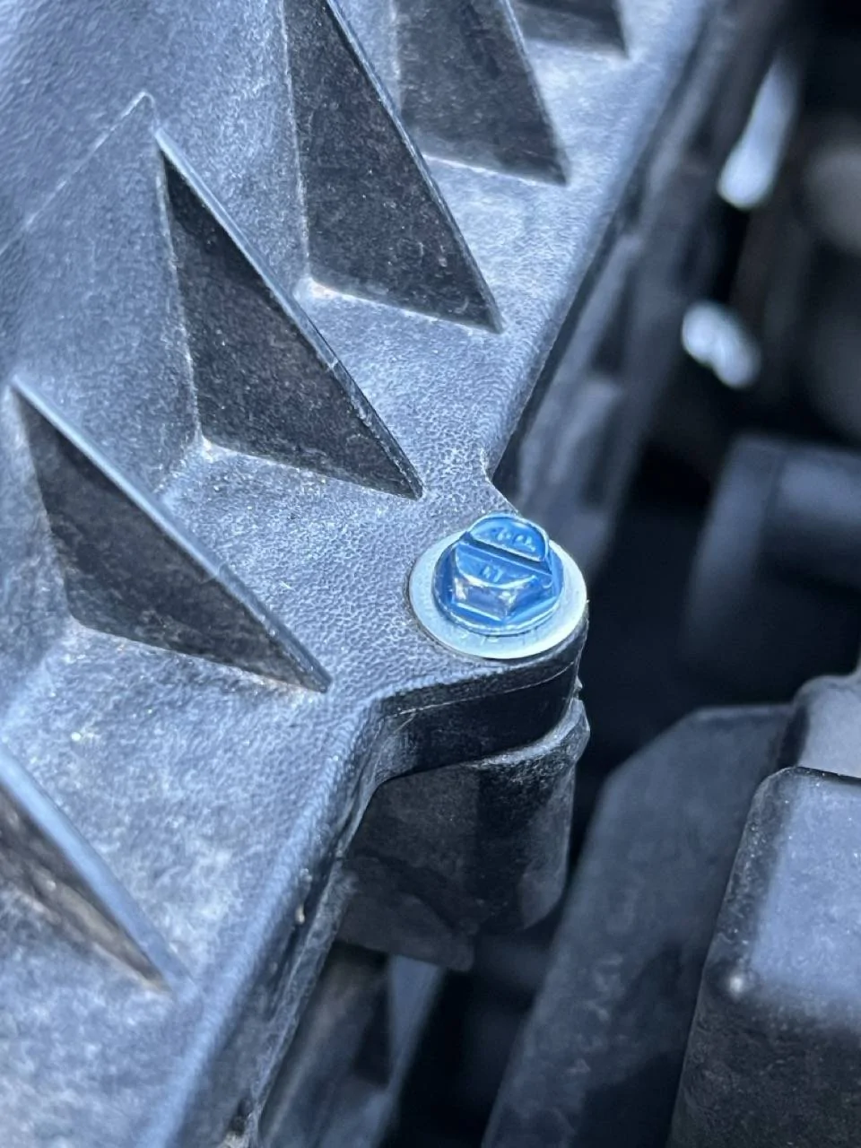

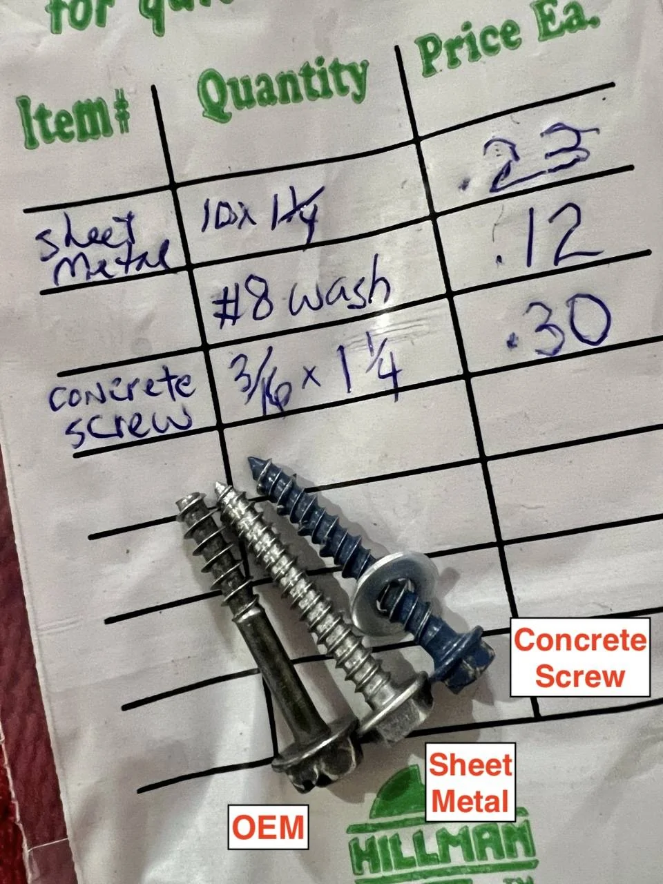

I just lost one of the air box screws and wanted a quick fix, so here's a couple substitutions that work. Found them at Ace Hardware: 1. Concrete anchor screw (w/ washer), 3/16 x 1-1/4". .. Or .. 2. Sheet metal screw, #10 x 1-1/4".
Jeep Gladiator Air Filter Box Screws.... Gladiator air box screw-1
Jeep Gladiator Air Filter Box Screws.... Gladiator air box screw-2

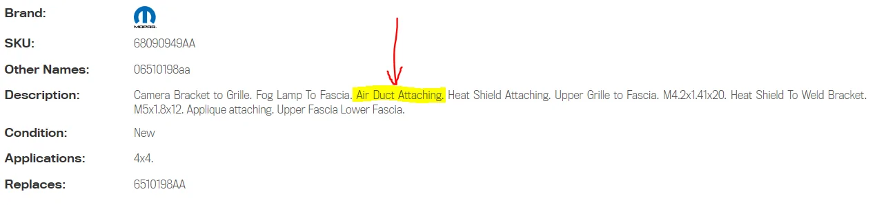

Having a little trouble locating 2 screws for the ram inlet duct assembly. Its located below the air box and attaches to the radiator shroud. The dealer is having a little trouble finding them in the system. They can just tell me that they are T20 screws.
Any help would surely be appreciated.
Thanks and safe travels
jac04
Jeff
Apr 20, 2021
1,549
2,256
CT
2021 Mojave, 2014 JKRX SWB
I'm pretty sure this is what you are looking for:
