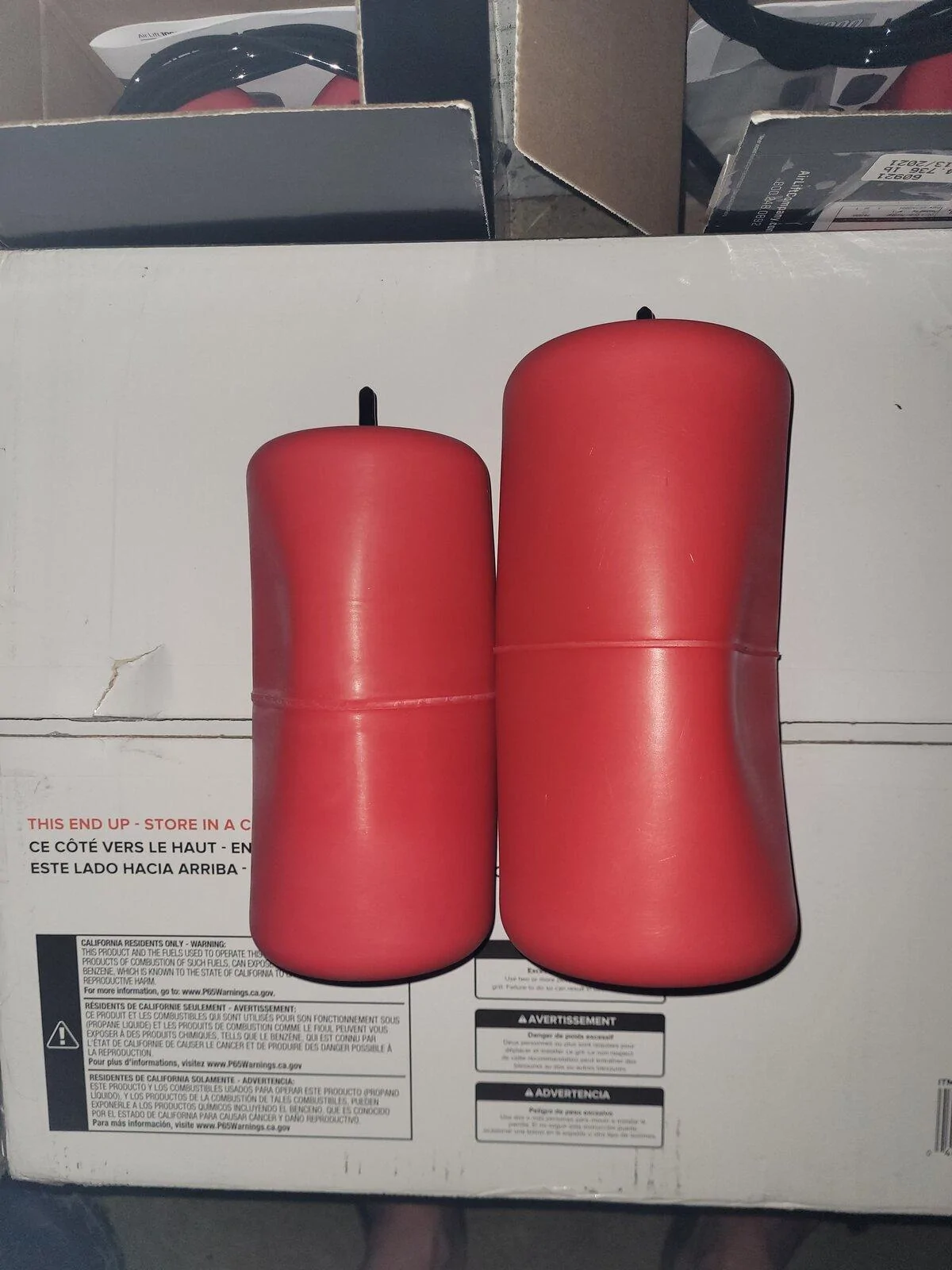

Got kit 60317 today. As expected, the kit isn't close to being right. Not only is the diameter narrower than the Gladiator kit but the length is shorter. I don't know what is up with Air Lift but it seems they don't know what's in their own kits. So, the OP still has it right...the Gladiator kit is the best you're going to do and stacking pucks to reduce empty vertical space is OK on paved roads but making a thicker, custom puck is your best bet if you're going off road.

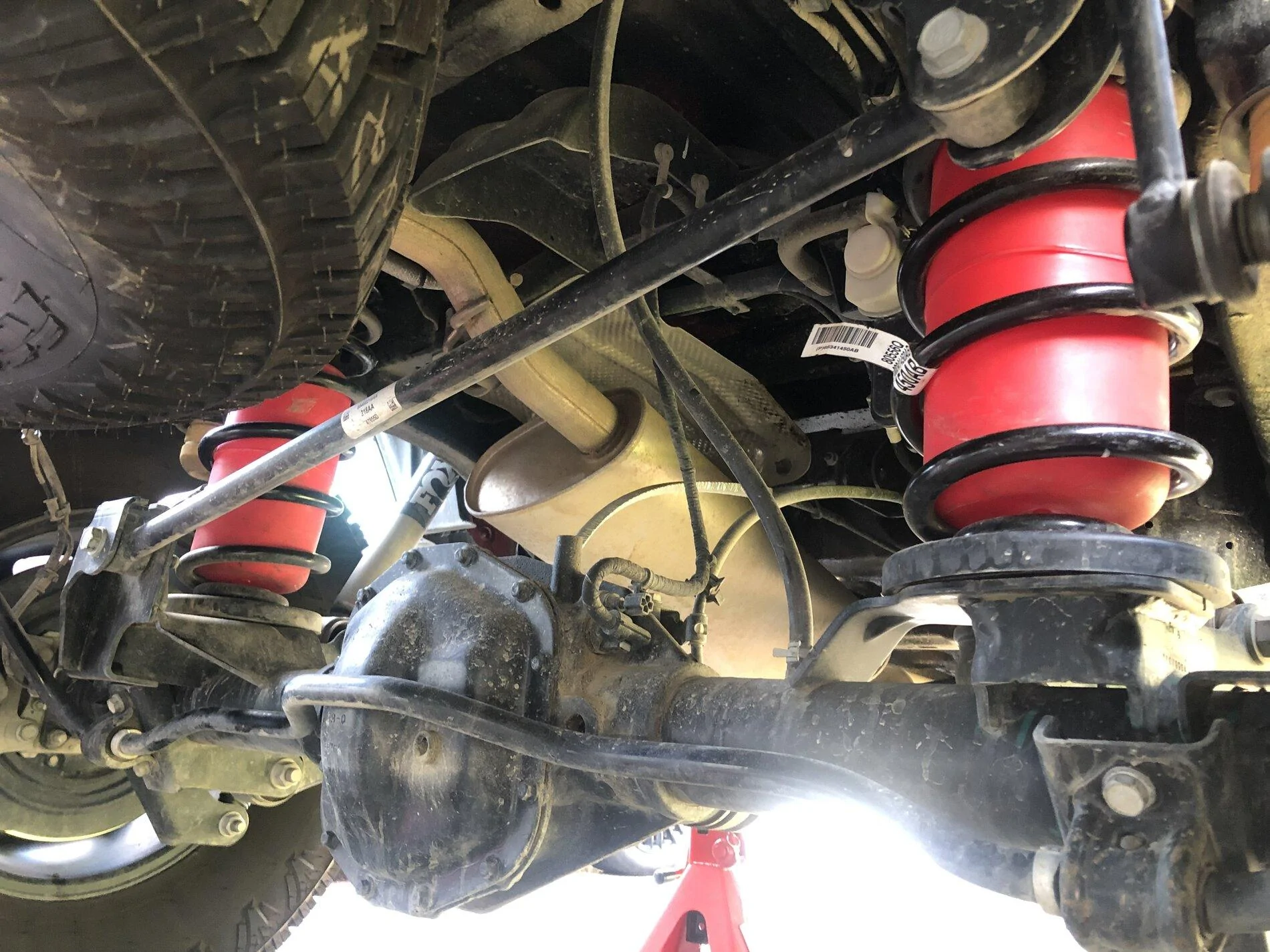

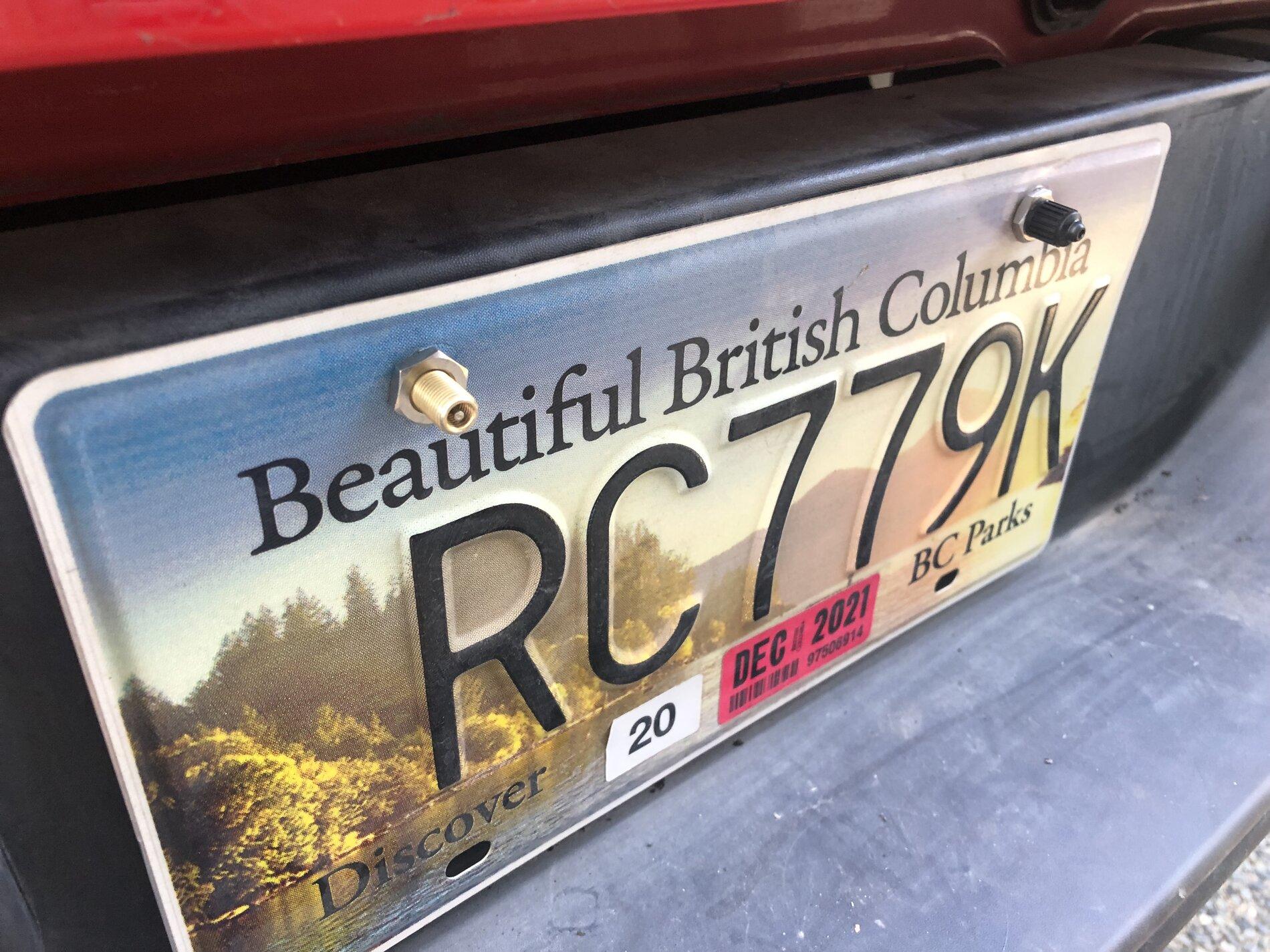

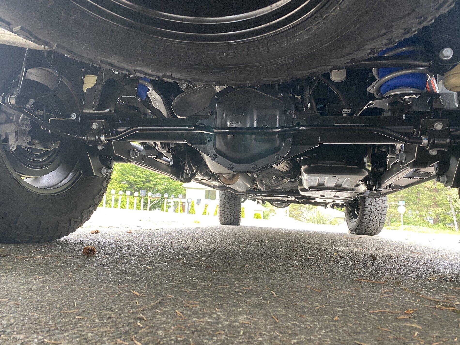

Install took about 1 1/2 hr start to finish.
Stock rubicon spring with 3/4 daystar puck.
squzeeing the bags in wasnt too bad. Worst part was clipping the nozzle on the rear driver side bag. Very limited space. Installed the valve on the license plate holders for a clean look.
The bags work as promise so far. Not towing anything ATM. Just holding up my RTT and camping gears weights for now.

Inventive placement of the fill points! Very cool

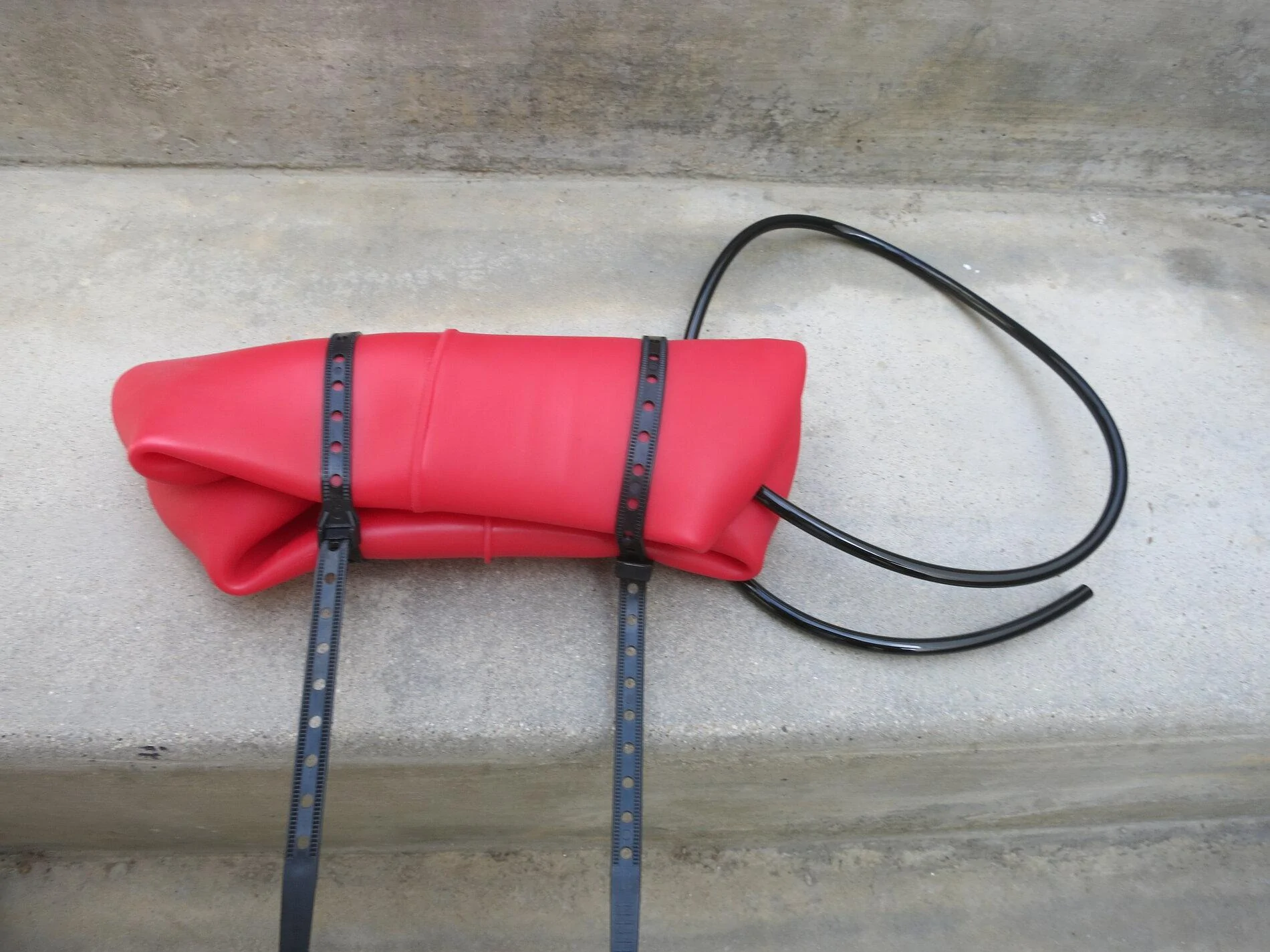

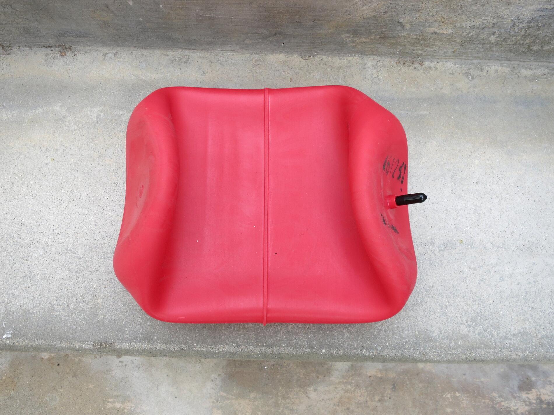

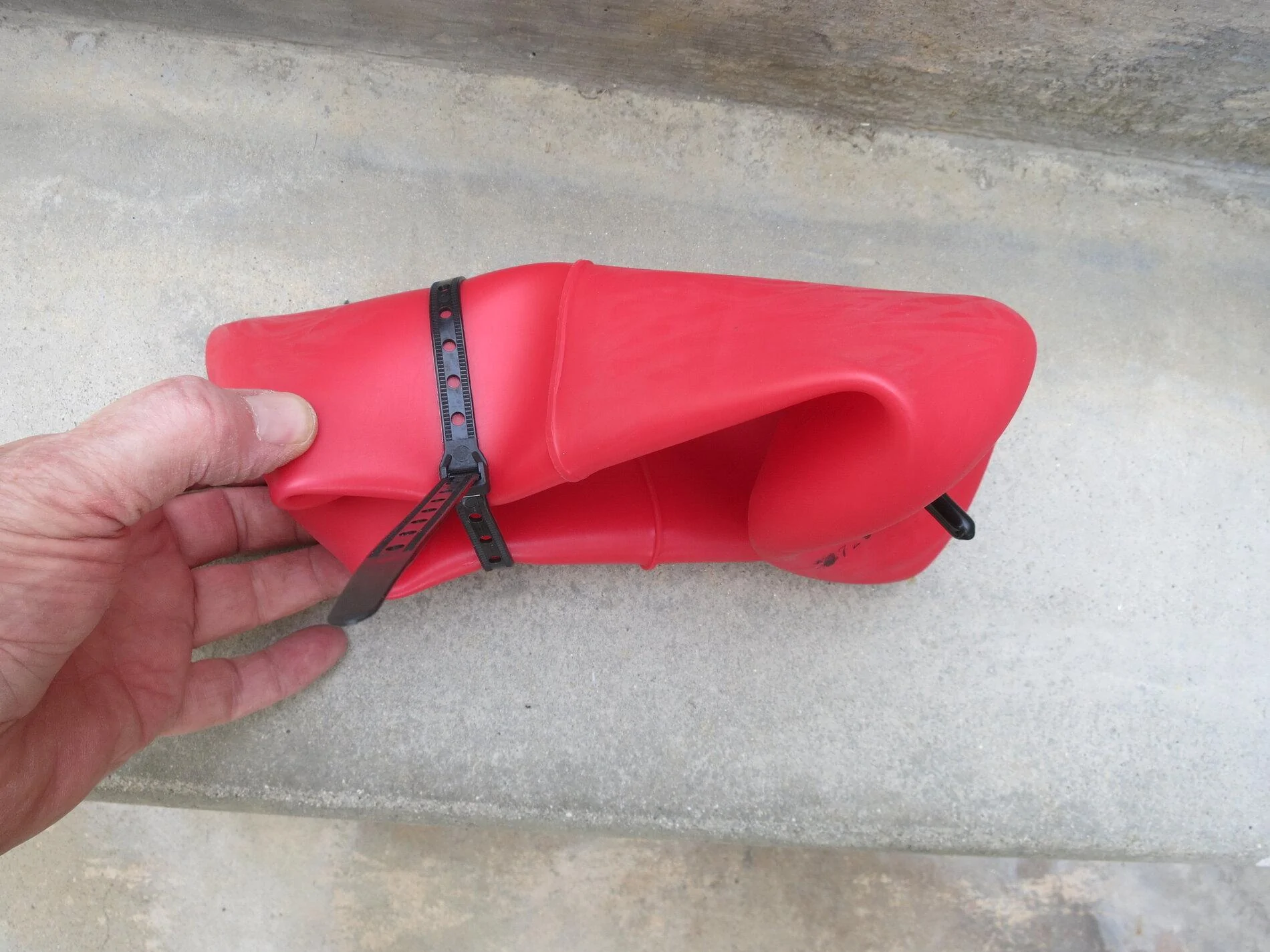

I got the Air Lift kit 60830 listed for the Gladiator and successfully installed in my Mojave this morning. Taking tips from others (thanks!) and pulling on my chin while under the truck for some time, I came up with a few more tips that might help others in the future.
Knowing the air bags must be deflated and folded in a way to fit through the spring openings and seeing a Ty-Rap used to hold the folded bag together I modified the procedure and the bags went in super easy with the air hose already prepped, avoiding trying to get tools inside the springs to attach the air lines.
There is a particular way to fold the bags by stepping in the middle and when deflated stepping on the top and bottom edges folding them inwards, then capping off the air barb so it won't inflate as in the picture below.
Then fold the bag over and attach a Ty-Rap around the lower section keeping the Ty-Rap lock mechanism near the open side of the bag. I found placing the bag on a step then putting my knee on the bag helped get the fold started.

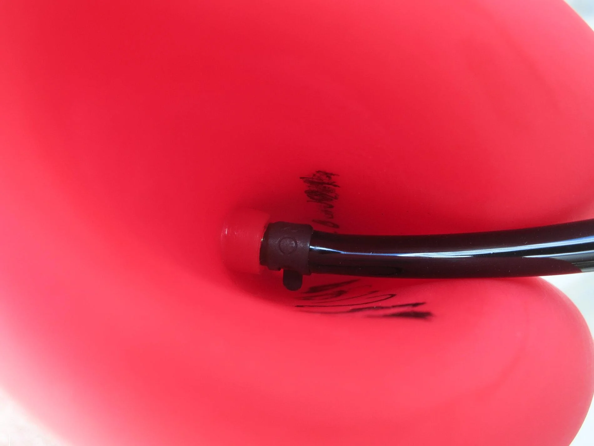

Then measure the length of air hose needed to reach the T or fill valve and attach that to the bag making sure the sharp edges of the hose clamp face towards the open fold in the bag and can't poke into the bag when its squeezed. This picture shows the sharp hose clamp ears safely resting between the open fold in the bag.

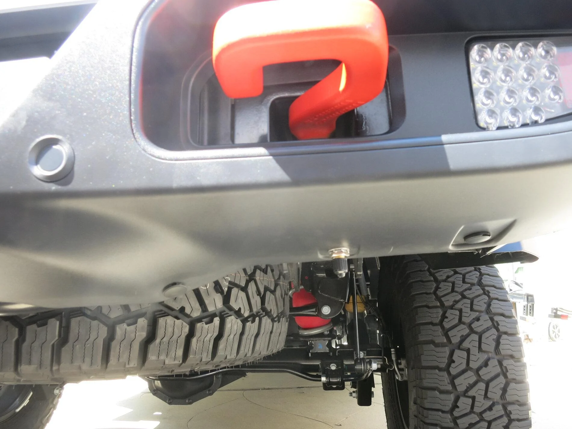

The rest of the install is normal stuff avoiding exhaust pipes and leaving some slack before Ty-raping down the air hose to the fill valve. I chose to put the fill valve in an existing hole that holds the plastic bumper trim on under the rear passenger tow hook as shown below. I pulled out the plastic rivet thing and enlarged the hole to accommodate the air valve. This location is recessed and should not snag anything for my type of off roading and you'll have to decide if its a good spot for you.
