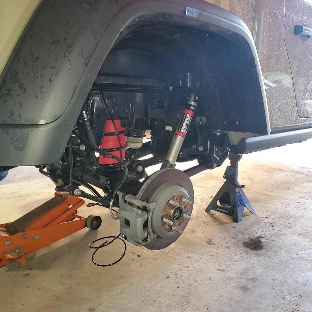

I installed airlift 60830 airbags on my Rubicon today. The spacer that came with the kit measured 1 3/8’.

I installed the same kit on my Sport S. My JT is lifted 3.5" which took the rake away and leveled it. Hauling 500 lb of corn squatted it pretty good. My problem was the spacers plugged the top hole the airlines were supposed to pass through. I called Airlift and ask what would happen if I installed upside down. They advised that wasn't a problem as long as I put the spacer on the bottom. Install was a breeze not following instructions. I never removed the springs. After installing I thought there's no way it will work once the springs flex. I have a nice ditch here and I crossed it six or seven times really flexing the suspension trying to tear them up. I didn't. As for my use they are holding up and doing the job.
