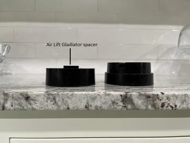

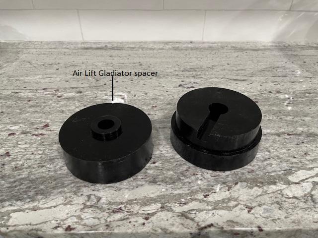

I'm a little concerned because when washing up my Daystar 3/4" spacers (for reinstallation on the rear, likely storing the front ones for now) I found that over the 2 years they were installed in my 2020, the springs had actually compressed the poly a bit and left impressions in the spacers and you could see and feel where the ends of the springs were on the spacers - and truck isolators.
If the springs can actually press into the poly spacers and isolators, I see the springs crushing the air lines if they go in like shown in the video and the pic below.
