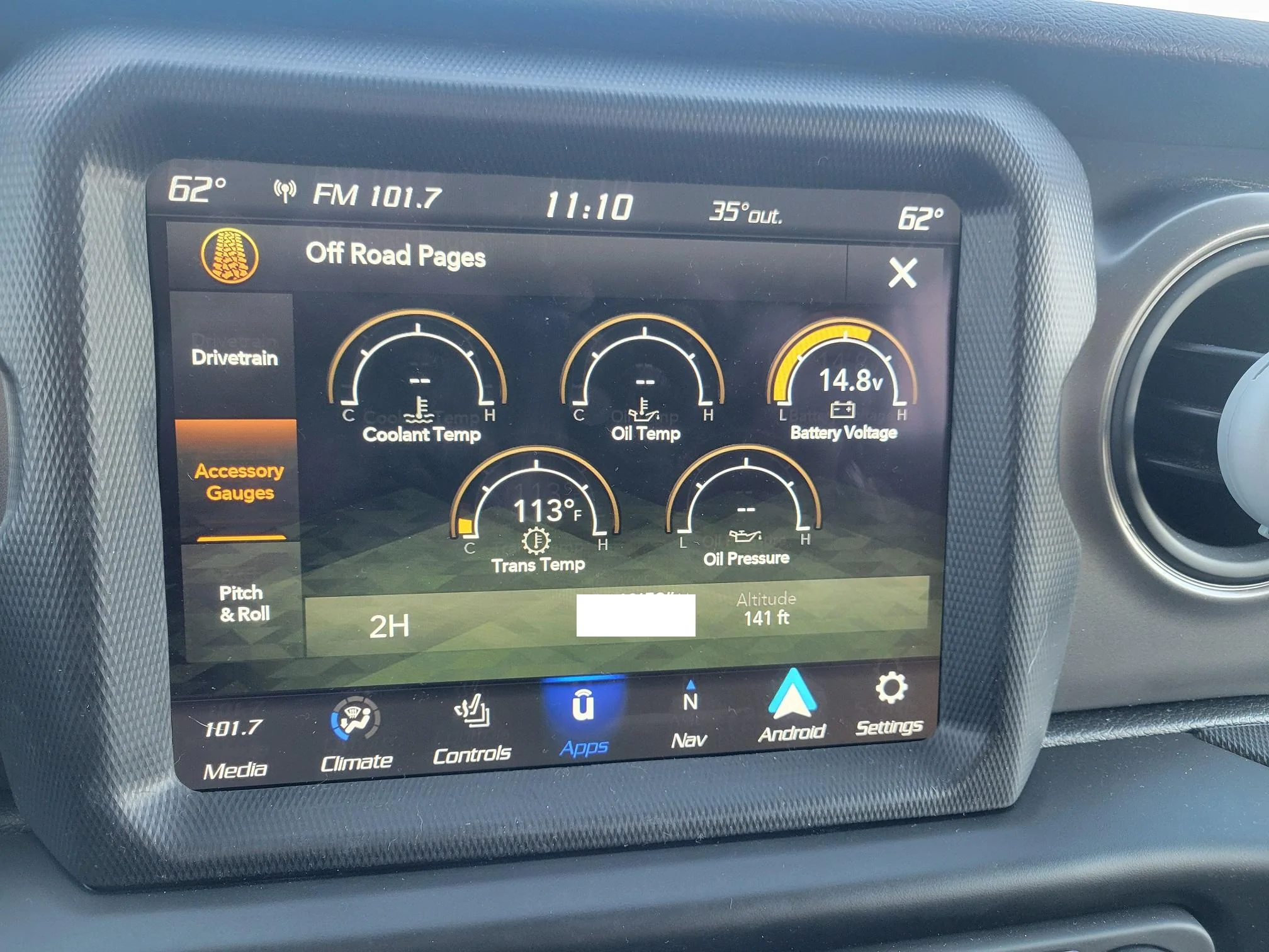

Probably it. I found some weird stuff on my 2021 Gladiator that has the new ECU. Installed a 8.4 radio out of a 2020 model in to my 2021 Gladiator and some of the engine gauges will not show up on the Off Road pages and I am thinking it is due to some software mismatching on the CAN BUS between the radio and the new ECU.
Off-road pages are weird anyway - if mine can't contact the mother ship, I don't even HAVE off road pages, they don't exist until it makes a call. It's likely to make sure I'm supposed to have it to begin with - I can get the cluster readings on the exact same stuff, but may drive a mile before ORP is even there.

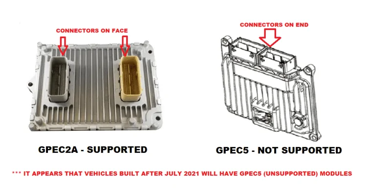

Found a pic on a tuners website showing the two. Connectors look similar and it seems doable for them to use the same engine harness save maybe taping the break out of the connectors off the main harness different. If so, I still find it odd that they would go back and forth between the two styles.
I do not feel like spending the money now, but the next time I have a Tech Authority subscription, will look up the IPC and wiring diagrams to see if they kept the same pin out and connector type.
Mine is definitely the GPEC2A.
