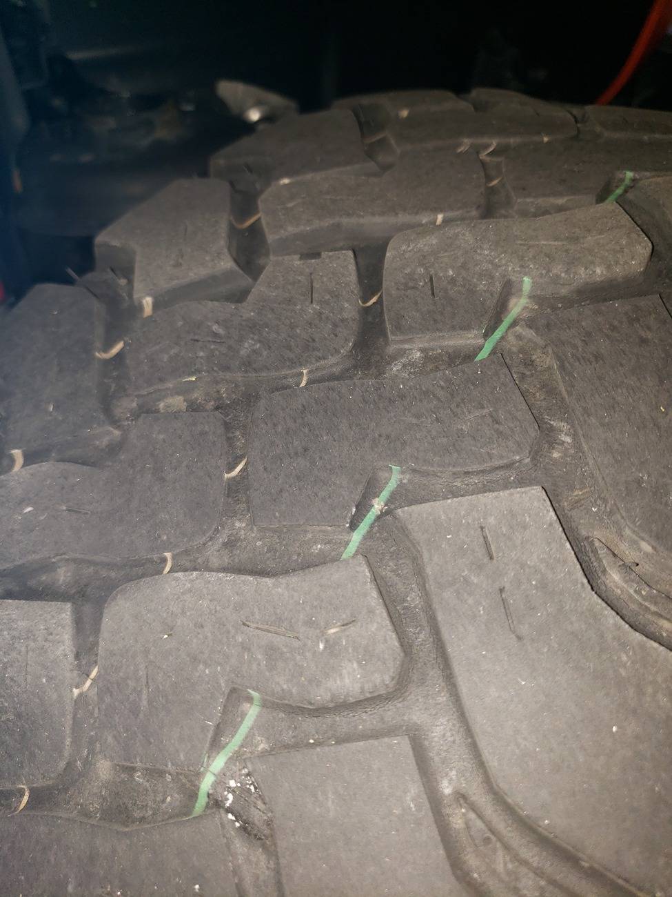

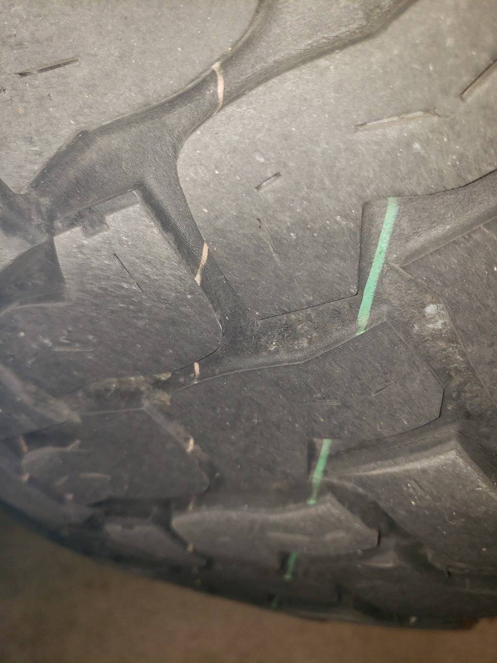

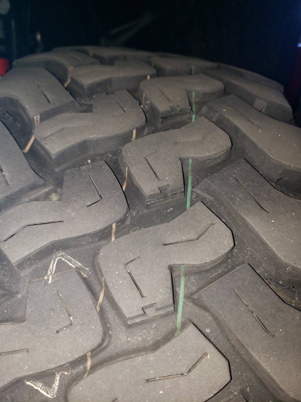

Looking it over with your insight I have attached a picture it's like lumps and bumps up and down along the tire last pic is another tire

So I figure the tire is probably out of balance as the others are fine and at the same cold pressure any thoughts as to buying a new one mounting the spare and new at the back and use an old one for a spare all the tires have 35k on them I do mostly highway driving your recommendations?
