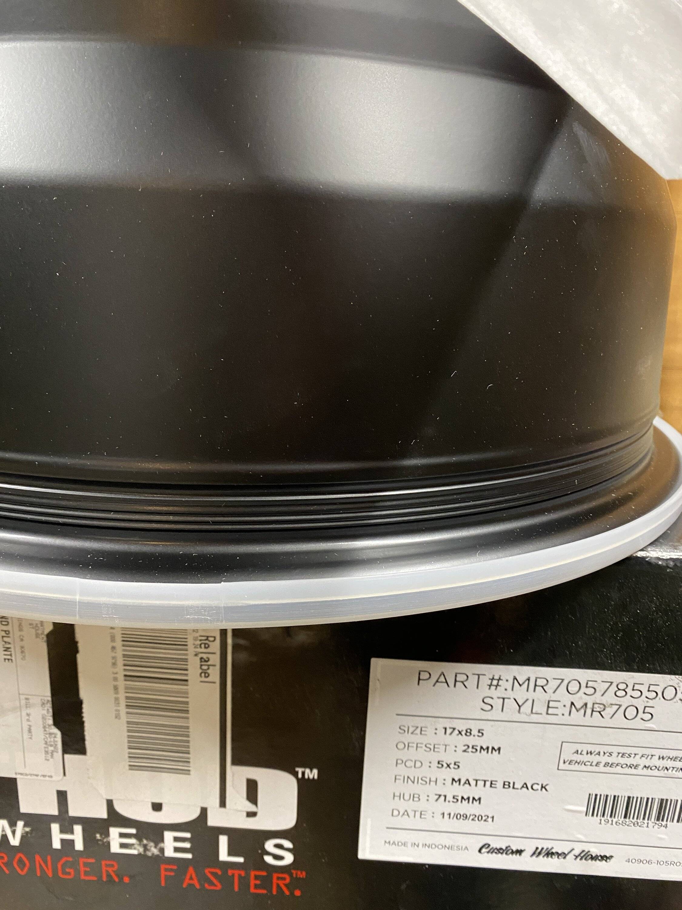

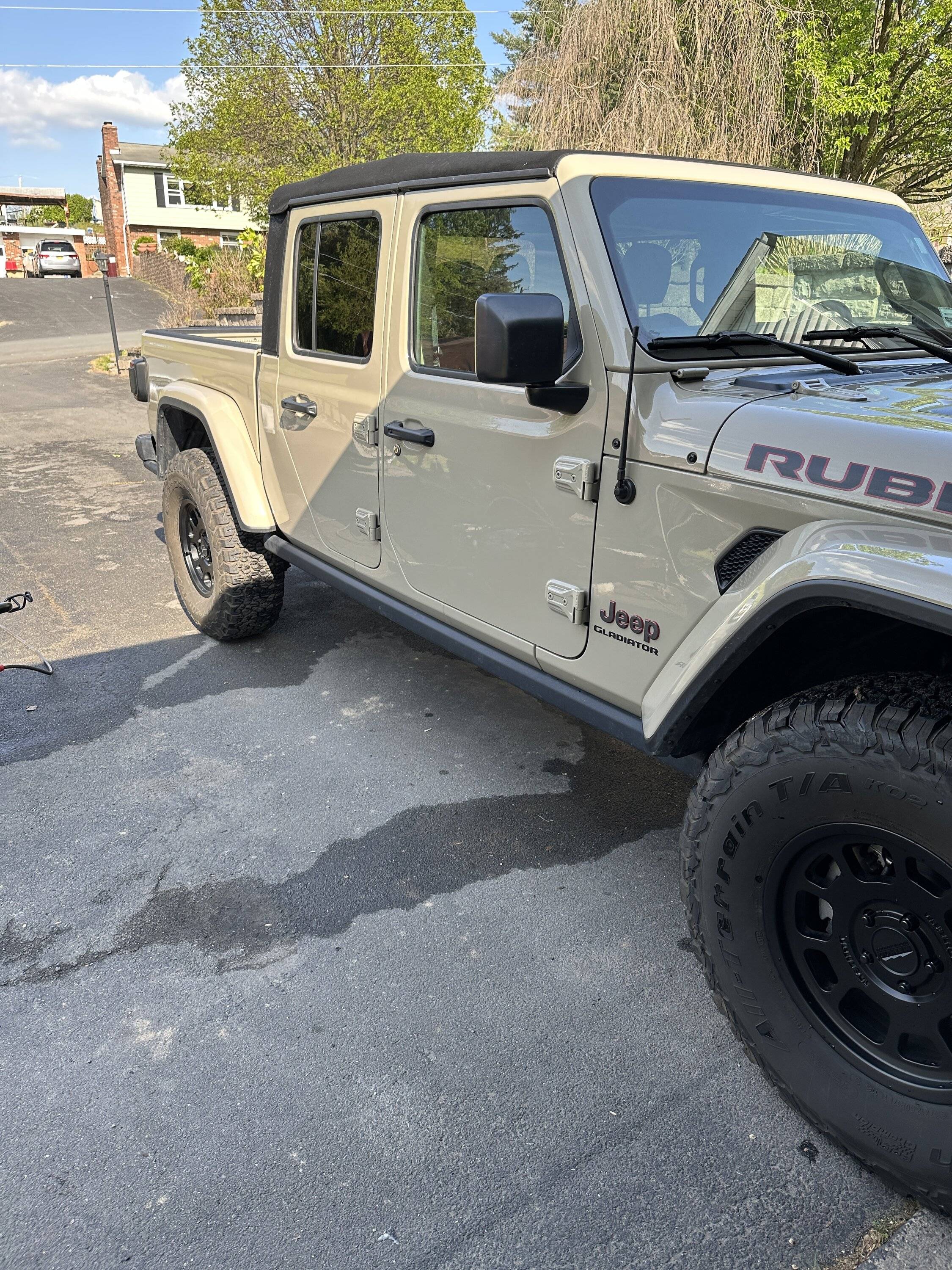

Havent had a chance to do an real time weight but method 705 +25mm BFG AT 37 C should only be a couple lbs heavier than oe rubicon rims with falcons, the adjusted speedo with a tazer did wonders. Nate from Dirt lifestyle on YouTube has run them down to single digit psi and kept the bead. I highly recommend them.

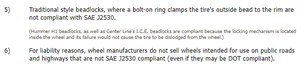

sharpsicle
Apr 29, 2021
2,772
6,271
Tampa, FL / Milwaukee, WI
Do you have an example of a state that references this?
If you can find something, these guys will donate $300 in your name:
https://www.liftlaws.com/are_beadlocks_street_legal.htm
"Safe operating condition" is all over the place in state laws. Not sure the suggestion otherwise?
Read that site again. They're saying the same thing I am. It's not expressly illegal, but since they aren't SAE J2530 compliant, they're covering interpretations of the law where SAE may be referenced for safety standards and could be applied to beadlocks. From that very site you linked:
Jeep Gladiator Bead lock or not? 1685565730851
Jeep Gladiator Bead lock or not? 1685565760869
Again, I never said they were straight-up illegal. Neither did these guys. But I (and LiftLaws) explained why they are sold and marketed for off-road use only, and the standard for safety that they do not meet, and how interpretations could have implications. Beadlocks are in a gray area.
