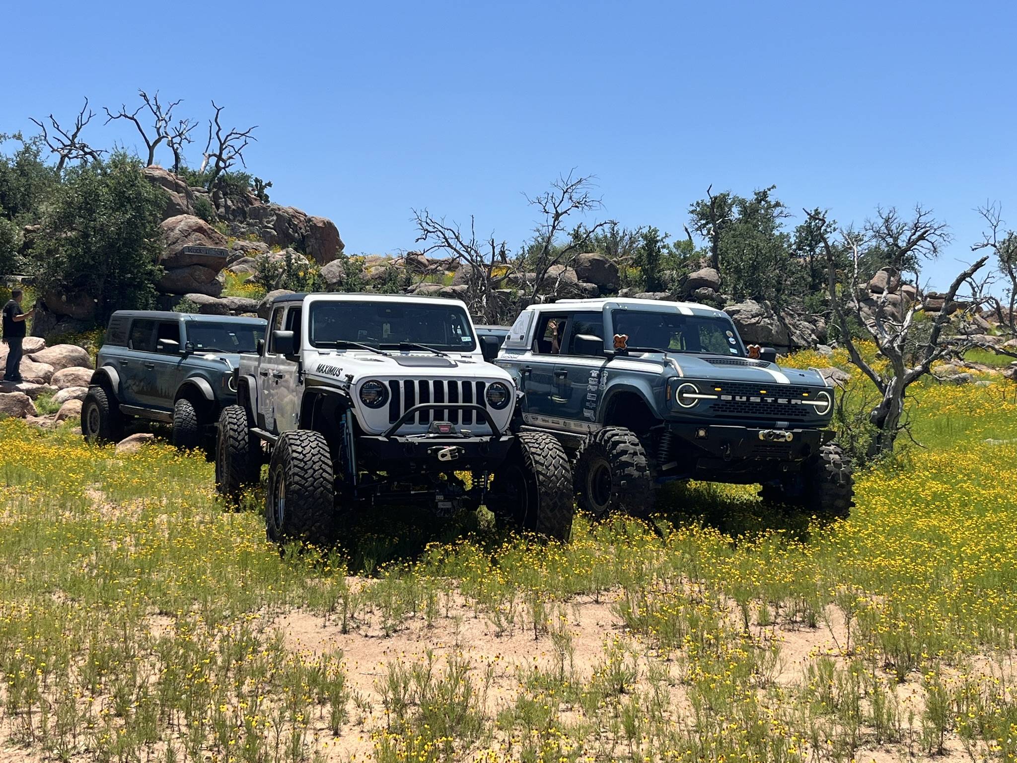

I went down to 8psi on my 42x13.5r20 along with the other vehicles I was with all went to 8psi and no one had any issues.

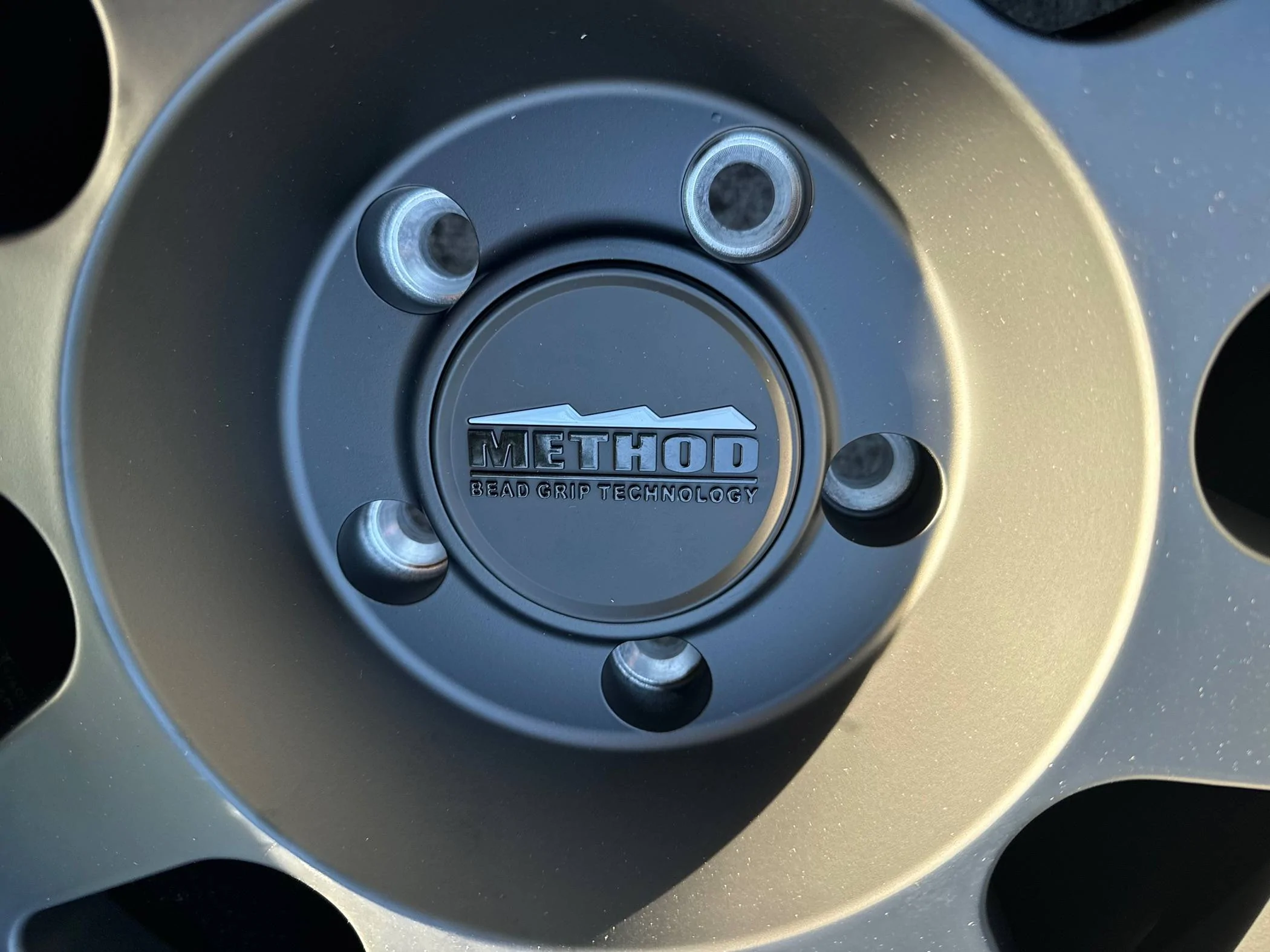

testing Method bead grip wheels at 0 psi
It was interesting to see how the lower psi performed in this case. The Method bead grip is definitely a game changer.
