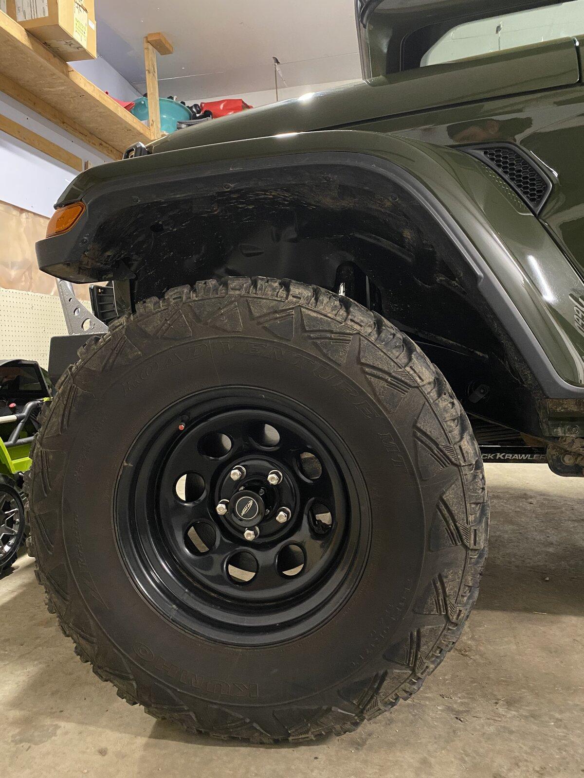

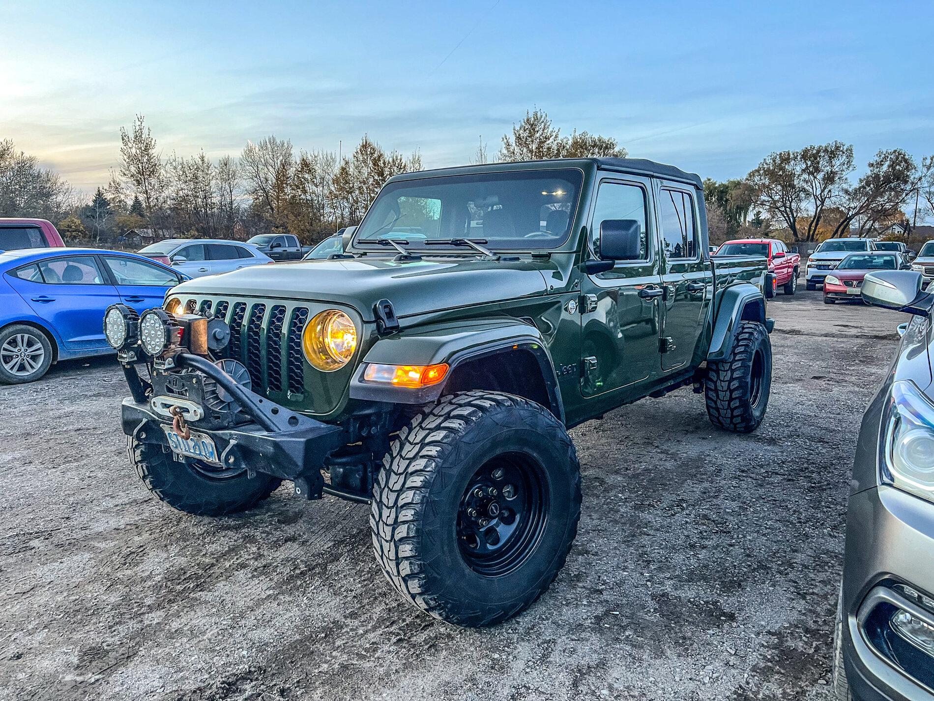

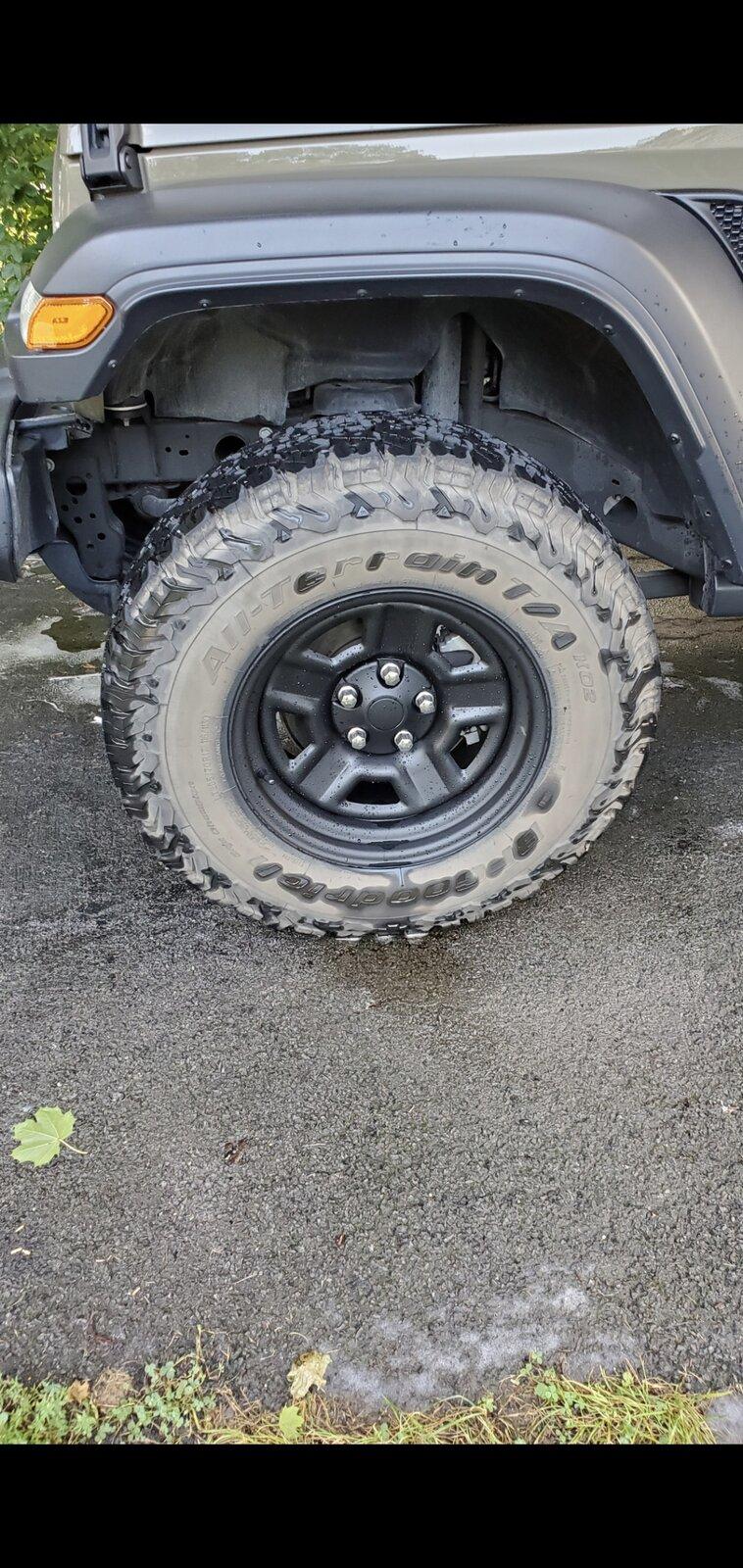

If I had an off road toy, I'd probably have steel wheels on it.
But for a daily driver in the northeast, they simply rust and look shabby within a couple of years.
Mine are on their 3rd winter now, don’t take any extra care of them and I’m in northern Ontario Canada
Wow. And you have the Chinese ones even.
I stand corrected.
