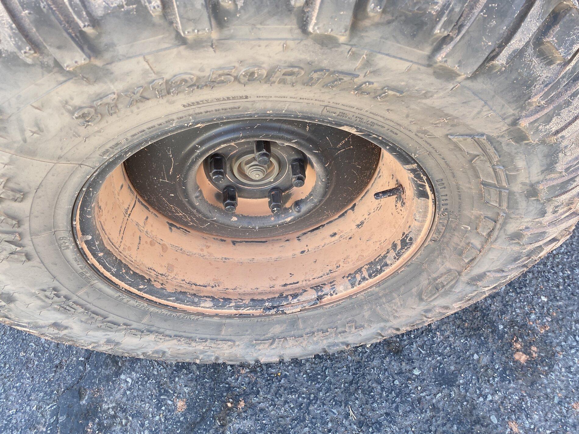

That's a misleading image. That type of damage is from someone wheeling on a flat tire for a few miles. An alloy would look just as bad if wheeled in rocks flat. Johnson Valley is rough no doubt, but it looks like some tried to hit every rock with their rim.
any one of those chunks would have deflated the tire.
Do tell us more. The pic doesn’t lie.

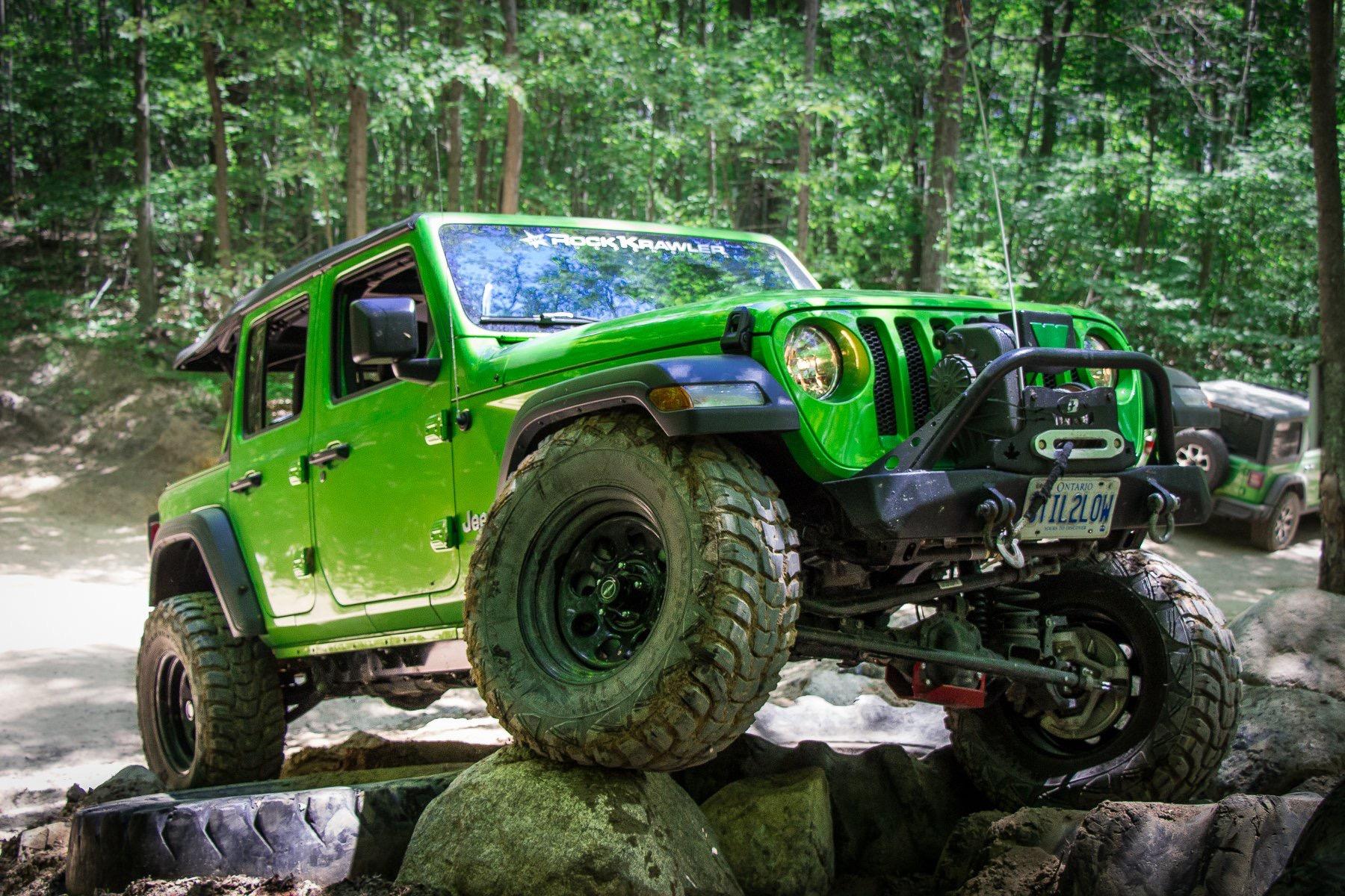

I run procomp series 97 steelies on mine, ran them on my JL as well
I’m dayshift today but can weigh the difference between them and one of my old JK’s alloy wheels that has the same 35 on it I’m running for comparison
I personally like the steel wheels, not a huge problem if I gouge them on rocks. Cheap to replace

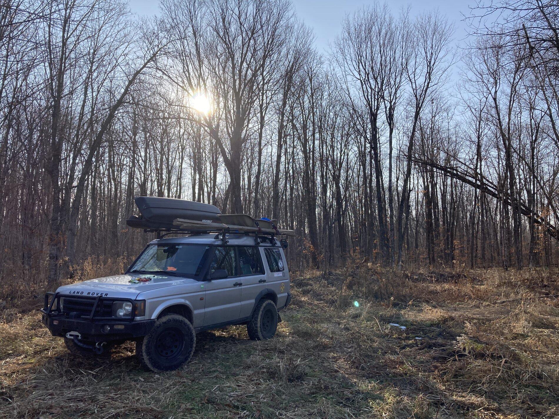

I respectfully disagree with your comment that hardcore off road people do not run steelies. Steel wheels are very tough and one of their main advantages is that when aired down if you really bang a rock and bend it, you can hammer it back into shape (trail repair - not perfectly round of course) and keep moving. Allow wheels are hard to crack for sure, but IF you do you are screwed. No trail repair. Steel wheels are the original overlanding wheel - think about landrovers and land cruisers in Australia and Africa 30 years ago.
In fact I'd go so far as to say that the genesis of the black wheel trend was cheap black steelies you see on so many old school overlanding rigs.
I ran steelies on my 2003 LR Discovery and they were cheap ($90ea in 2009) and easy to take care of. I rattle canned them every couple of years with rustoleum flat black. Never had an issue.

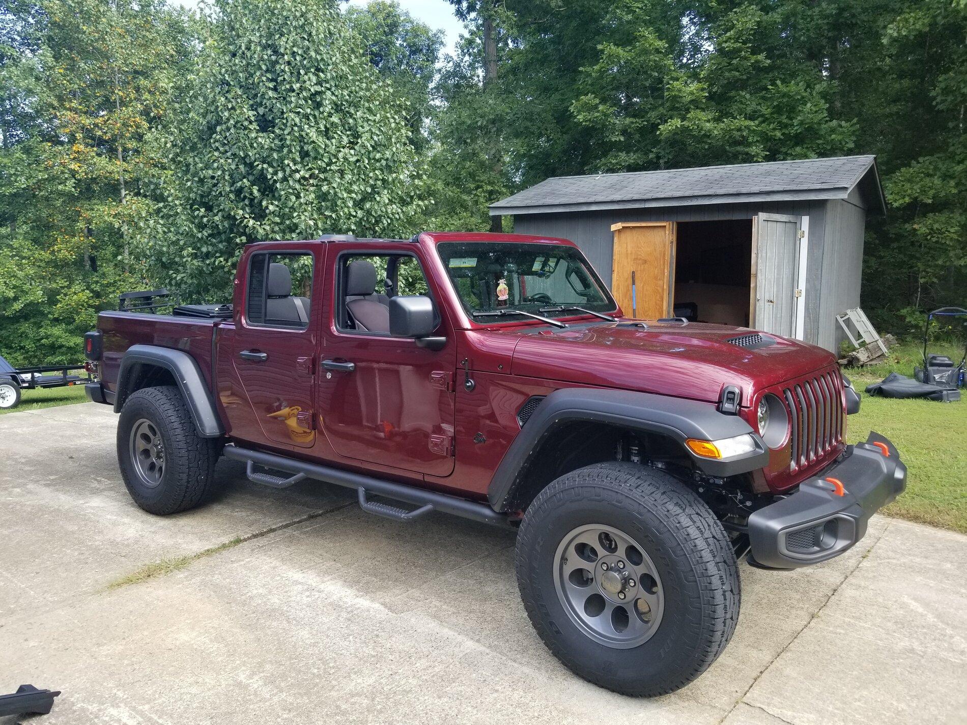

I have no complaints with the Quadratec wheels I'm running (they also come in black). I avoid steel due to the rusting./bending factors. Lots of gravel/rock roads trails here and I hate touching up wheels. Not sure what backspacing you're looking for , but these stick out a bit (4.75" backspace):
