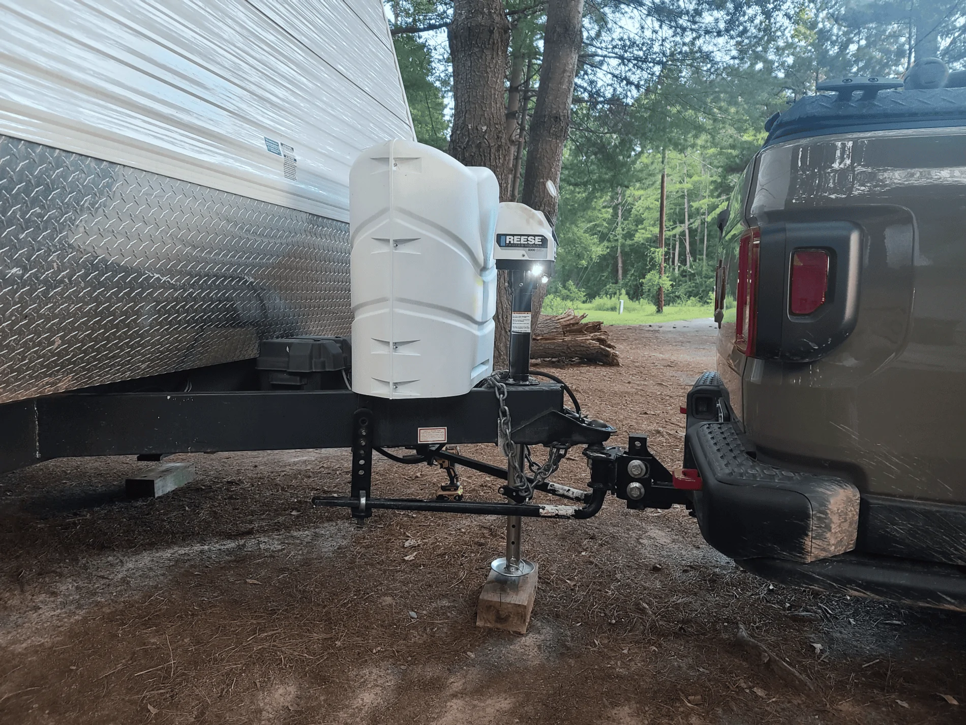

You hitch looks like an E2 fastway. Do you know what pound rating the bars are? You may have trouble getting enough weight distribution with that hitch and a trailer that big. I had an E2 hitch with 1000lb bars, and I just recently scrapped it in favor of a blue ox sway pro with 1500 lb bars. I was never a fan of my E2. The setup is a pain in the rear, like you are finding out. Also the noise drove me nuts. I like the Blue Ox a lot better. No noise, and setup is dead simple. If you need more weight distribution you just take up another chain length.

Thanks for the help on this everybody. Between the manual and the guidance here I think I got it dialed in just right. It really is just a game of trial and error.

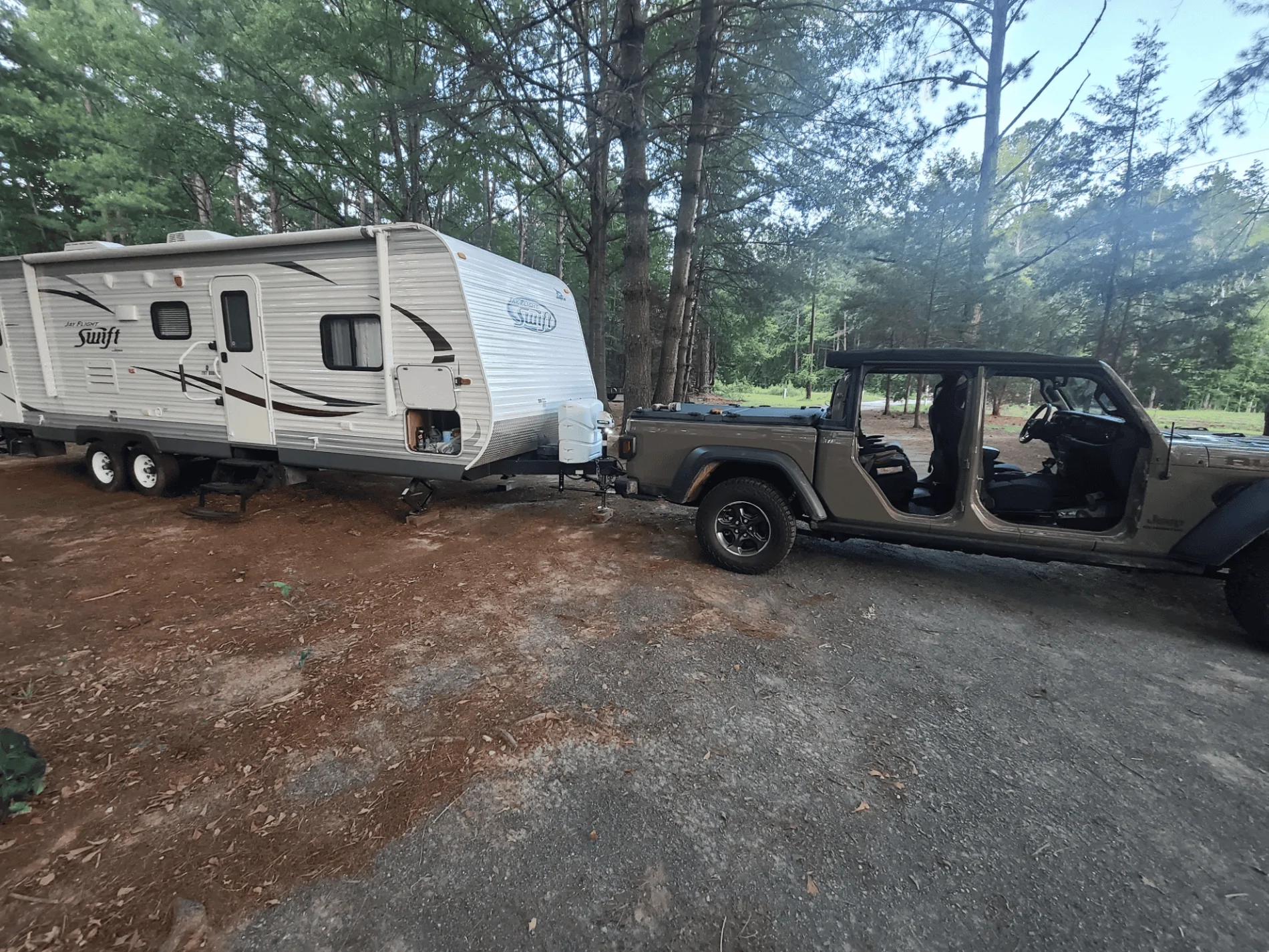

My measurements from top of the tire to a spot I marked on the fender right where the first crease is where the upper and lower meet. stock AT tires.
before with no load
Rear 10.2in
Front 10in
With adjusted WDH load
Rear 9.2in
Front 10.2in

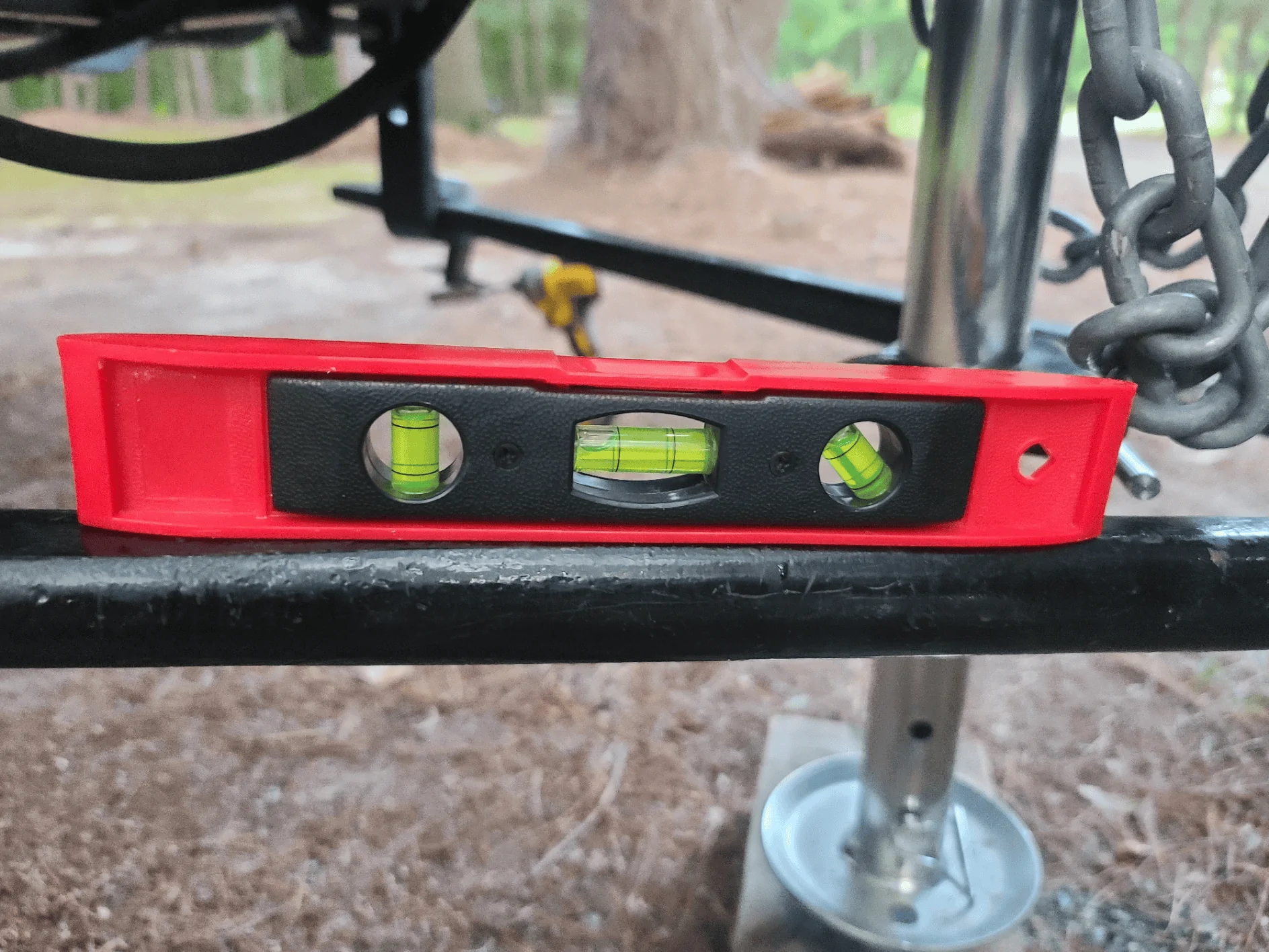

It looks like based on everything these measurements are near perfect based on everything here. Rake is gone, I actually put a level on the bed of the truck and it was just about perfectly level. Tongue of the trailer was level with a slight upward grade towards the back.
Would I be correct in assuming I am at just about best case senario here? I left the spacer washers at the default of like 5 or 6.
