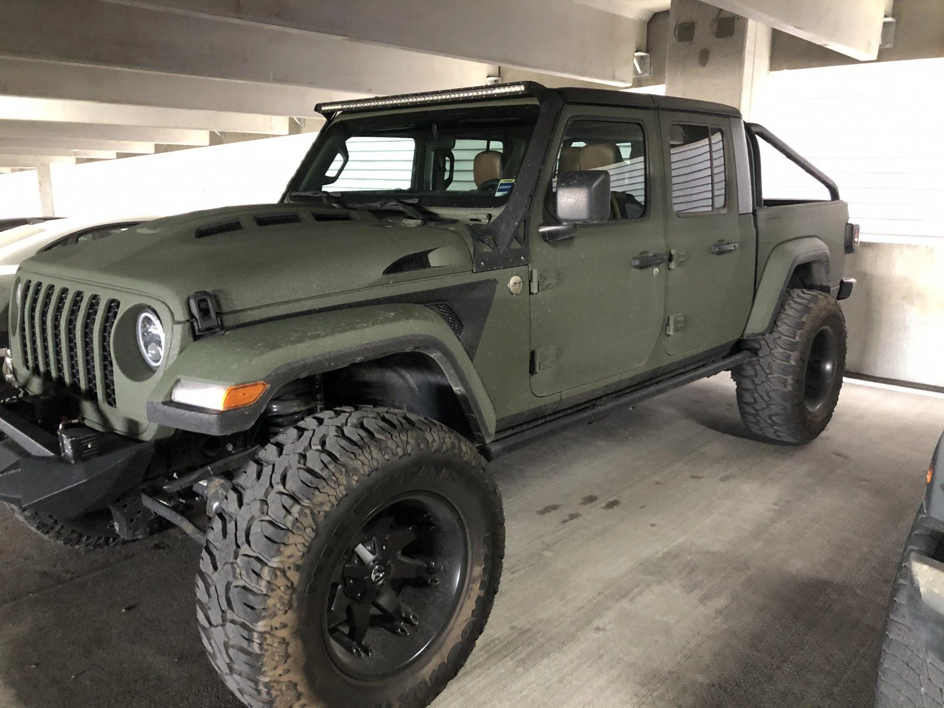

Had these installed by Jeep dealer in SoFlo, but after I took the doors off and reconnected them, they won’t release when opening the passenger side doors. SoFlo Jeeps is a terrible company and is unwilling to help, only one of many issues for a $65k Jeep...

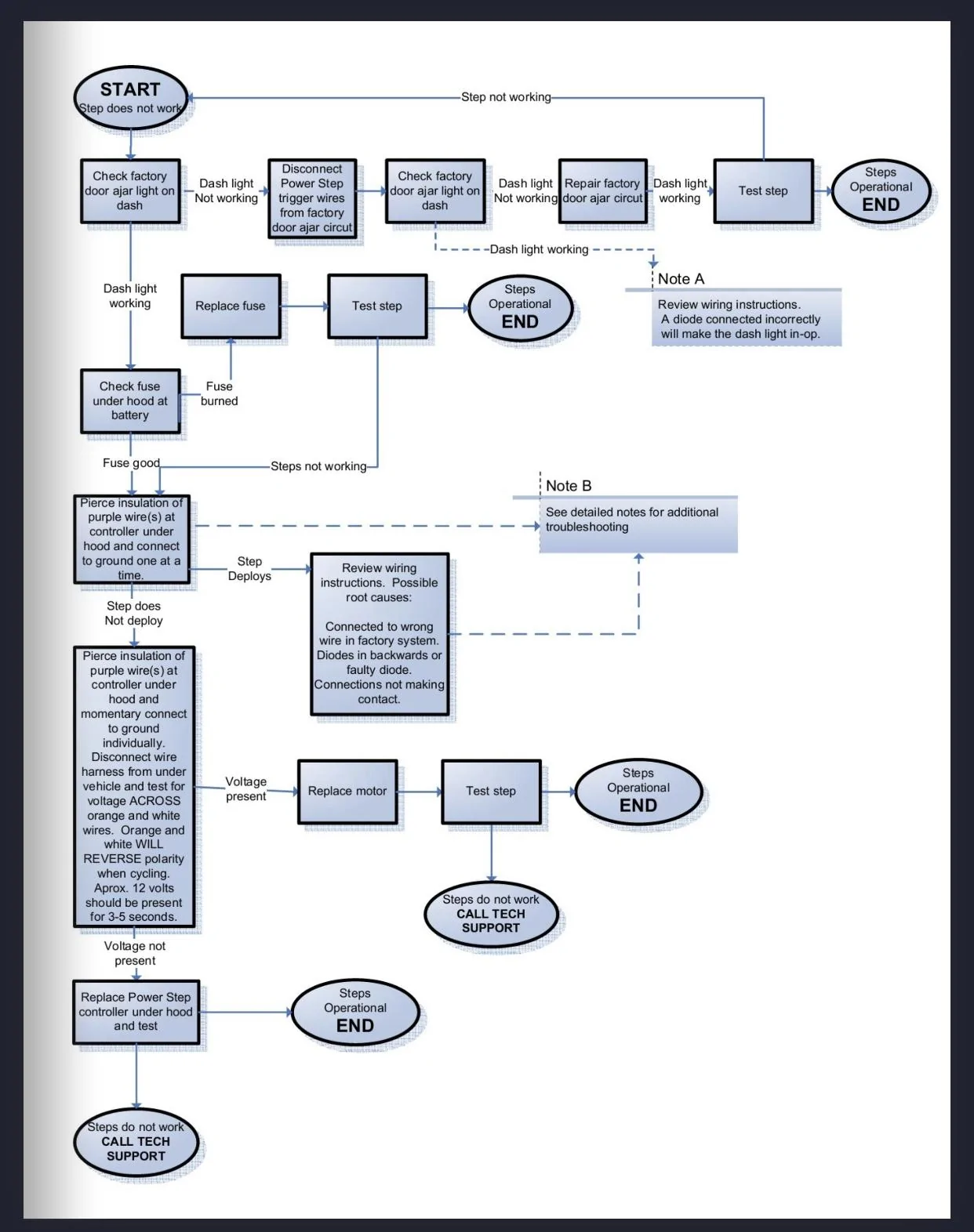

I found some information on what to do... picture attached
Rear door turns on “door ajar light” on dash. Front door does not.
Next step is to check “door ajar circuit” but I don’t know exactly what that is.
I was able to follow wires and nothing looks out of line... still no door ajar light and it doesn’t not release on passenger side.

One of the plugs on the passenger side isn’t seated properly. Double check both the front and rear passenger side plugs. Carefully pull them back apart and look for bent or misshapen pins. Generally a problem occurs the last place we touched.

Thanks, I’ve plugged and unplugged a few times. Checked the pins but couldn’t really tell. I’ll check again! Thanks again,
