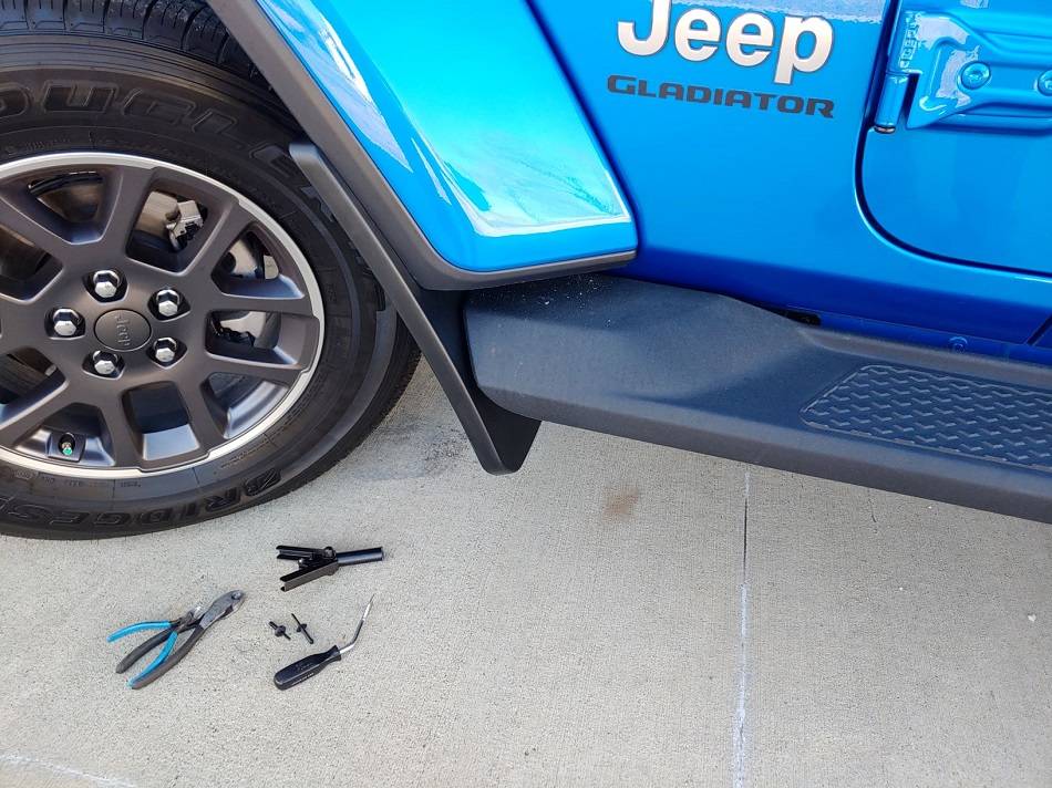

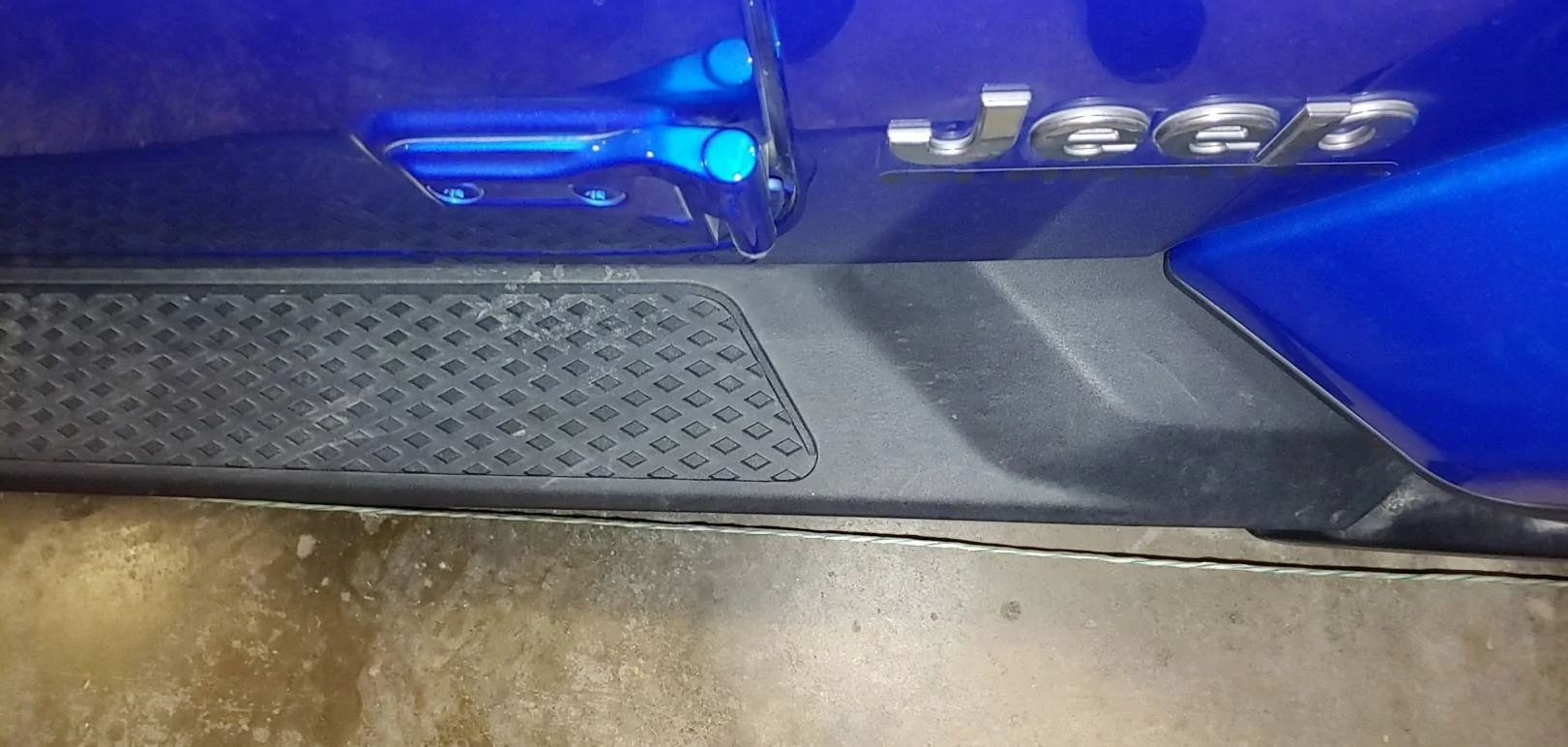

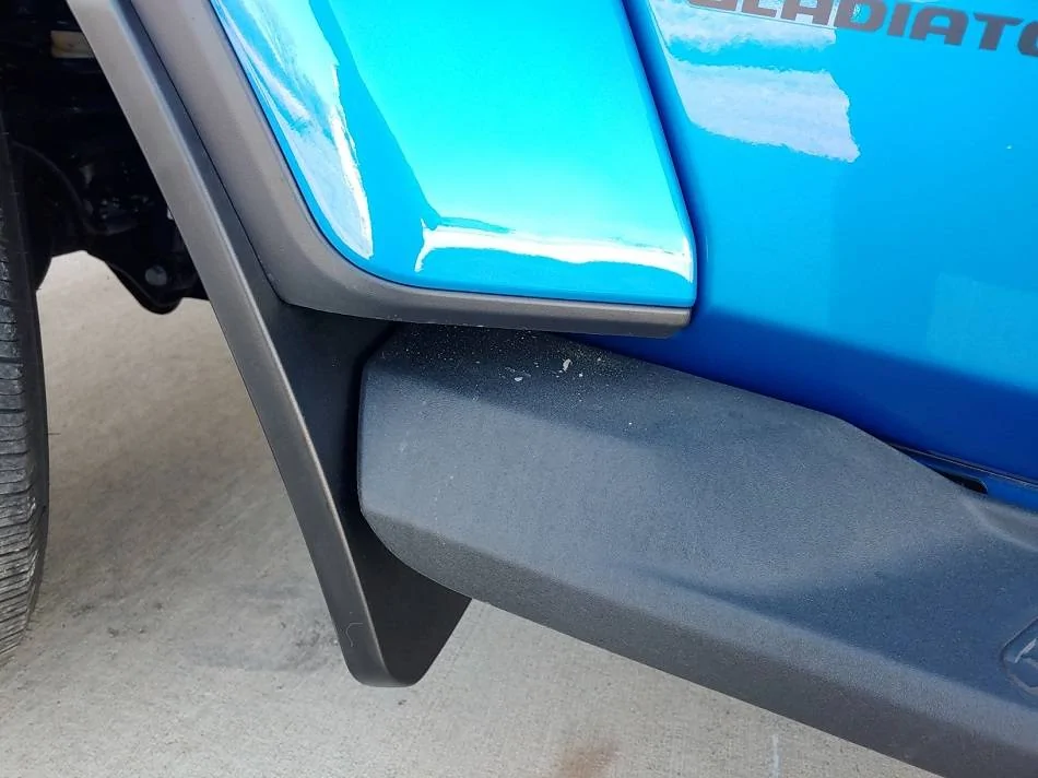

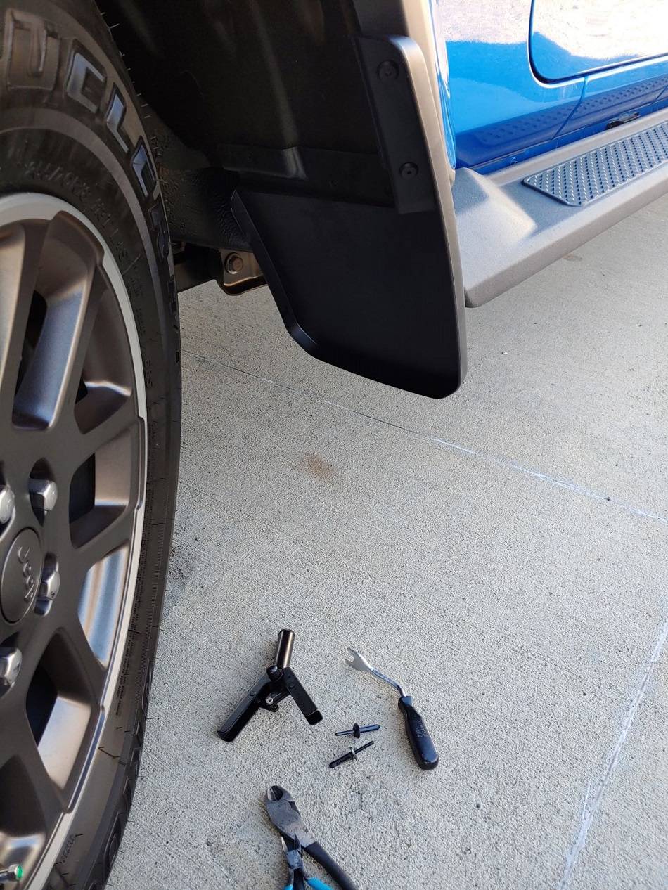

Now I'm really curious - how far out do the RSE devices stick out from the body - the same as Overland running boards? Any measurement to compare to these?
Basically, the MOPAR splash guards are even with the fender flare, and the running boards are even with the splash guards ->

I’ll measure them for you tomorrow, and will take some close up pics of where they meet the fenders.

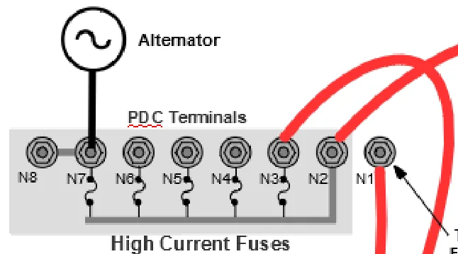

I will be trying to NOT run directly to the battery. I'll try first to run up to the spare terminal on the high current fuse array.
On the 4xe, terminals 3 and 4 are "spare" and unused
On the Gladiator, terminal 8 should be full power, and is unused or take it to N2 which runs right to the main battery. I don't want yet another connection on top
Both are connected to the main battery. I don't want yet another connection run to the top of the main battery - already have my plow/winch power going to + and 2 big ground cables going to the - side.
Going to N2 or N8 would mean it would actually be hidden (and no dealer would open the hood and say "there's your electrical problem" because they'd not even SEE it.
The instructions say NOT to run the ground up to the main battery because the harness isn't long enough - they say run to a body ground.
That means I need to lift my terminal strips up out of the way to access the body ground since those studs are all now under my terminals and plow fuse, etc. - can't get to them!
OR, run a much larger wire from the body ground up to my terminal strip ground screws and use that.........

I've read and read the PDF directions preparing for a now delayed delivery............
And I've been all over under and around my Jeep - I've run a heck of a lot of wire and cable in this thing for the snow plow, backup lights and 12v power to the bed, all taking a path similar to what the RSE instructions indicate but for the life of me - what the he## is this picture supposed to be?
I've even gotten into things to put pigtail connections in the fender lights to trigger my plow lights, the wires from the aux switches run back and down along/in the right frame rail, all going down like RSE wants theirs and I still don't recognize this picture! Were they under it standing on their head or something?
That’s the end of the harness. That’s the wire that goes to the driver foot well for the power cut off switch.
Please take a look again - that's their text and their red arrow, not mine. The paragraph on both the JL and JT instructions show that picture - and say to run the cable to the battery, and point to it.....
Run red wire with fuse holder from rear passenger door (right side) .... next to the lower battery area:

And their red arrow points to this -
Jeep Gladiator Power running boards 1677860090763
Doesn't look like driver side footwell or the wires to the switch, IMO.
They show the same thing in their video -
Jeep Gladiator Power running boards 1677860177234
But they must have a fender off or something and they whiz through every step so danged fast you can't tell what's going on - like wait a minute - where exactly is that? Did they remove the fender liner or fender? Where'd they get that shot?
It's definitely not the driver side footwell, but don't recognize those parts either.
