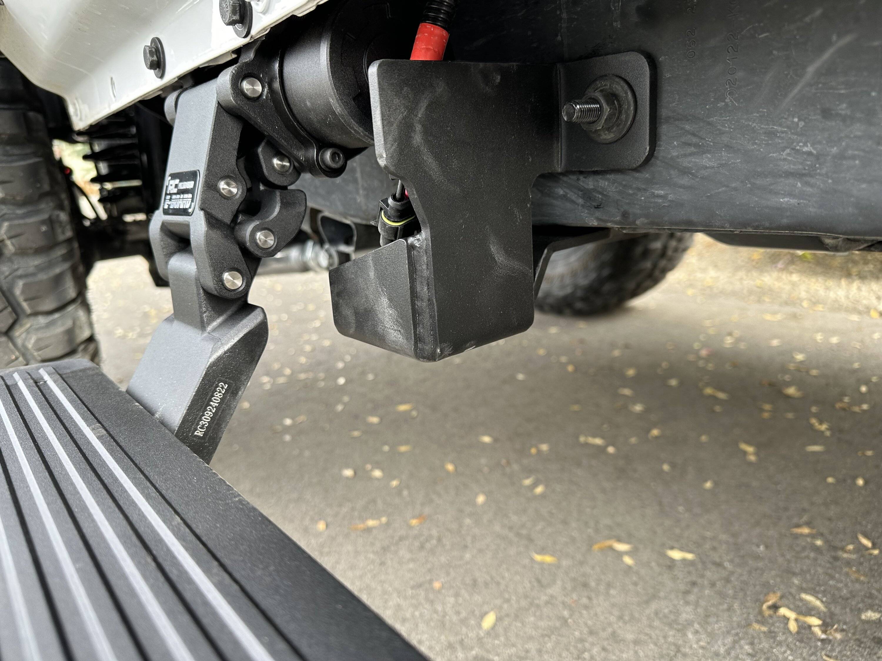

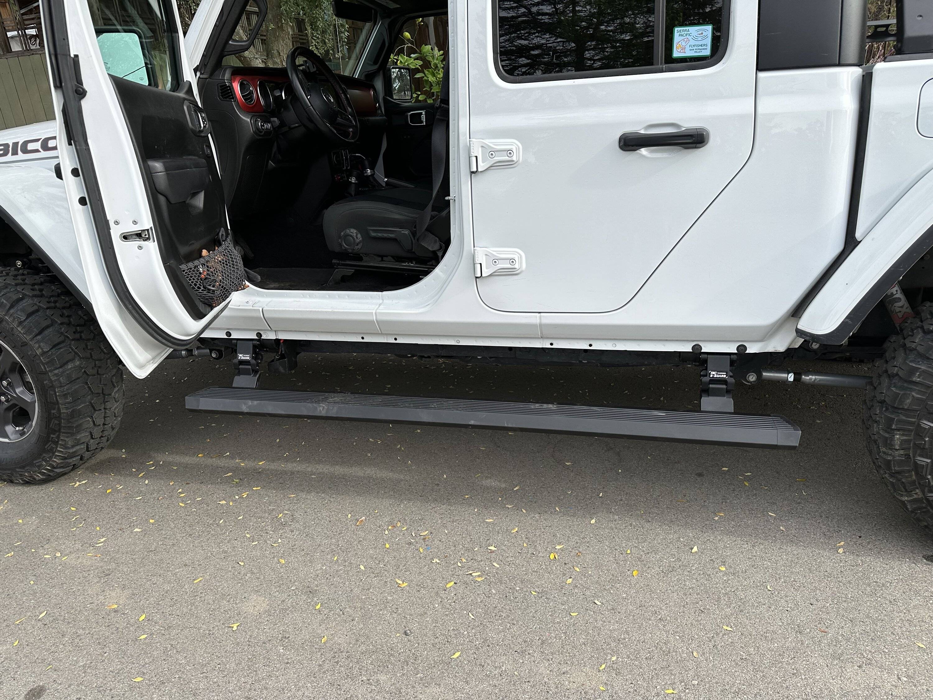

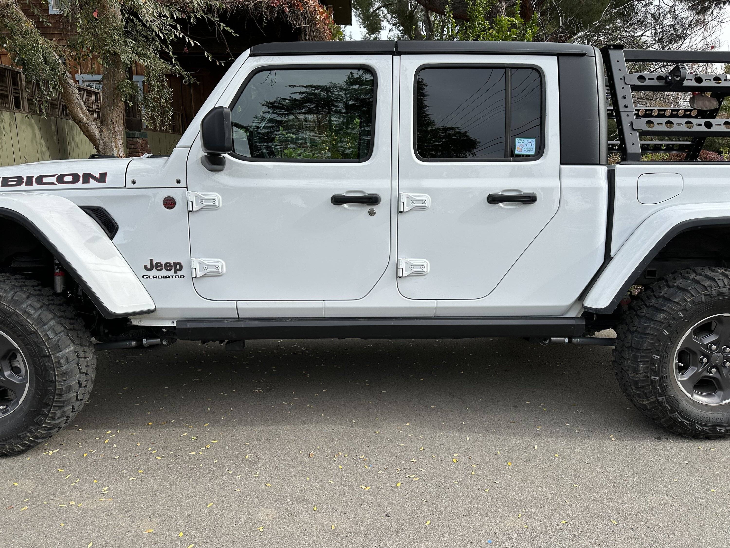

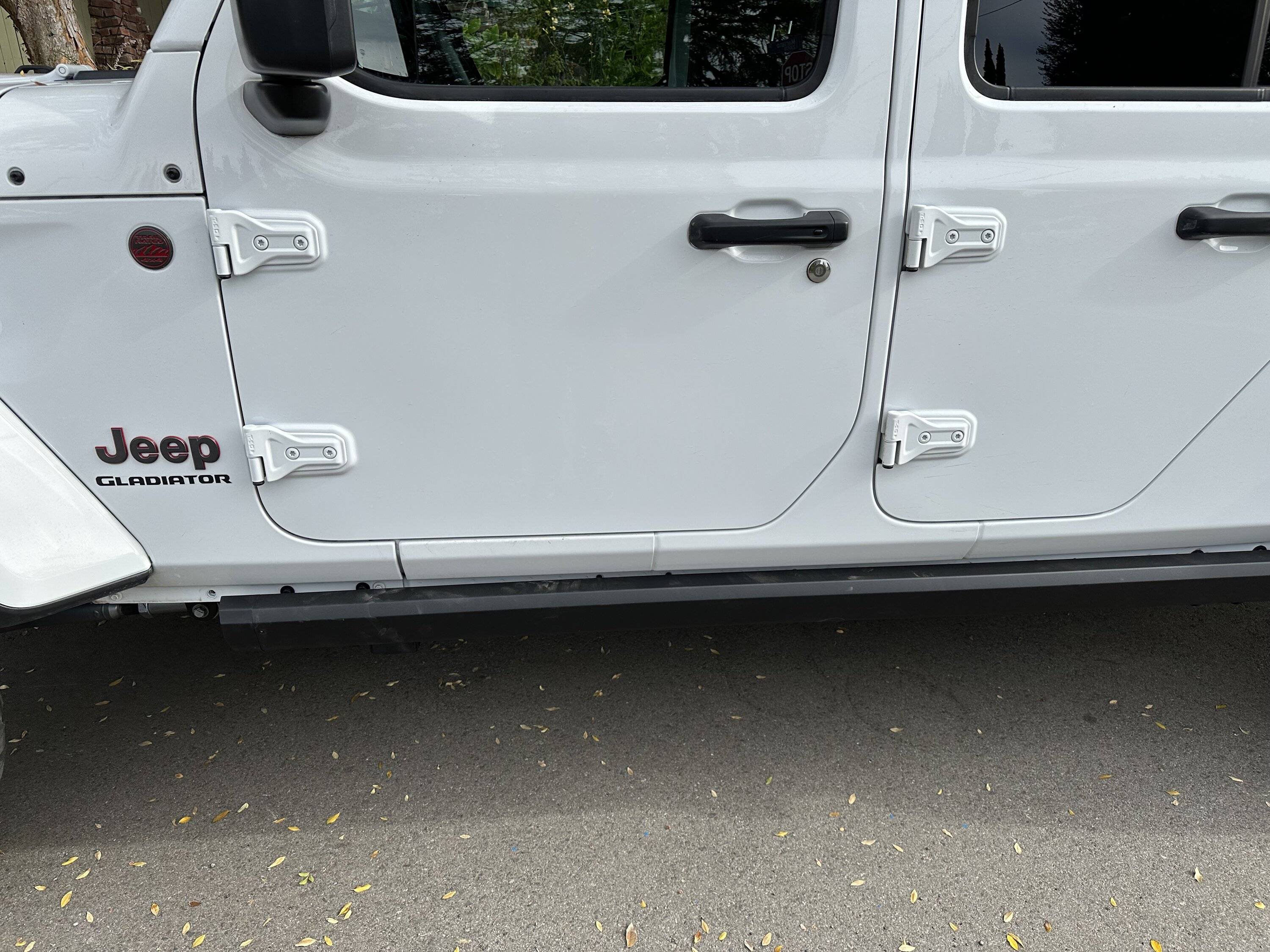

Took me about 8 hours if you include reading the instructions and looking up Youtube videos. I did it in two 4 hour days. I removed the stock ruby sliders (they are forsale BTW) and installed the motors and steps on the first day. At that point you can drive around with them if you need a break or can’t do it all in one day. The second day I did the electrical part. Wiring everything outside then inside. Installing the LED lights the magnet door sensors and then finally the battery wiring. Very straightforward and self explanatory. For the money (on sale for $999 right now) it is totally worth the $ and in my opinion well worth the savings of $1500! ($2000 plus $500 install for the Amp Research.). I would give them an 8.5 out of ten.
Things I’m not excited about but willing to live with to save the $1500 it would have cost the other way.
1.)they are narrower than the AR’s by probably 2” or what feels like 2”….
2.)they are not long enough to cover the full pinch weld that they (mostly cover) and should cover fully IMO. Why not make the extrusions another 10”? It’s probably a few dollars difference.
That’s it, other than that I think they are well worth the $ and seem very strong and stable. I’m happy. And most importantly my wife is happy. And that’s really all that counts isn’t it?

Is there a way to adjust these running boards horizontally so there isn't as much gap showing the pinch weld towards the front? I'm thinking about these as well.
Yes they have two allen screws to easily adjust horizontally
New to the forum, Just installed these and I am having the same issue. My drivers board closes too far and hits the underneath when closed. What allen bolts do I adjust to open the gap? Thanks
