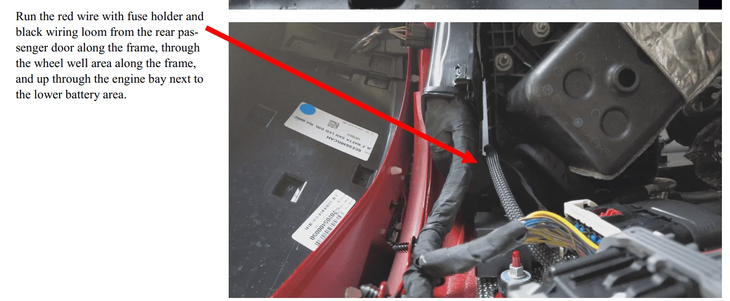

I've read and read the PDF directions preparing for a now delayed delivery............
And I've been all over under and around my Jeep - I've run a heck of a lot of wire and cable in this thing for the snow plow, backup lights and 12v power to the bed, all taking a path similar to what the RSE instructions indicate but for the life of me - what the he## is this picture supposed to be?
I've even gotten into things to put pigtail connections in the fender lights to trigger my plow lights, the wires from the aux switches run back and down along/in the right frame rail, all going down like RSE wants theirs and I still don't recognize this picture! Were they under it standing on their head or something?
That is the bottom of the aux battery box. The connectors in the bottom right of the picture are on the firewall.
I think that picture was taken with the passenger wheel and fender liner removed
40,493
54,049
I wondered, as there's no way to get a photo like that without the fender liner, maybe more, being removed. Thanks for confirming.
Of course the Wrangler 4xe has no aux battery, but there's sure a lot of other stuff in the way in there. A lot of stuff to get the cable around and past up to the PDC area.

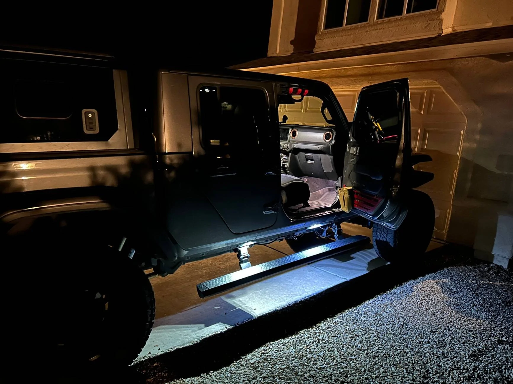

Contacted RSE support today. I told them of my testing of the motor with a battery, etc. and other things I'd done to troubleshoot.
They agreed, probably the control module on that side.
I asked if it was the same as the right side of the JT set since I had a set laying there for my JT.
Yup.
When I saw how it was made, and how it was just easier to swap the whole motor and module assembly, they approved making the swap - motor with module assembly.
I prepped everything, disconnected cables, unbolted everything, Jerry came by and helped get the step off the Wrangler, and the switch was made, step was put back on and tested and all is fine.
So the whole system is now working.
Pic taken with garage lights off, sun setting, to see if the lights worked - yup, they work.

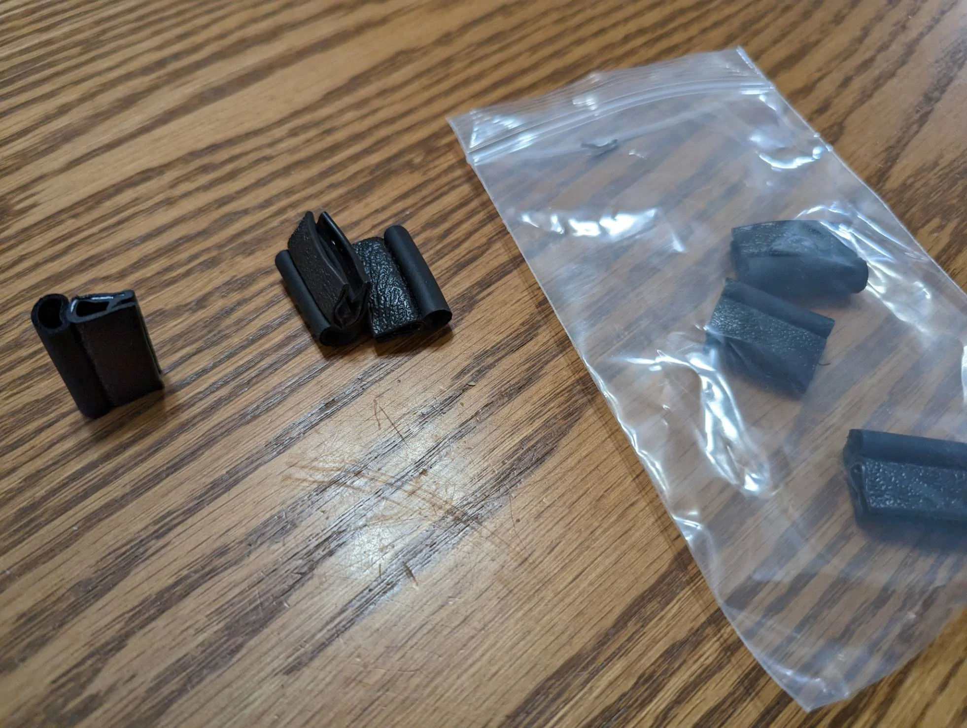

I contacted their support saying my wife and I both really like the steps, a lot, and they work fine, however, my right side has an annoying "CLANG!" when it closes.
I tested the steps on the Wrangler today - same thing. Left pretty quiet, right has a clang although not as bad as my JT steps. Sounds as if coming from the front.
They said - no problem, we've got some pads we'll send you for that. (pic below)
I guessed as to where they might go - and put one on one of the braces welded into the step housing near the front. It stopped the clang but the step part then stood out from the housing over 1/8" - not really a great thing. I'd rather have the step clang than to stick out to get snagged on something or the dirt that would gather around the edge of it in winter. Not impressed with the solution.
HOWEVER, maybe that is my fault - maybe I didn't put one in the correct place?
I don't mind some sound from them. It's rather nice to close the door and be able to hear that they really DID retract, no, a magnet didn't fall off the door and no, I'm not driving around with the step sticking down looking silly and getting caught on things to rip them off.
Where do these go - and do they work without making the step stick out from the housing? I'd say the step stuck out at least as thick as this pad is.
I'm thinking I might be better off gluing some really thin cork up in there if I can find out where it's actually hitting to make the clang. I see no signs of anything hitting, no marks, no scarring, no rub marks at all.
Anyone else with experience on this minor annoyance? It just makes them sound cheap - and they are built better than that.

Mine both hit with a metal clang. I agree that it’s nice to know they’re up when in the cab, but I’m very interested in the dampening solution. I’d really like to know if you figure this out. I agree that I’d prefer them to close all the way though. I’ll take the noise over any poke.
I'll have to try to do some more thinking and looking on the clang thing. It's "annoying" but it's more-so because it's so loud for others to hear. But yeah, I'll take the sound over the poke.
On both of our Jeeps, the left side isn't bad and you can just listen and hear when it's closed (which, IMO, is nice) but the right side is a distinct clang, not just a thud or thump.

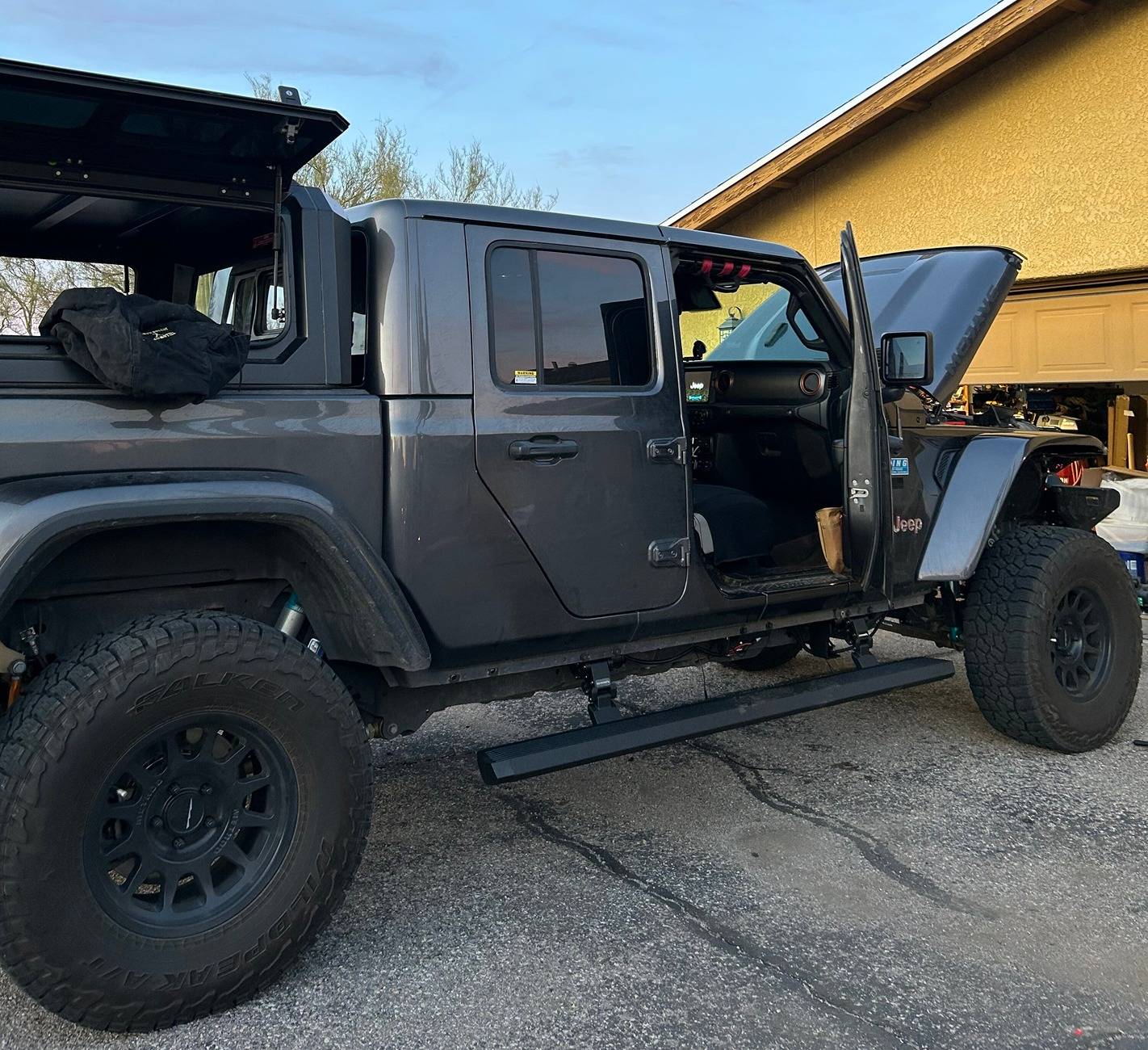

I had the AMP XL running boards installed on my 21 Gladiator Mojave. They work well. The top of the step is about 12 inches above the ground.
at the end of Dec, I traded for a 23 Wrangler 4xe. Go Rhino now has powered steps. Those were available and I bought them. Realtruck had a good price. I had them installed. They have a separate wiring harness that connects at the battery. They use the magnets sensors on the doors. The steps are about 11 inches high from the ground.
I must add, the install instructions were not great, and Go Rhino did not have tech support available when we called. The left side connectors were wired backwards. You could see the red and black wires were reversed, at a connector. My installer was able to correct for this and fixed it.
hope this helps!
