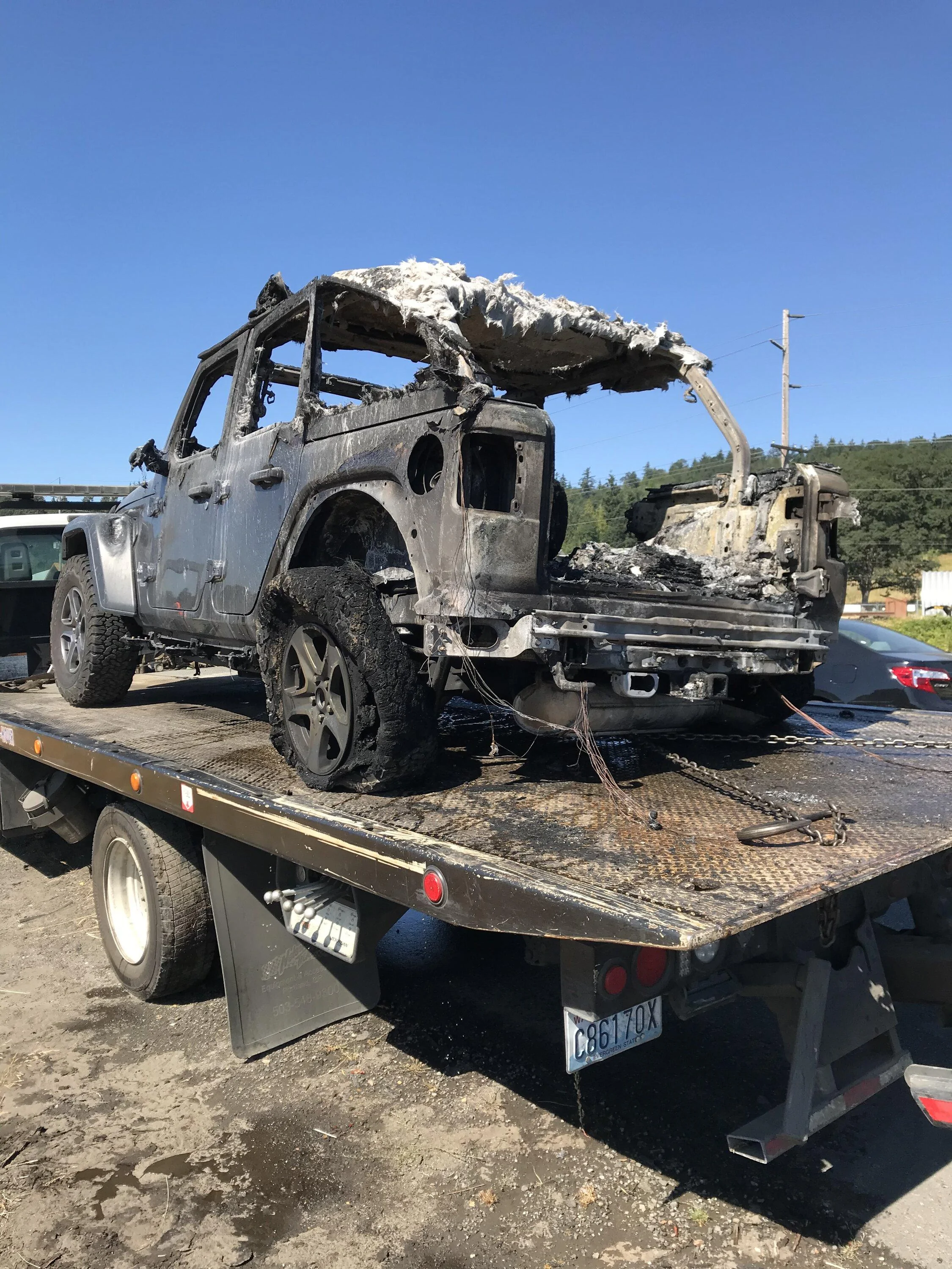

My wife has a manual 2018 JLR. I have known about the clutch issues and have considered a Centerforce or Luck as a replacement. The dealership made an adjustment when they performed the last recall and it is better, but it still worries me since it was not replaced.
I have told her about the issues but she did not fully understand it until this weekend when I showed her a picture of one that exploded. Now she may be on board for a new clutch.

Center force and South Bend make upgrades. But I think the clutch wasn't bled correctly/well. We haven't seen a clutch fire in a few years on this forum, since the recall first happened, and for the owner to have just had the recall done, and then have it burn up is very coincidental. I know, correlation doesn't equal causation, but the timing seems odd.
Yikes. Glad everyone is ok. I agree that the timing is suspicious. I have the Centerforce Dual Friction clutch and flywheel kit and I just got new hydraulics from Centerforce but haven’t even opened the box yet. The factory clutch is only covered by a 12,000 mile, 12 month warranty. Love my Centerforce clutch it’s so much better than stock !
