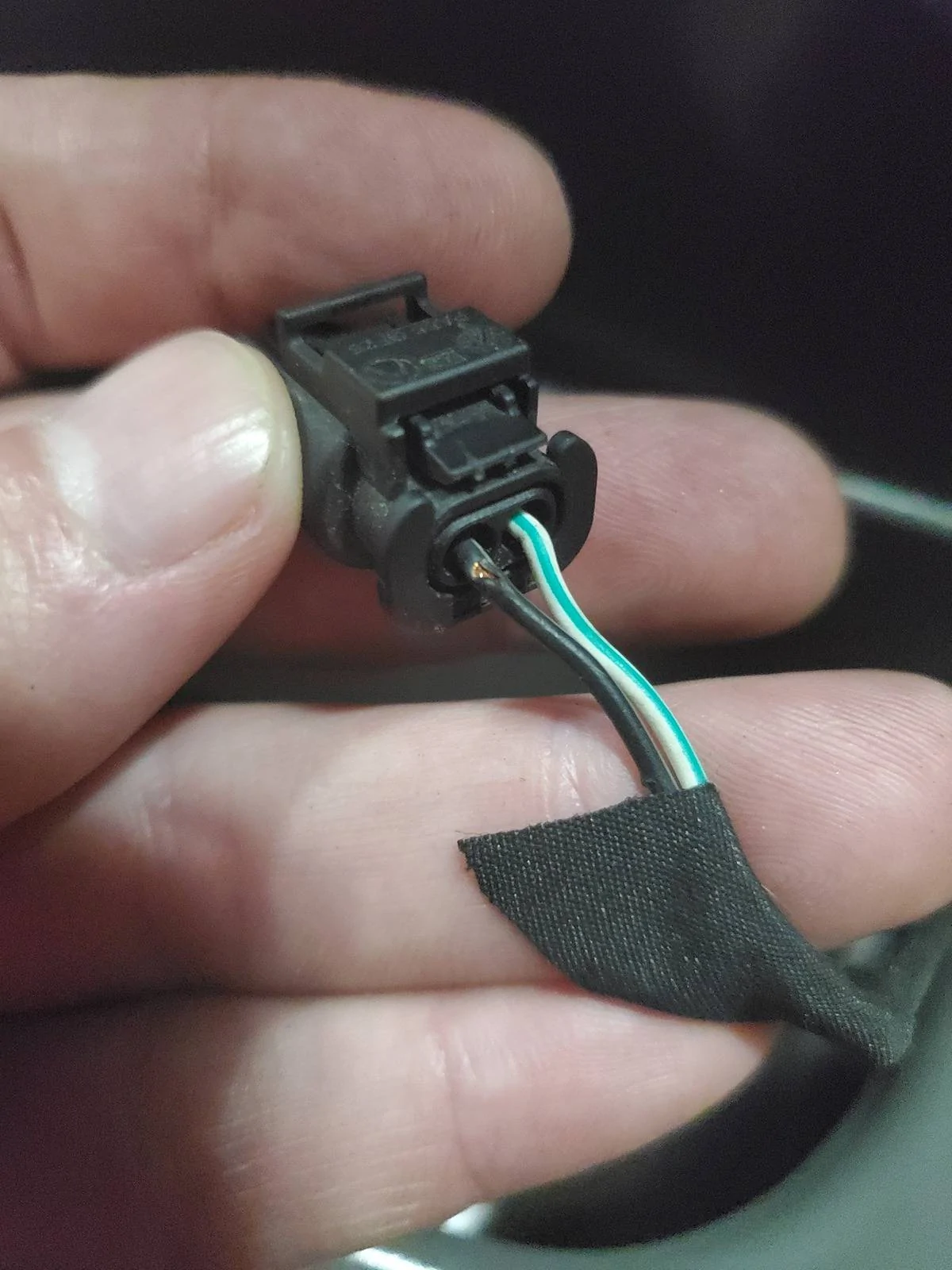

It's luck of the draw if you have the 3rd brake light issue or not. Half our JT group has had issues, no rhyme or reason.

3rd brake light wire looks like someone jammed a test light into the wire lol but who knows.

Yeah no telling. Only time the panel has been off is when I had my bed lined back in 2020. Like I said I have no clue how it wound up like that. Checked the entire area and nothing was even close to it. I'll get it repaired sometime.

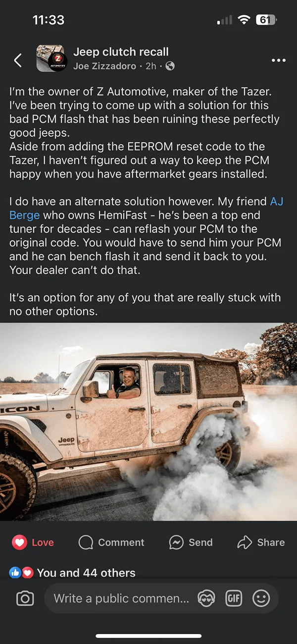

Jeep Gladiator Clutch Recall (2/23/23): Clutch Pressure Plate May Overheat -- Affecting 70,000 Manual Jeep Wranglers and Gladiators IMG_9580
Soooo we have this as an option if Jeep doesn’t have some better software at some point.
im holding out a little while longer but hope has arrived.
