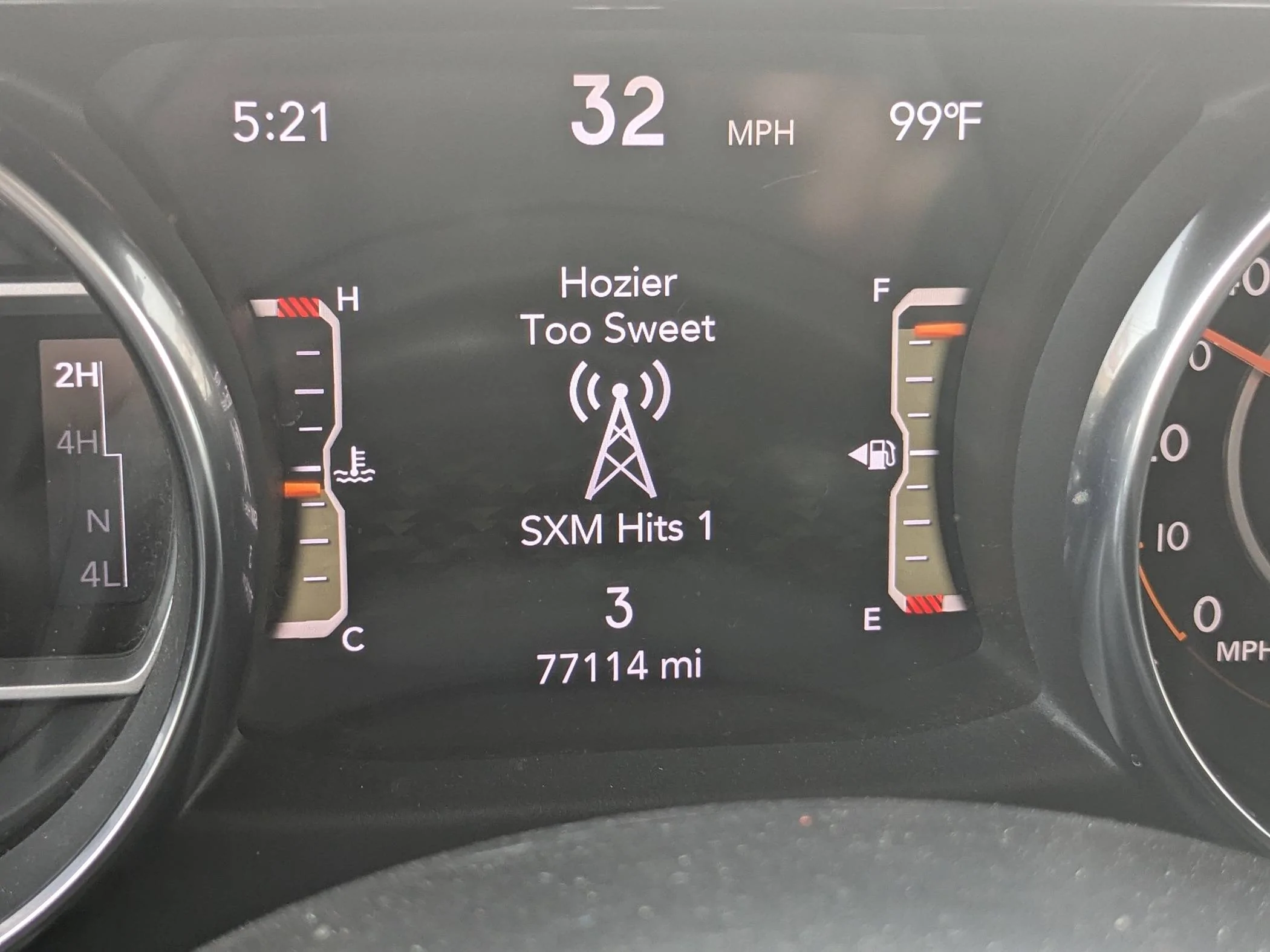

Has there always been a gear indicator in the settings that I never found before? It now tells me what gear I'm in. New clutch is smooth. Old throwout bearing was stiff in comparison to the new.
My 22 has it, haven’t done the recall yet.

Found another forum thread, part of the new software update added it to the early '21 and older builds. Later '21 through now have had that already.

What year is your Jeep? That was part of the 2nd recall. So yours probably did not have that one. Not a huge deal if you didn't have any problems. My 2018 Wrangler has never had an issue with the clutch from day 1. So for me, the recalls have just been updates. No change in performance. The indicator is nice. My ex wife and brother in law both smoked my clutch badly a few times trying to start out in 3rd gear thinking they were in 1st.
