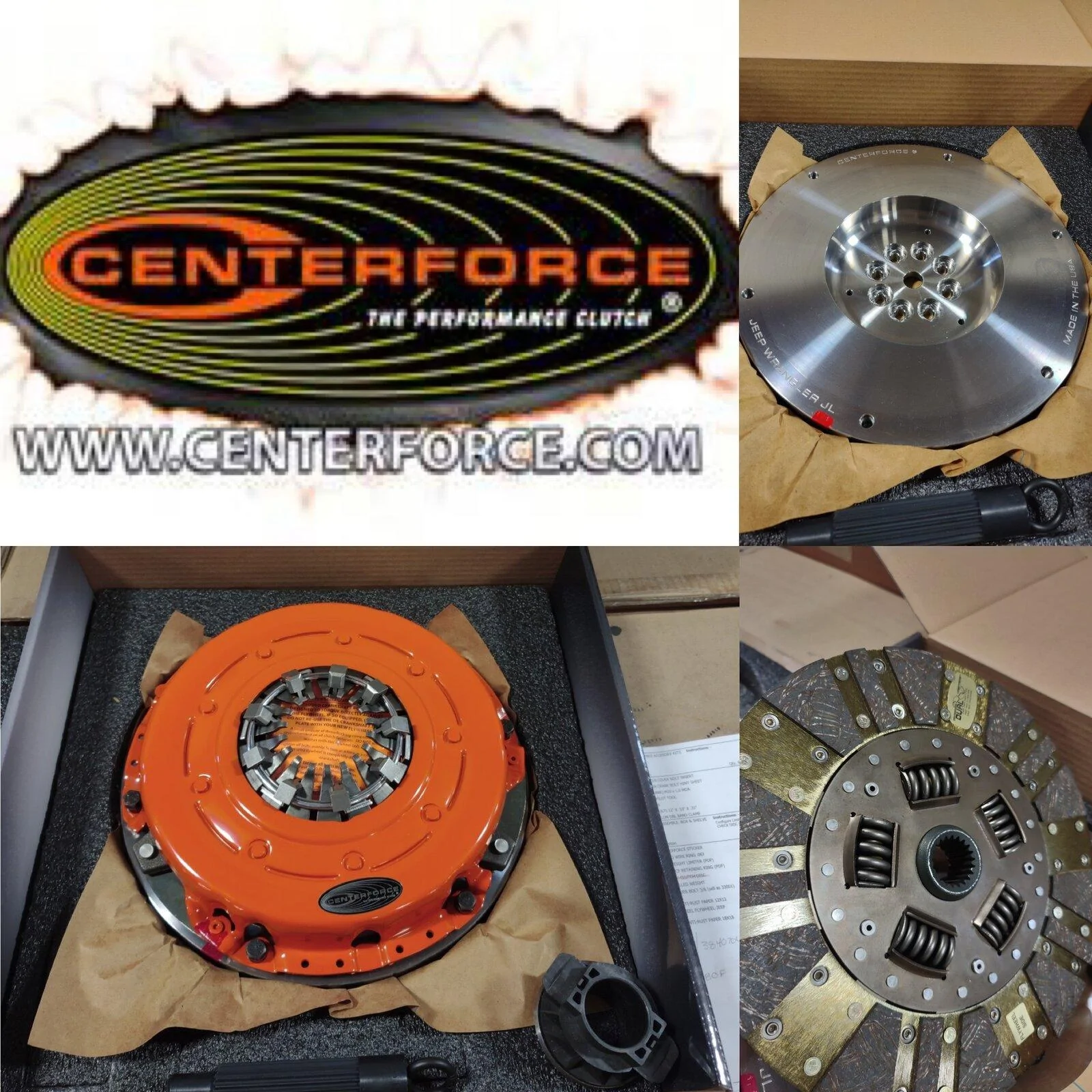

Just got pics and tracking number for my long awaited (over a year due to a complete redesign) Centerforce clutch. Can’t wait! Gotta break in my 5.13 gears and then get it into the shop for the clutch and flywheel.
So centerforce finally figured out all the bugs, good to know. This will def be down the road replacement for me. Please keep us informed on how the clutch operates and if there are any issues. Thanks.
Will do.
