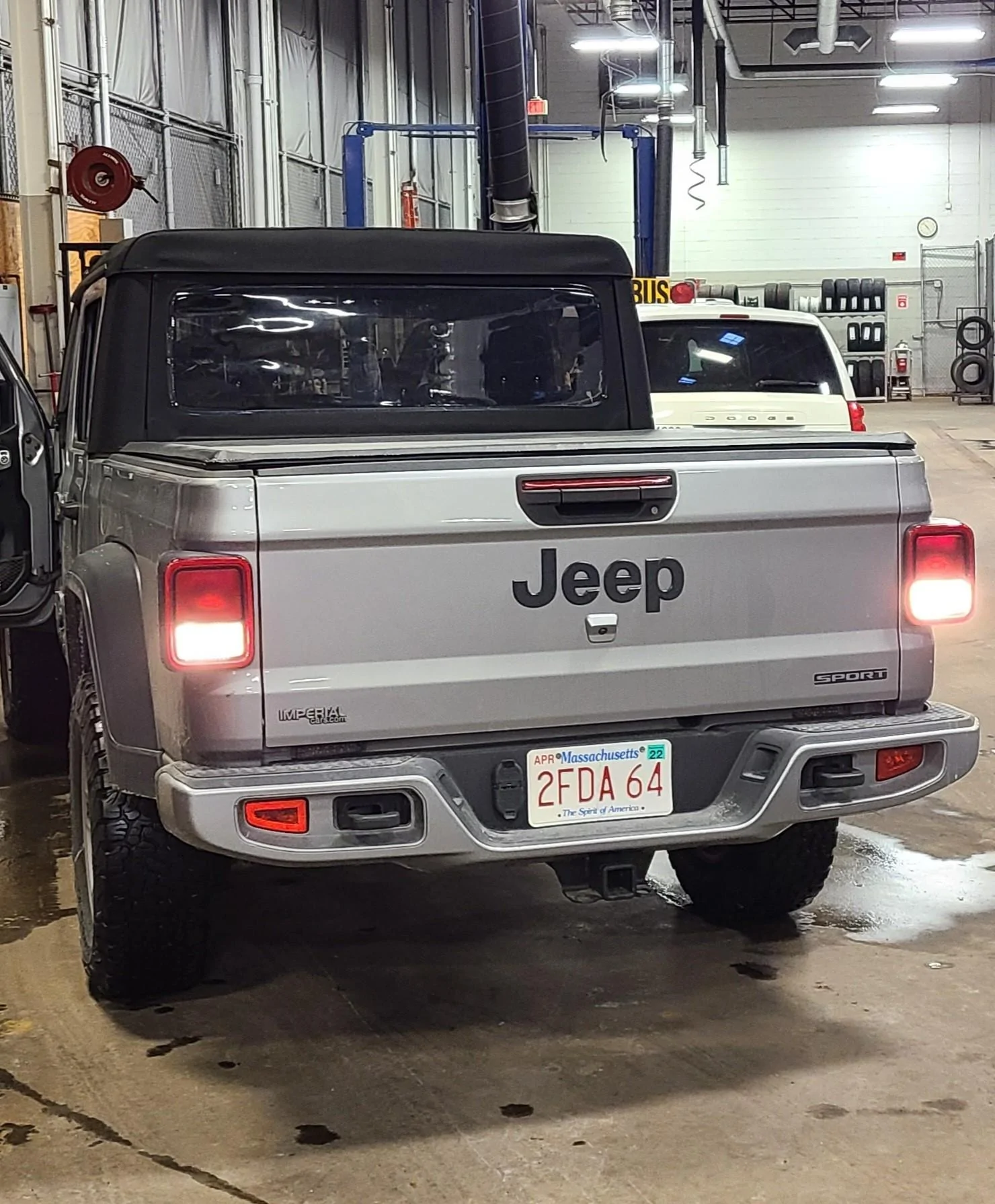

Trip # 2 to a second dealership for my issue following having this recall performed. From the beginning. I never had any intention of getting the recall performed. But, in August while my Gladiator was at the body shop they took it to Harr for a shifter issue. When I dropped the Jeep off all lights worked as well as the reverse camera. Harr supposedly did the recall flash. I say supposedly because as a service writer myself [who was 5 star certified] I know that the last thing the tech is supposed to do is check that the repair has fixed the problem. Well after the recall I have no reverse lights, no back up camera, and the dash shows an N where the gear indicator is supposed to now be. Yes I know I should take the shifter boot off and check the plugs there. Here is my issue, I paid what, $7000.00 of the purchase price of my Jeep for the warranty? If I am forced to repair Harr motors crappy job I want that $$ put against my loan! Jeep cares What do you have to say?

Well a month later............. No one ever contacted me from either Harr or jeep cares. I fixed it myself. Who do I bill for my time ,experience, knowledge $10,000.00 is what I believe the useless warranty is worth in todays money. At least I can make it legal to drive with an inspection sticker tomorrow morning! The second dealership that looked at it complained of my aftermarket lighting that was the problem. Well the issue was ALL JEEP and the recall work not being fully complete. I'm not getting into what the actual issue was because my time is worth $10k. Maybe someday techs will get paid enough to bother having pride in a job well done but the flat rate bullpoop system in place as it is will leave people like me disenfranchised and never willing to purchase another new vehicle ever
