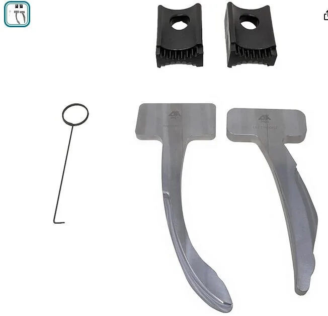

-The tool to lock the cams and loosen the chain is about $400. The cheapo kits on Amazon are for the old engines, not the new VVL ones in our trucks
- when you are using the tool, it doesn't seem to loosen the chain very much at all, I wasn't sure if it was working, but it was enough to remove the cam phaser from the cam

Do you have the part number/source for the VVL tool set?

The tool set I used is the CTA Tools 1205 which includes both the tension release tools, and the cam locking blocks. It is currently $538 CAD on Amazon.ca but I paid about $400 a few weeks back.
Apparently you can make the old style locking blocks work, and then just buy the right side tension release tool (CTA Tools 3921).
I didn't want to risk it not working and waiting another week or so, so I went ahead and bought the whole kit.

Thank you! This is very helpful!
