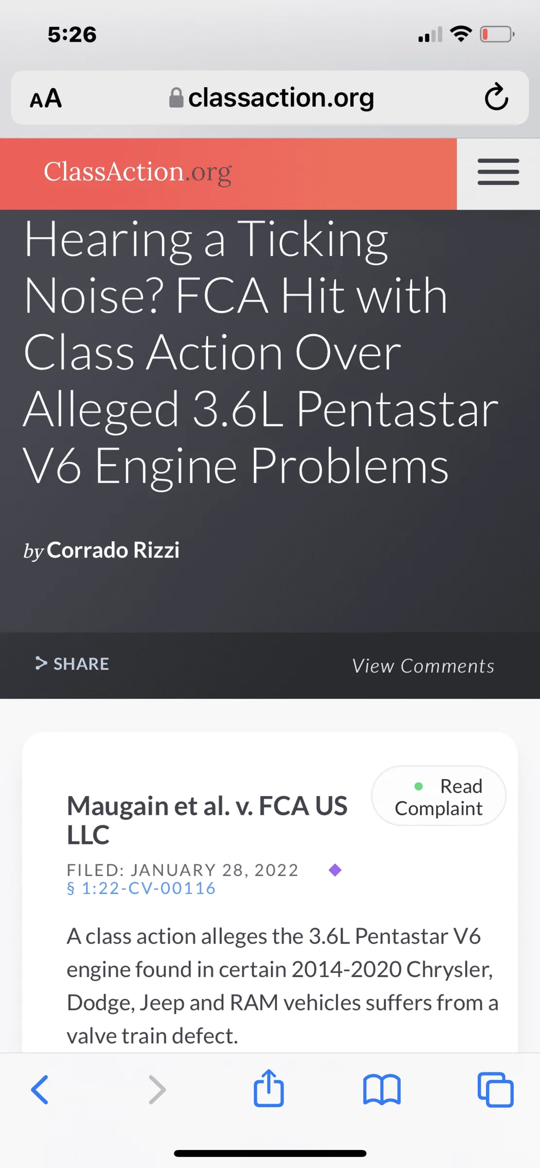

It is the old 3.6 tick
Jeep Gladiator Short ticking noise on cold start 2B9BC78C-0A42-4AA3-B45B-32C5A3F38635
And they have know about it a while
