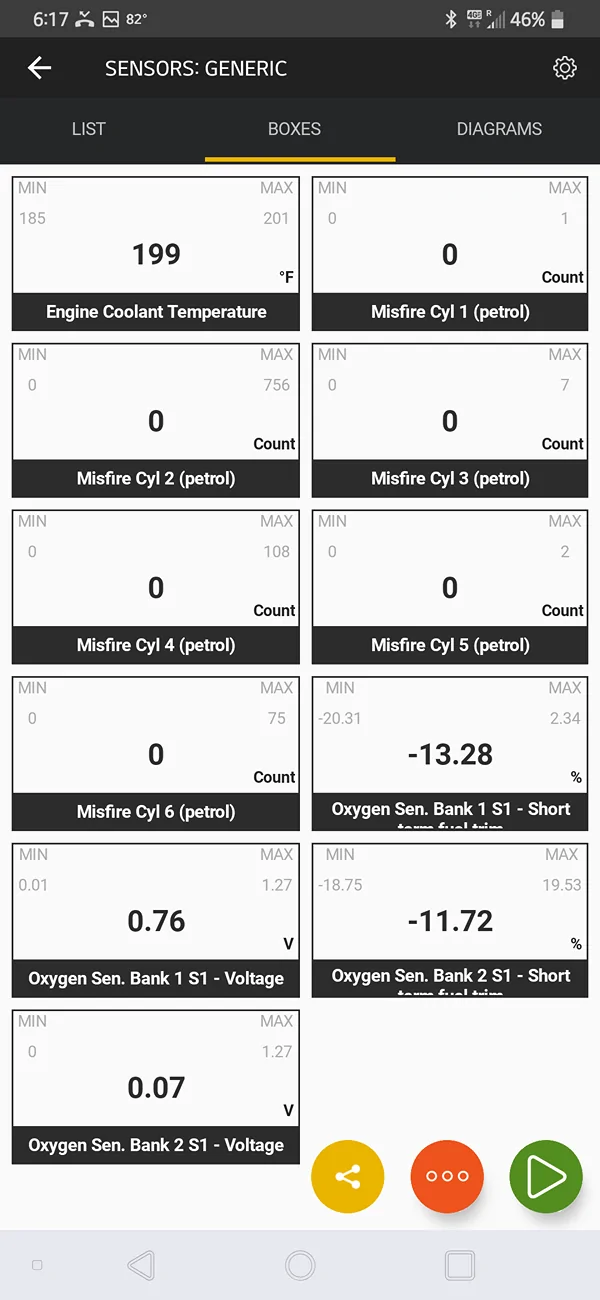

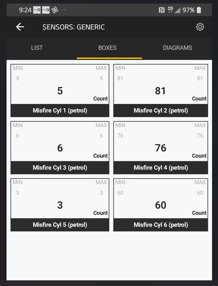

Setup JSCAN to show you cylinder misfires and see what happens -
Jeep Gladiator Rough idle on cold start, not as bad after warmed up 1763943791886-1g
Jeep Gladiator Rough idle on cold start, not as bad after warmed up Screenshot_20220915-181729
