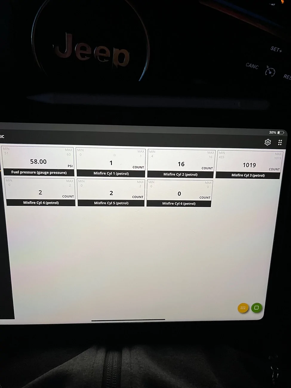

This was on my 30 min drive home. Probably 1000 plus of cylinder 3 misfires were in the first 5 min.
Jeep Gladiator Cold start rough idle and sometimes 303 code IMG_2227
Jeep Gladiator Cold start rough idle and sometimes 303 code IMG_2226

Cylinder nbr 3 is a smoking gun. Swapping coil packs and replacing sparkplugs would be a start. You could check the connections of the fuel injector for nbr 3.

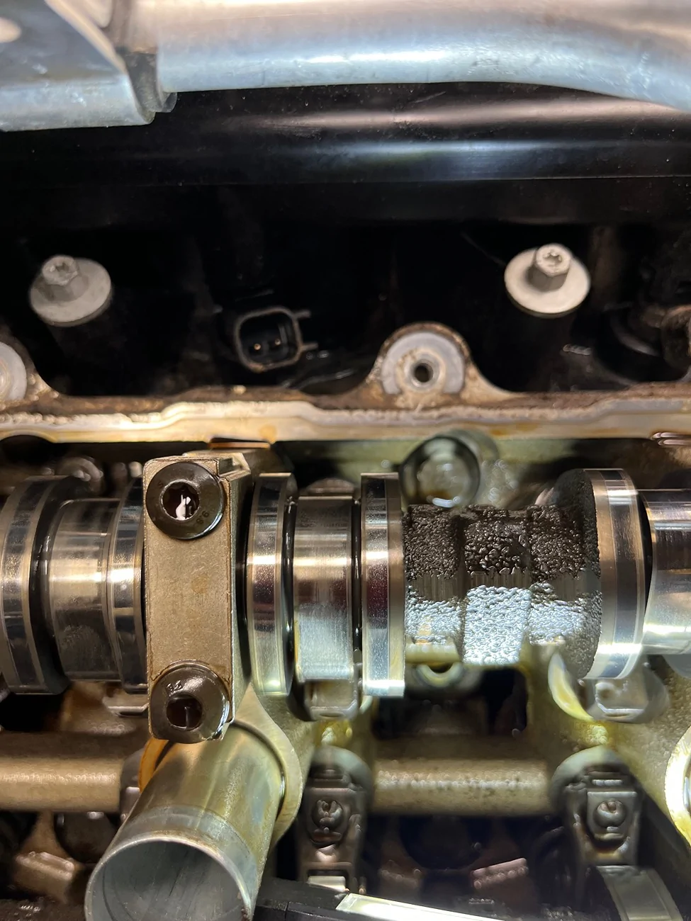

yes, I’ll be looking for a Cam plus parts. First picture is cylinder 3 fwd lobe. Might be hard to see but the groove is there.

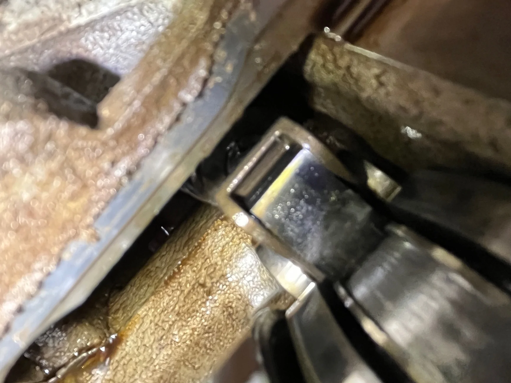

This is cylinder 5 rear lobe. It’s worse than three. Wasn’t getting misfires on that one but based on what I’ve read here that doesn’t mean it isn’t there.
sorry about the crappy picture but i have an old iPhone.

The top of the intake lobe for 3 is worn down as well from the looks of that picture
At least I have another vehicle to get to work.
Now to get on the list……
I hate it for you. It not what you wanted to see, but now you know.

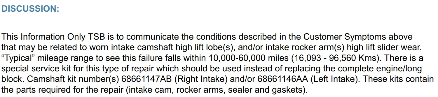

thanks for the TSB poop Sierra Pop!
