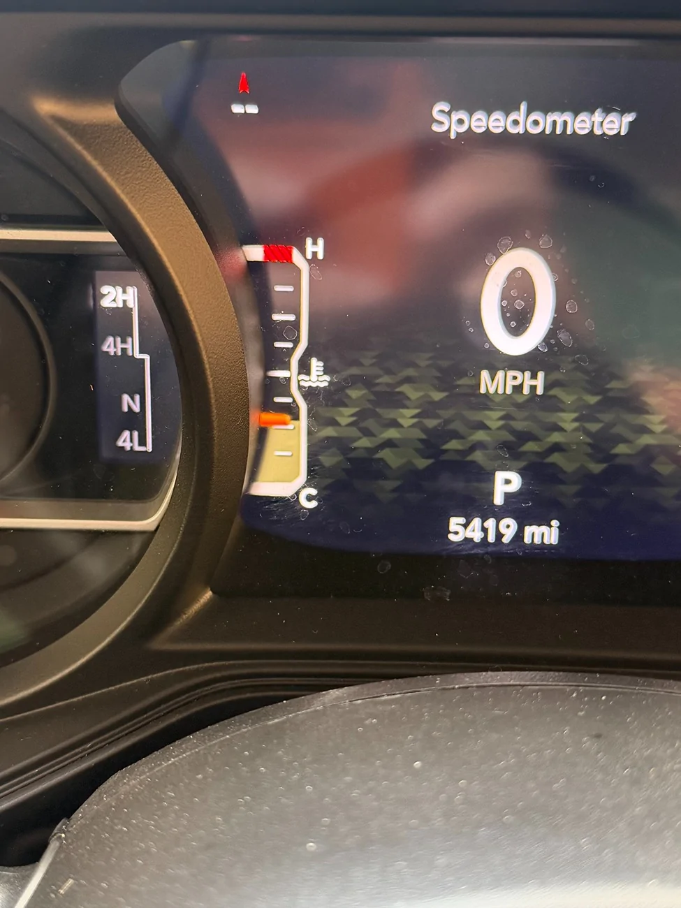

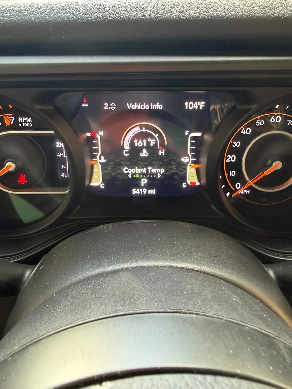

First-time Jeep owner here. Joined the family Monday with a used 2024 JTMT with ~5400 miles.
Noticed a rough idle when cold Tuesday morning. (sat overnight). Took it to the dealer Wednesday, and they weren't even interested in hardly looking at it. I bought their "injector cleaner" service just to create a record of my concern and to create an initial relationship with the dealer. Their recommendation is that it has likely sat for some time. Run the injector cleaner, put a few tanks of premium in it, and drive it for a couple of months. "it should clear up".
One thread I have since read on these forums seems to describe my issue exactly. The consensus from that thread was to try to pull diag logs on it while it is doing it because if it was a "fuel" issue, it would do it the entire time it was running.
My symptoms
1. On cold start no rough idle
2. About 60-90 seconds in, the rough idle starts. It is worse with a/c on but doesn't go away completely with a/c off.
3. Feels like a single surge or miss every couple of seconds. With a/c on it is 2 or 3 surges at a time
4. The tach needle doesn't move at all during the rough idle. Even the lightest touch on the gas stops the behavior instantly. When letting off, it comes back.
5. The issue also goes away when fully warmed up.
The pictures below show the temp when the roughness starts and when it goes away.
Any thoughts from the experienced Jeep guys would be much appreciated.
Thank you, Kindly
-Travis

There is nothing wrong with your Jeep at all. And a fuel system cleaning service with 5000 mile was a waste of money.
These have a very aggressive variable cam and spark timing mapping when the engine is warming up, this is done on purpose to heat up the catalytic converter and engine as fast as possible and will often manifest as "rough" running. The engine will advance the intake cam and retard the exhaust cam from their base position to create a mild EGR effect and recycle hotter air through the combustion process during warm up. This is why these engines warm up so quickly. What your describing is common and nothing to worry about, a significant rough running or misfire even will cause a check engine light.
