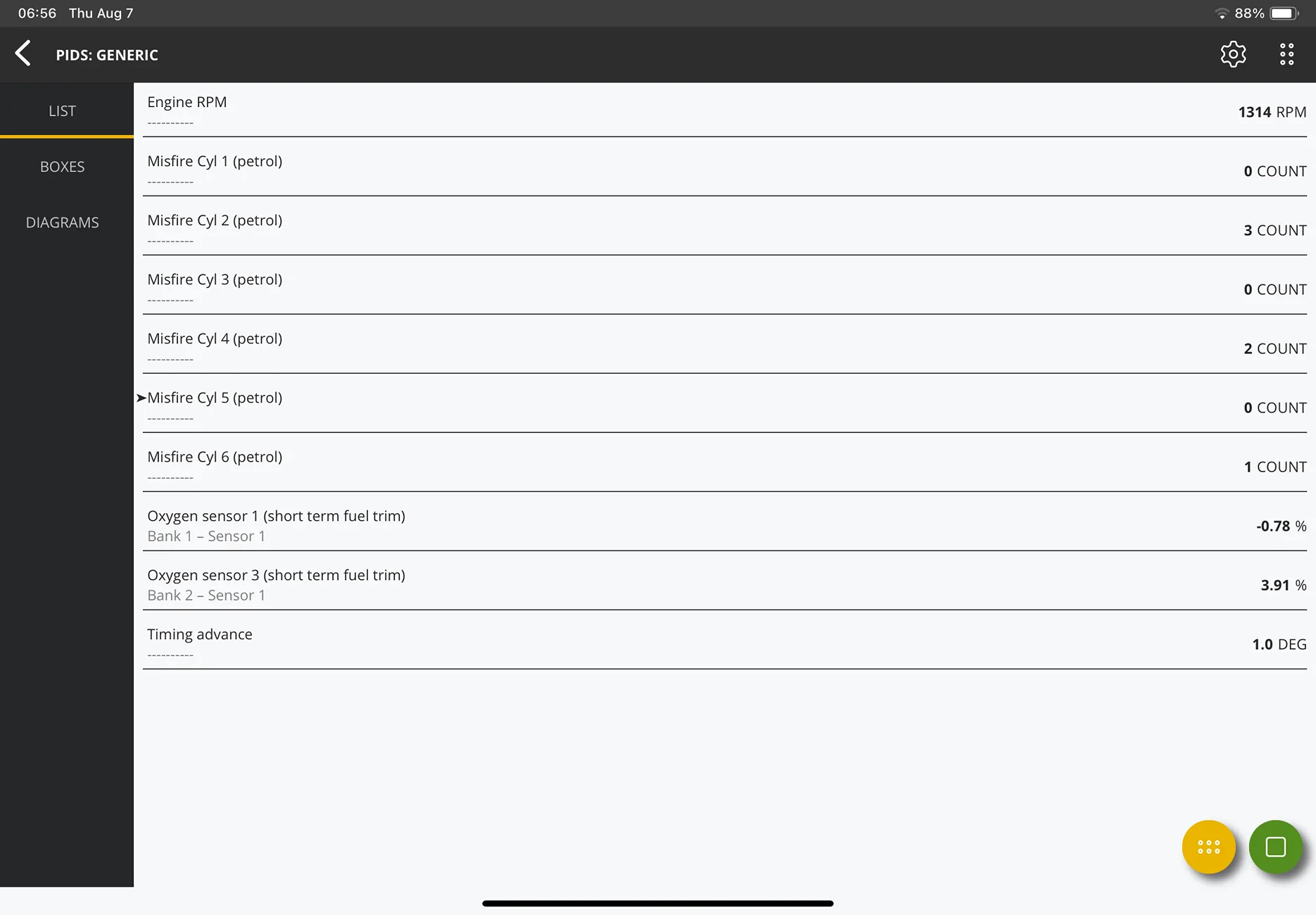

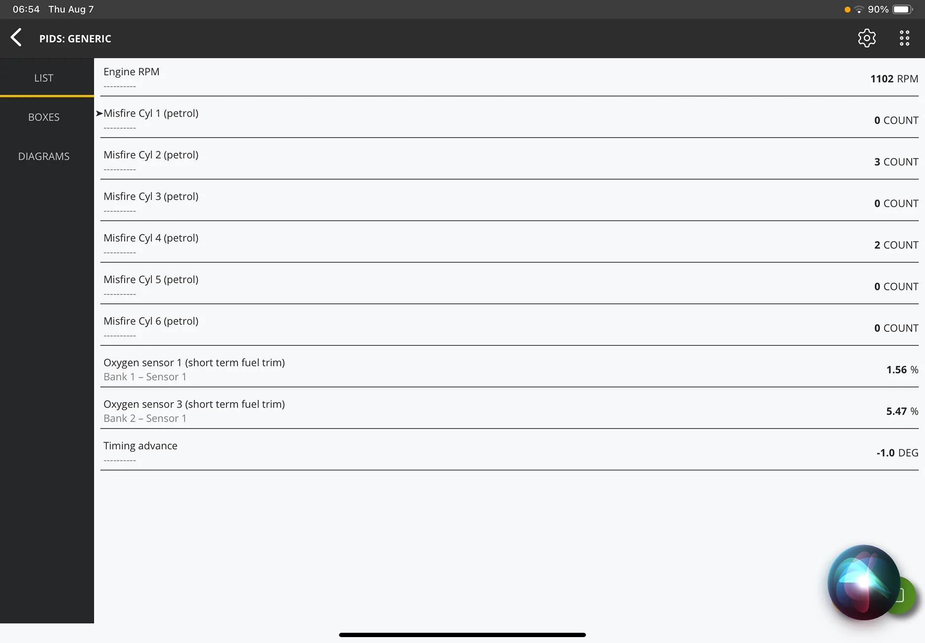

So, cold had misfires on the left side, nothing on the right. Number never increased beyond initial misfires. Drove up a hill to put a load on, no change. Ran rpm up to 3 grand(would not go higher when parked) and no change in misfires.

The only change has been new plugs on the right side.

The code has not come back and you basically don't have any misfire issues. Even for a cold start those low number of misfires are not a big deal. Zero misfires warmed up is even better. Let's go with plugs took care of it. Unless it is running like crap, drive it. Keep your tool handy so you can check on the go.

There will always be misfires, as it is the nature of the beast. Don't be concerned with the low numbers. If there's a miss/misfire that's a problem, it will be evident by magnitudes. 100, 200, 300 misfires or more compared to 10-15 for other cylinders.

For a cold start, those numbers are pretty good. I would say most have worse numbers on cold start being normal.

I consider low single digits on a cold start to be nothing.
It's harder to get a charge lit when things are cold. It's been that way since the very first engines were ever built.

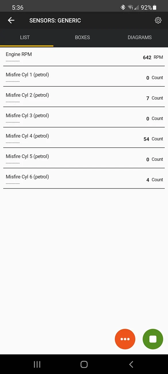

All four of my JT's to include current one would have have one or two cylinders showing double digit cold start misfire counts with usually one cylinder having a noticeable higher count. Pretty sure this is what drove the PCM reflash TSB back in 2021 that I believe widen the misfire count threshold before MIL would post.
I would be ecstatic to have the numbers @Hoist just posted.

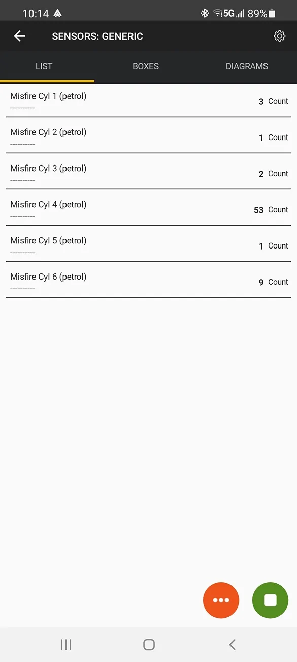

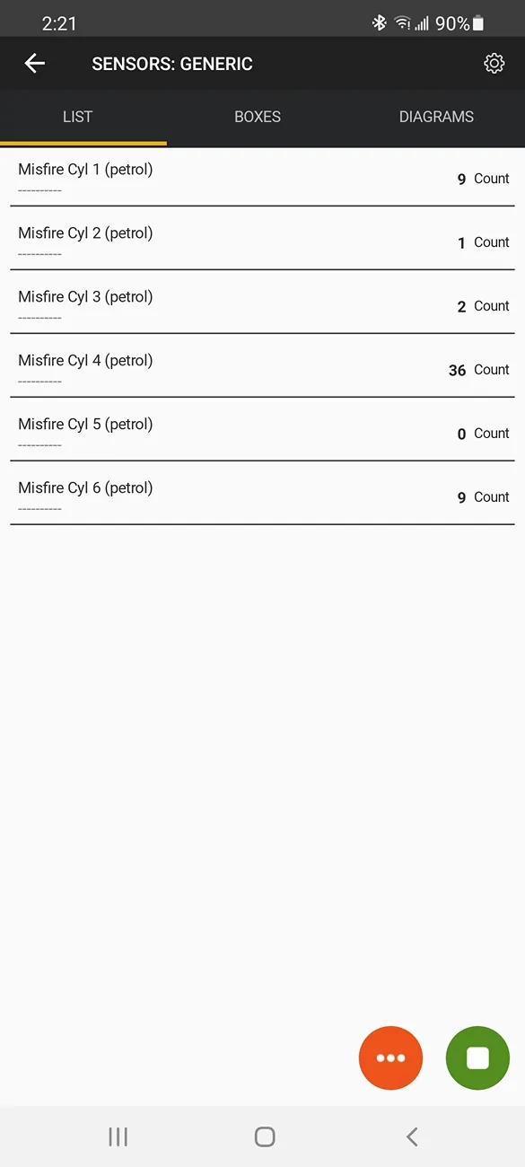

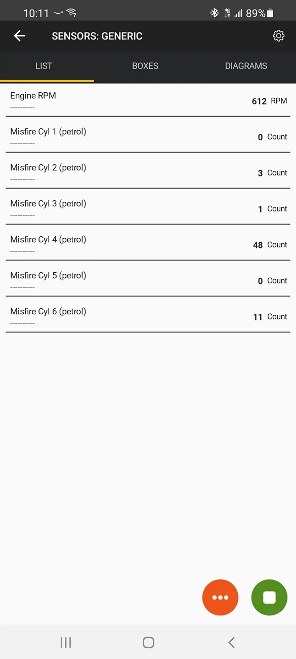

Jeep Gladiator Cold start rough idle and sometimes 303 code P0300_8-22-2021
Jeep Gladiator Cold start rough idle and sometimes 303 code P0300_9-01-2021
Jeep Gladiator Cold start rough idle and sometimes 303 code P0300_9-15-2021
Jeep Gladiator Cold start rough idle and sometimes 303 code P0300_9-17-2021
Jeep Gladiator Cold start rough idle and sometimes 303 code P0300_10-09-2021

So to sum this up of sorts:
12.4 may not be optimal on an AGM but its not a problem
Changing plugs and going back to original (factory) coil on nbr 3 seems to have eliminated the misfires on the pax side.
Definitely do all plugs. These are really sensitive to spark plug issues. In fact, some had misfires due to bad NEW plugs from the factory.
