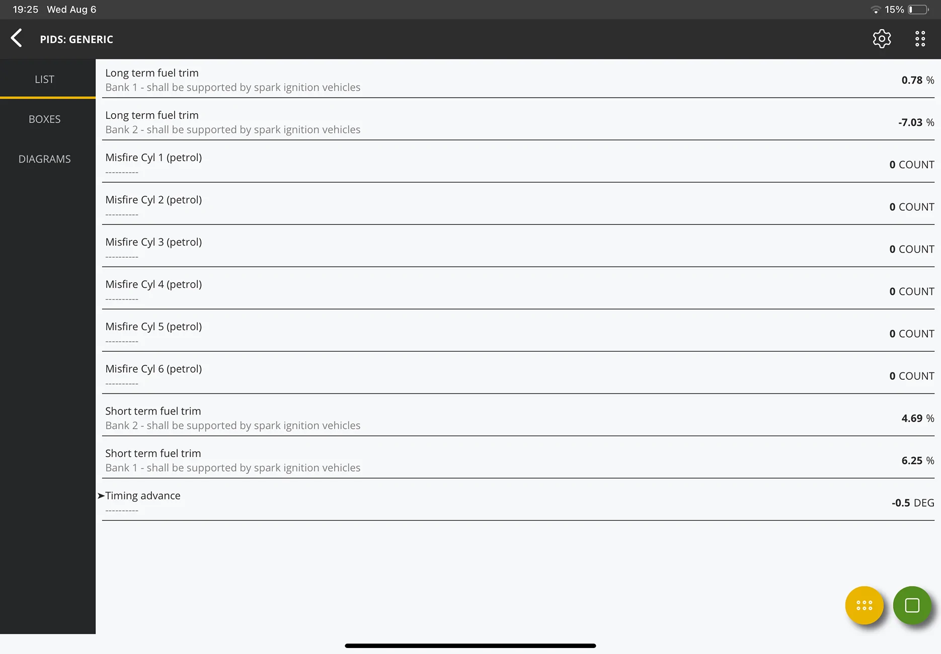

These are a couple scans I did after getting Jscan running. I haven’t figured out how to get history but there are zero codes. As you can see, no misfires. How is that? When I first started, I got 1 mf on nbr 1cyl, 5on nbr2, 0 on 3 and 4 and 1 on 6.
Did an on/off cycle several times and drove around the block and zero MF.
It was quiet or normal noise.
i have to figure out what the fuel numbers mean ie how to interpret them.
Was that on a cold start?

Have the tool ready to go for your next cold start. Does the jscan program have an rpm limit for misfires? If not I would suggest reving to high lift. It may go to high lift but to be sure rev to 3500 and hold.
251
40,657
54,418
It will show max misfires during that session. So if you start, and stop the engine and start it again, and have fewer misfires it may show more from the last run.
It can go to high lift mode just putting it under load at lower RPMs.
He should be able to find when it changes lift modes, I don't recall where, however..
Battery is holding at 12.4 and Alternator shows 14.21.
12.4 is low, but not low enough to cause a problem.
