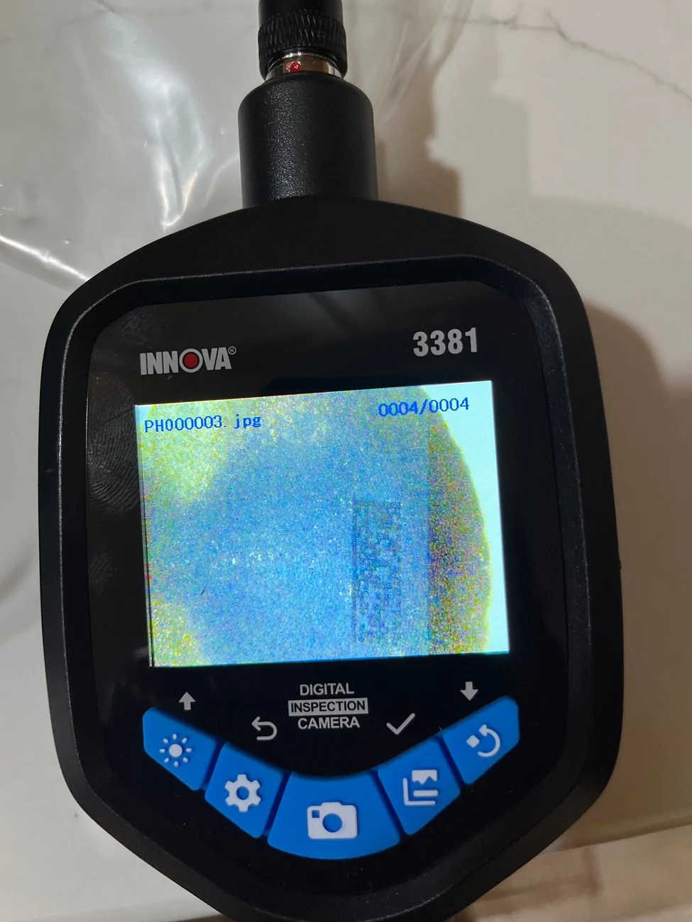

took a picture of the cylinder. Nothing obvious however, is that a barcode on the piston? How could that survive on a piston?
Likely etched in.

Interesting. Etched would make sense.
been putting off pulling valve cover given how much crap is in the way But that may be next step. I haven’t been able to use Jscan since I don’t have the plug in yet. Asked the company in Phoenix why no ship and they were looking into it. Yup.

If another cylinder is carboned up, a coolant leak could be the reason why you can see the barcode on nbr 3. If another cylinder is as clean as nbr 3, move on with removing the valve cover. Oh, after the tool shows up and you do a misfire count.

I have to disconnect the lines from the valve cover either way so I’ll check another cylinder so I have something to compare. I may swap coils with another cylinder to see if it follows.
