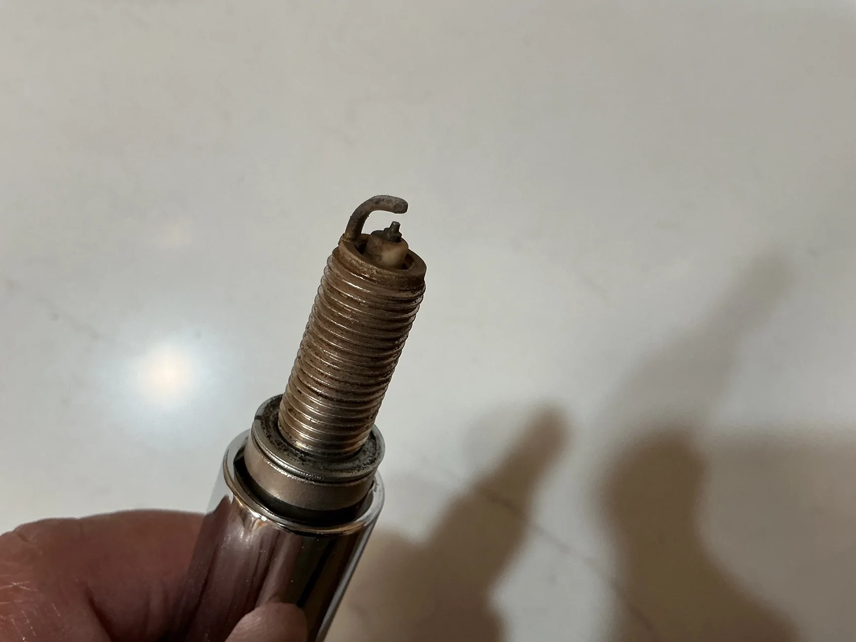

this is what the new plug looked like when I pulled it out. Only a few miles on it.

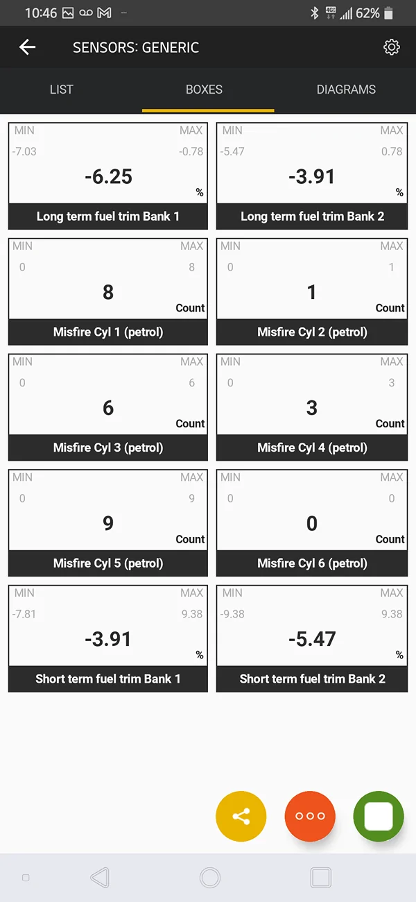

Going to put the plug back in and swap coils.
I have a 5610 which I updated and it added some more features. Obviously I can see some numbers for fuel etc but I don’t have anything to reference to know if it’s good or bad other than not enough to trip a code.

So swapped coils and put a new plug in nbr 1 while I was there and water lines loosened. Started smooth and ran fine zero codes.
I obviously haven’t fixed anything unless the Oreillys coil was not right even with a plug change.

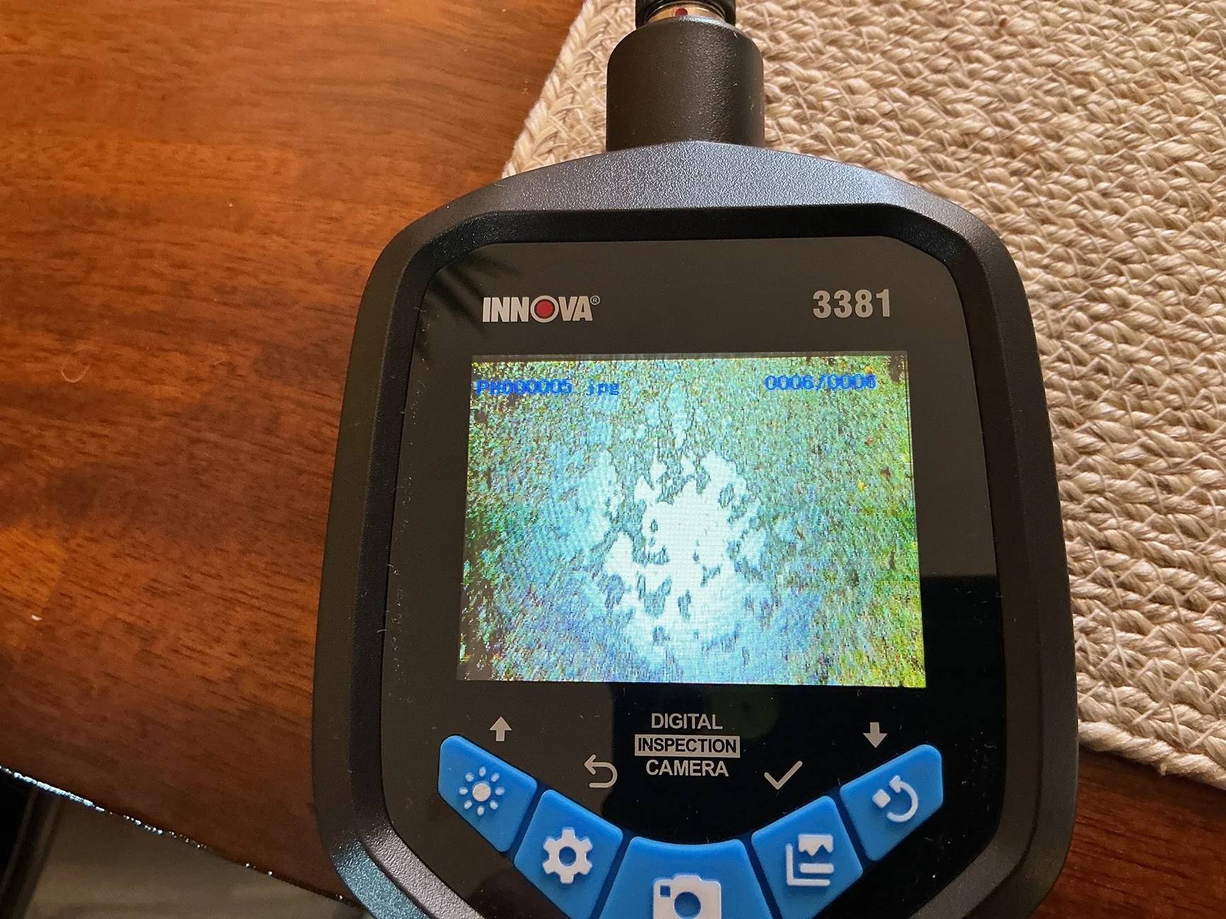

i also attached a pic of the number 1 cylinder.

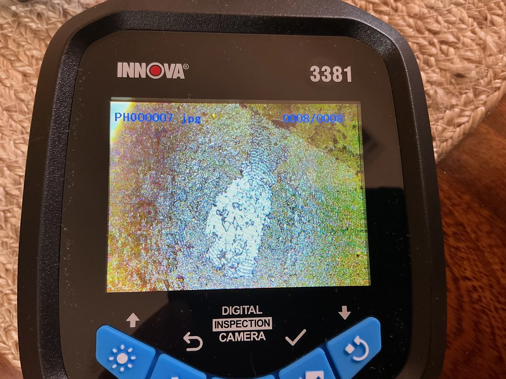

Nbr 5 cylinder

Does that inspection camera have a way to save to a source file that can be uploaded in native format? That picture of a picture is losing a lot of detail and wash out.

Good idea, I would swap the coil to one cylinder and the swap the injector to a different cylinder. Pulling the intake is not required to swap injectors on the right bank, there is enough flex in the fuel line connecting the two fuel rails to allow the injectors to be removed. I use compressed air to blow everything loose (such as sand or grime) on the engine off before removing the injectors or upper intake manifold. If it was a vacuum leak, it normally will cause the engine idle speed to increase. Compare target idle speed with actual idle speed, if it varies more than 15 or 20 rpms, suspect a vacuum leak. Also would cause the affected bank to show different fuel trim adaptives.
