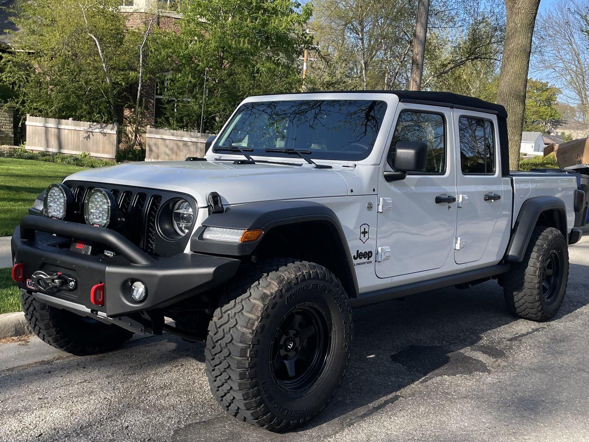

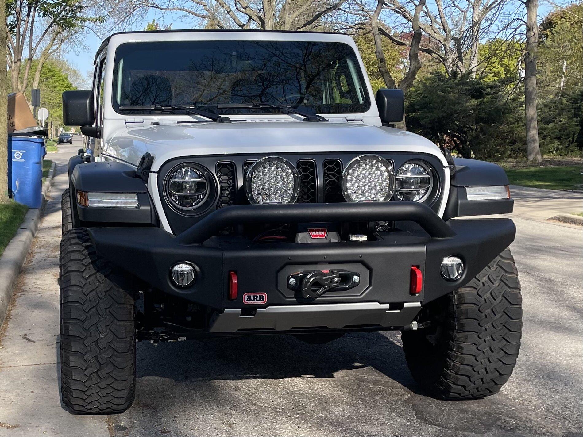

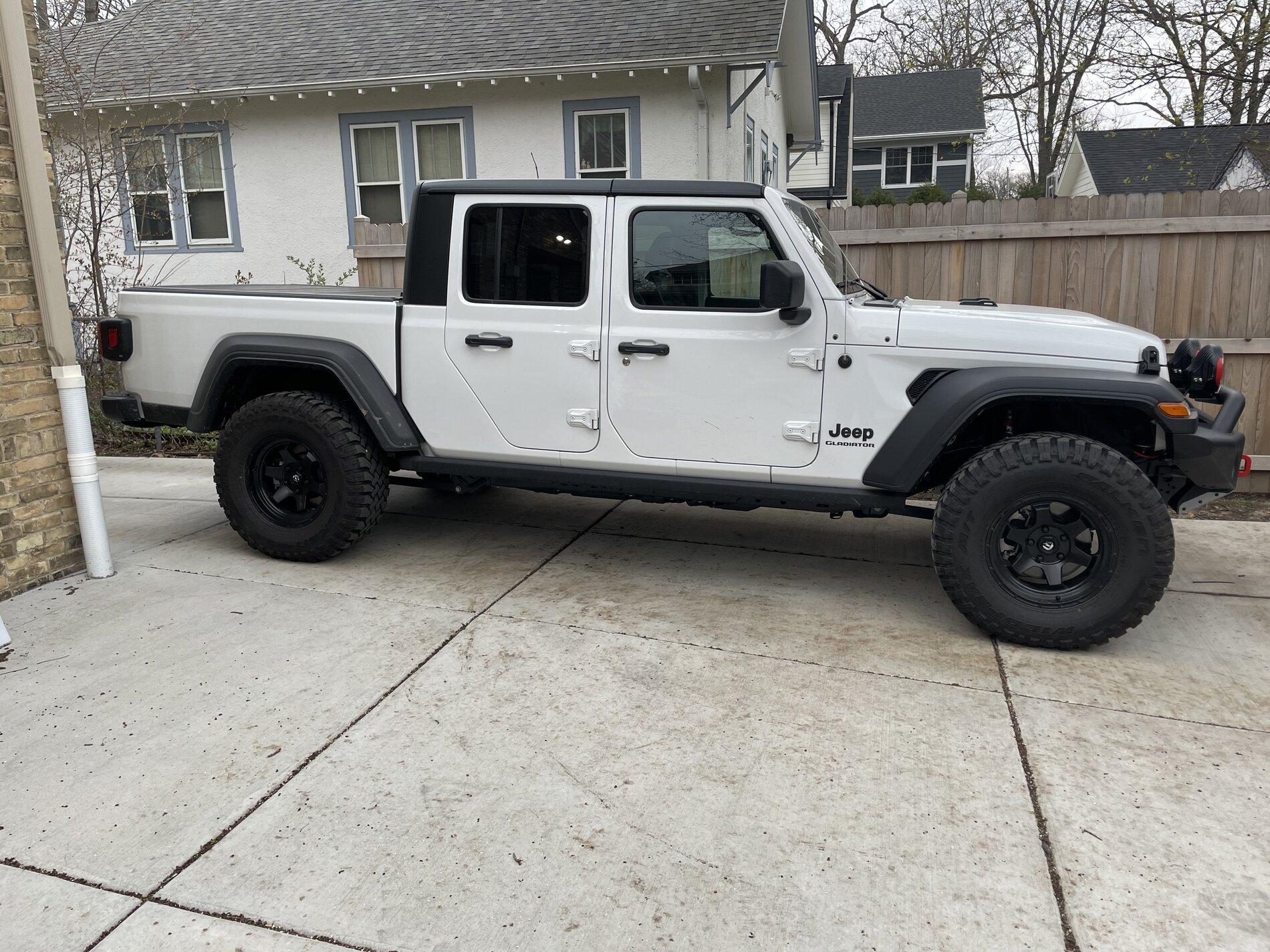

I’m running rubicon springs in front and kept my max tow springs in rear. I’m also running 1.5” spacer in front with a full size bumper and winch.

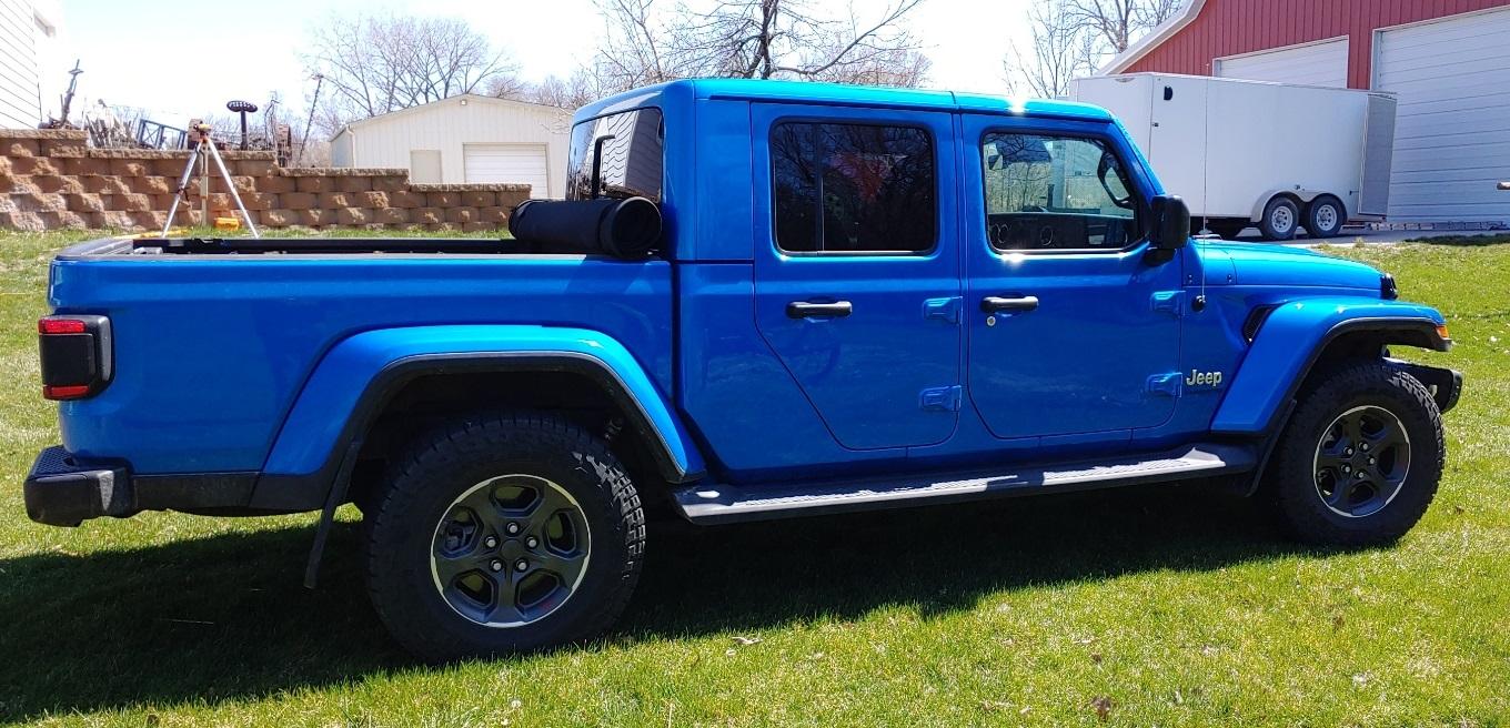

The max tow springs under mine were a tad shorter than the stock Overland rears, with the weight on though they handled the weight so the rear didn't really drop.
I can put over 1,000 pounds in the back and it sits level - before it sagged badly.

Relaxed length of max tow is shorter by an inch than Overland rear springs. But with weight on, the max tow springs handle the weight better so it was only about 1/8" lower in the back with things settled. I laid them side-by-side - plus I had to really pry down hard to get my Overland springs out, the max tow springs slipped in without pulling the axle down.
This is my truck - Rubicon springs up front (the lighter numbers) and max tow under the rear. 3/4" daystar spacers all 4 corners. Truck is shown with 1060 pounds of concrete retaining wall caps in the back.
