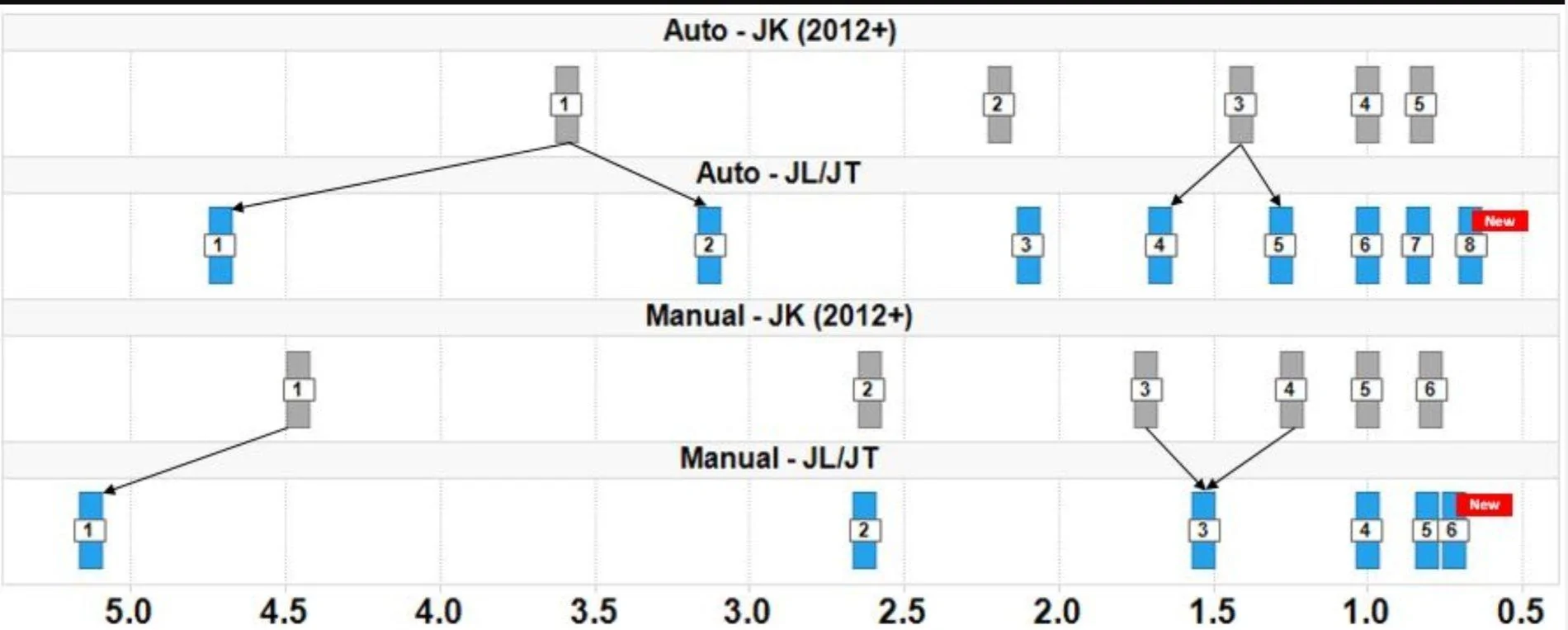

The 6mt in the JL and JT are barely rated for what the engine puts out but it was a required compromise because nothing else fits in the 2dr chassis.
I have never heard this before (not that it isn't correct). Somehow, however, Jeep manged to fit an MT with higher torque ratings into the smaller TJ, which had an inline 6 and was overall just smaller than a JL.
