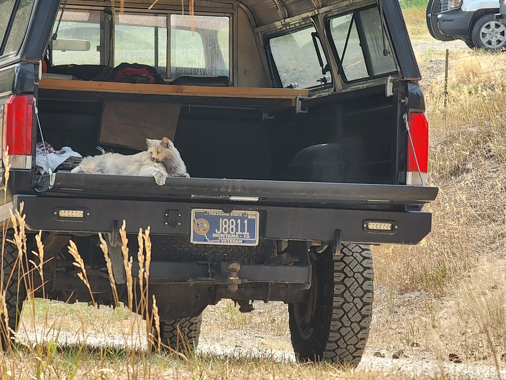

I run a set of 235/85R16 Yoko A/T HD's on my 88 Ford F250. I mainly use this truck during hunting season, where I never know what kind of road conditions I will encounter, and also for landfill runs, and getting firewood. I have had them for 2 years , but pretty low miles. I can't speak on their longevity, but they are literally the best all purpose "mountain" tire I have ever owned. The only reason I didn't put them on my Gladiator is because they didn't have a size that I wanted to run. I opted for 255/85R17 Baja Boss A/Ts. I just put them on 1000 miles ago and they have only seen pavement. I won't have any comments on their performance for until about December, but they look like they will perform well for my needs.
I carry tire chains 100% of the time, so I know about needing the extra room to clear them. I run tall/skinny tires as much as I can. I personally believe that the size of the tire effects the traction just as much or more than the actual tread, especially during winter and on snowy FS Roads.
In short, I don't think you'll regret the Yokohama's.
