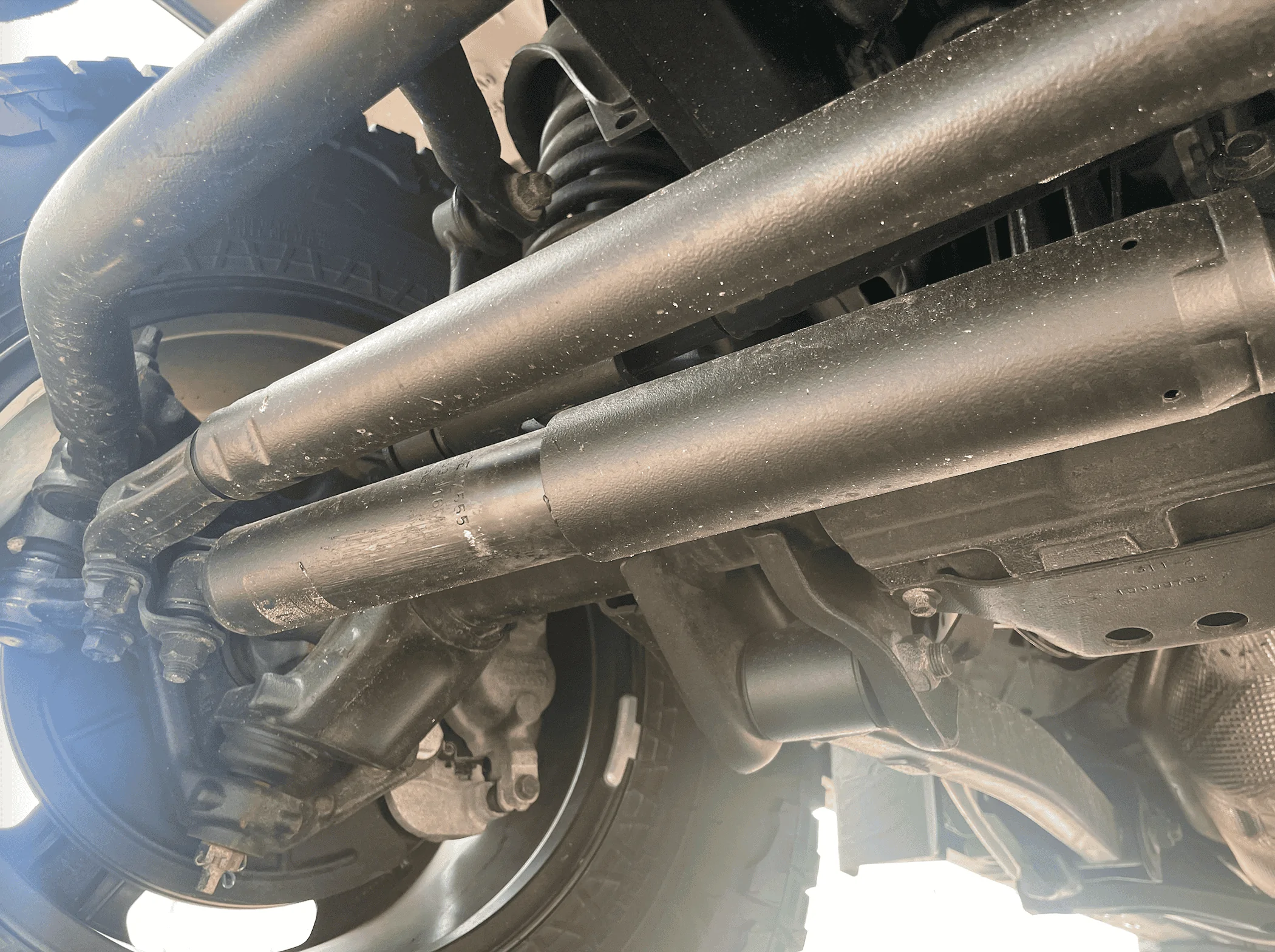

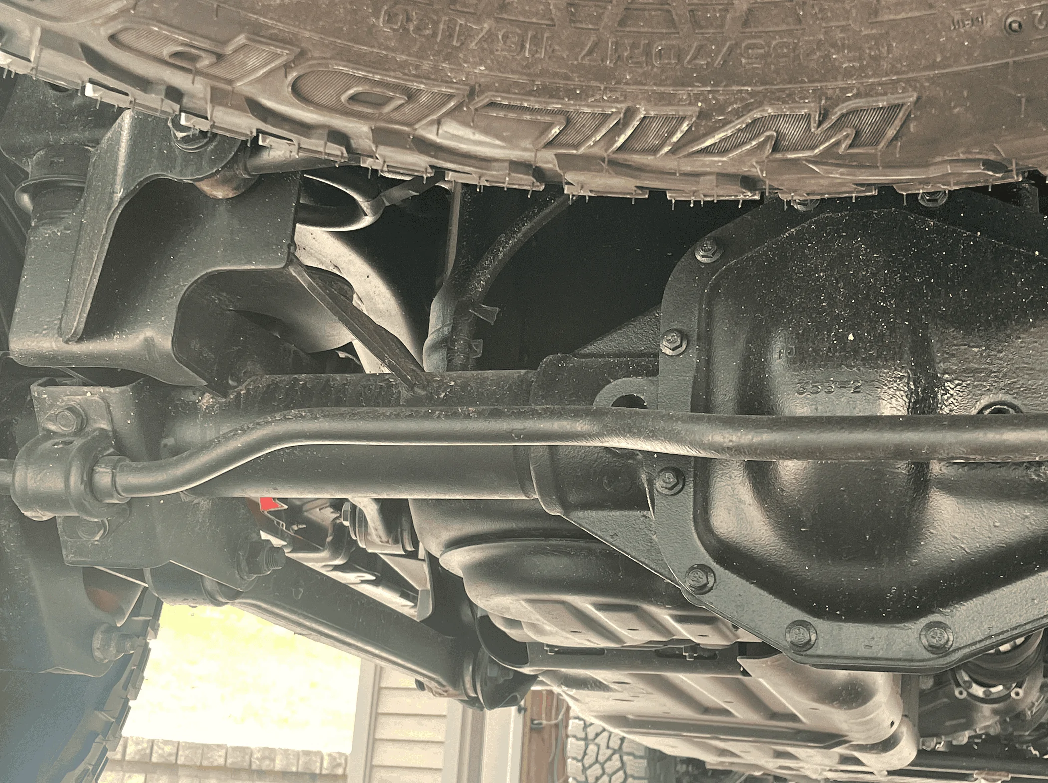

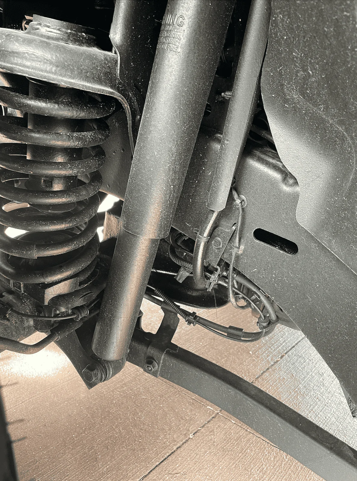

I had mine coated with NHOU boss wax in November before winter and the salt hit. They hit it with the wax and then used their oil product in the frame cavities. After the first winter, it looks great--very small amount of surface rust seen here--
Jeep Gladiator Anyone DIY Woolwax or Fluid Film? wax1
Jeep Gladiator Anyone DIY Woolwax or Fluid Film? wax2
Jeep Gladiator Anyone DIY Woolwax or Fluid Film? wax3
Jeep Gladiator Anyone DIY Woolwax or Fluid Film? wax4

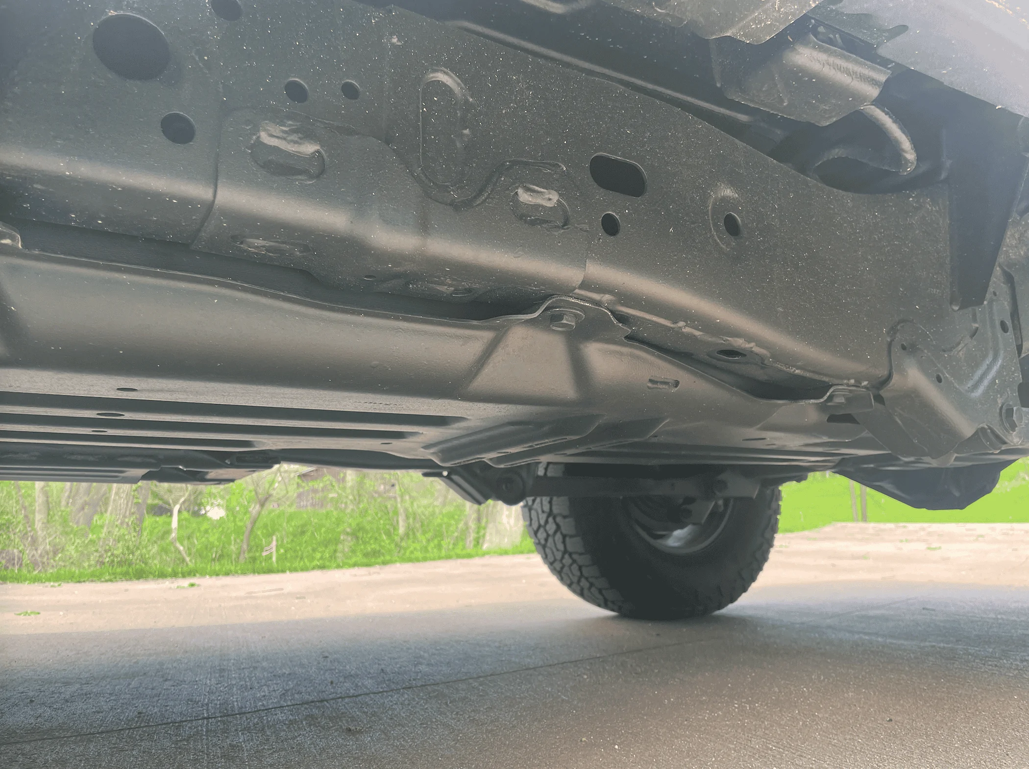

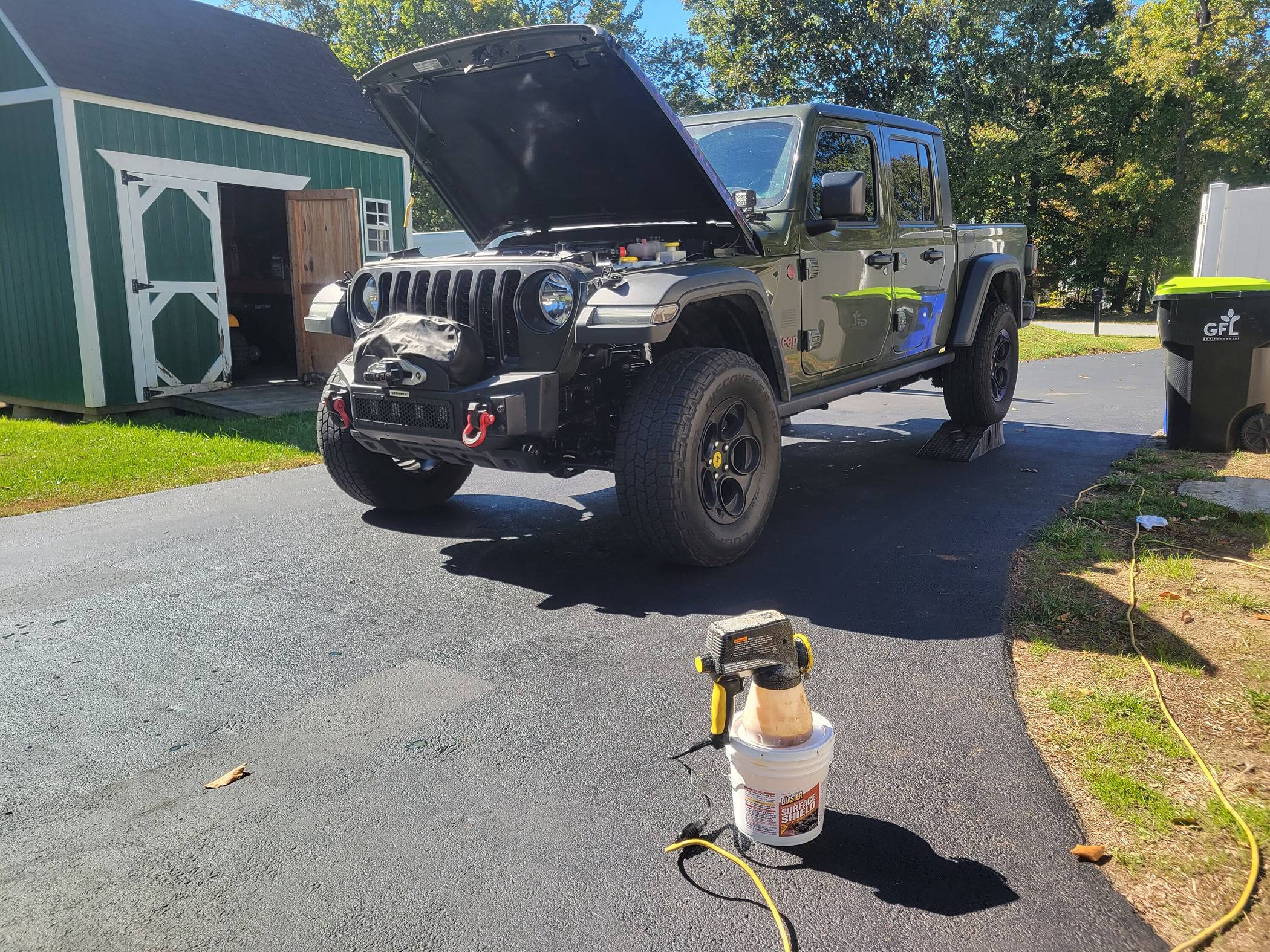

Started out doing Fluid Film, Woolwax and am now a Surface Shield convert.
I would say it is worth the money to invest in the professional spray kit with the wands. You can also use a electric paint sprayer.
Just keep in mind that any future suspension and underneath work. you are going to get grimy.
Jeep Gladiator Anyone DIY Woolwax or Fluid Film? 20231013_123715

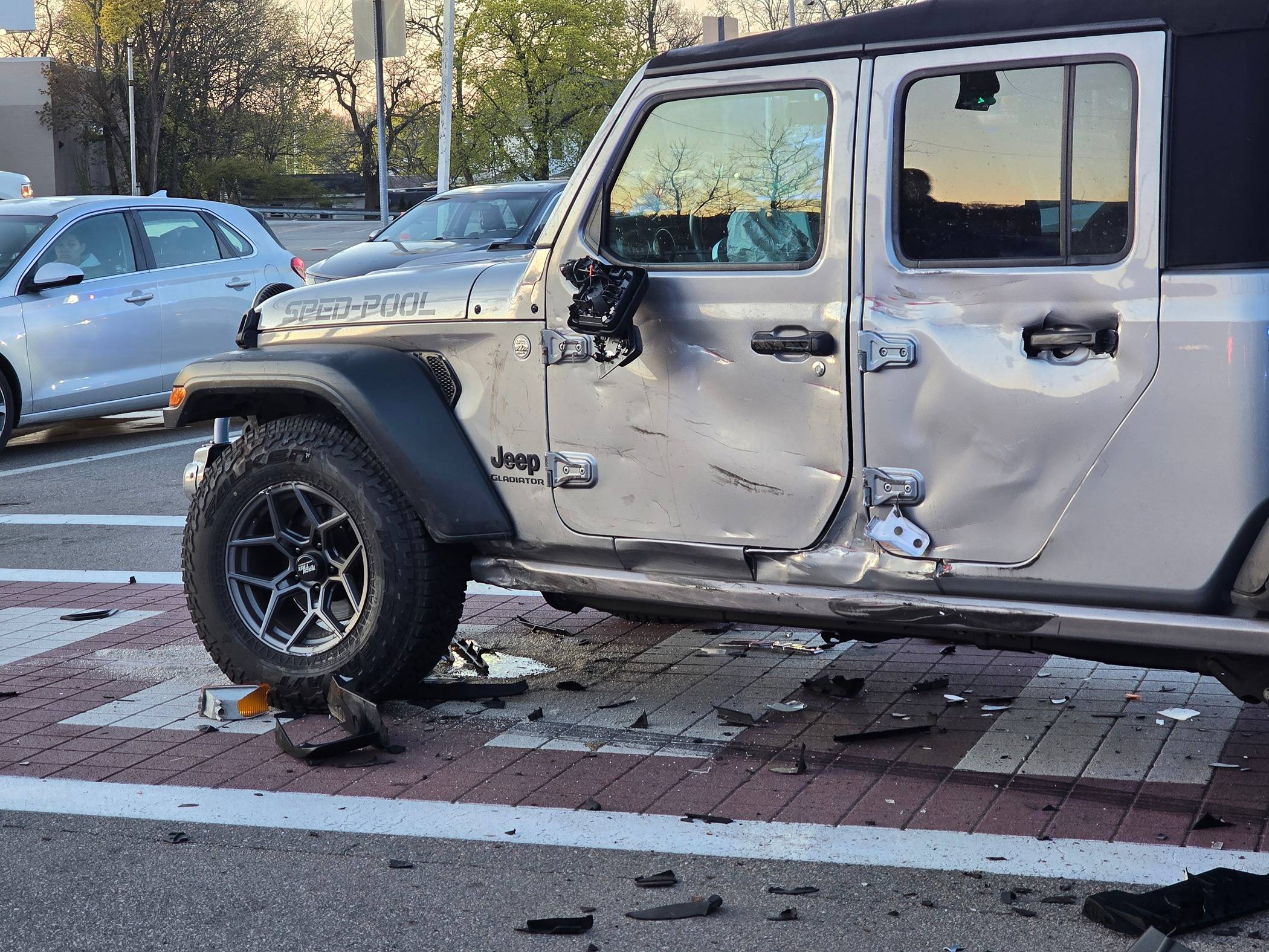

My 2020 I had rattle canned Fluid film every fall since I owned it. Sprayed inside and out of the frame with it. My frame was immaculate with no surface rust after 4 years. Did not matter to the GMC 3500 van that knocked the frame rail into the engine ruining it!
Jeep Gladiator Anyone DIY Woolwax or Fluid Film? weep1
