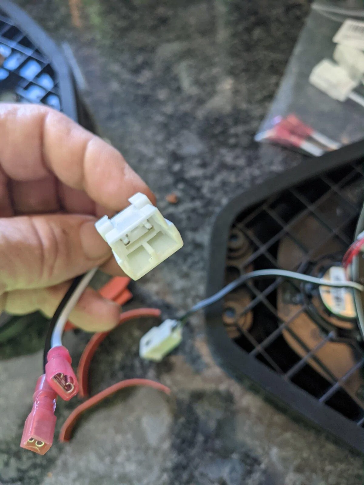

Update to the thread.....
Had to order these off of Amazon...
Jeep Gladiator Anyone done the Alpine speaker upgrade for the sound bar?? PXL_20210925_182057446
Then swap the pins so black would plug into black and so on.....
Trimmed the first one with the Dremel and a diamond cut off wheel, not too messy but needed to finish with the utility knife. On the second one I just used the utility knife, went thru 3 blades and took about an extra 10 minutes..... Overall pleased but far from what I would consider "Plug and Play"....
