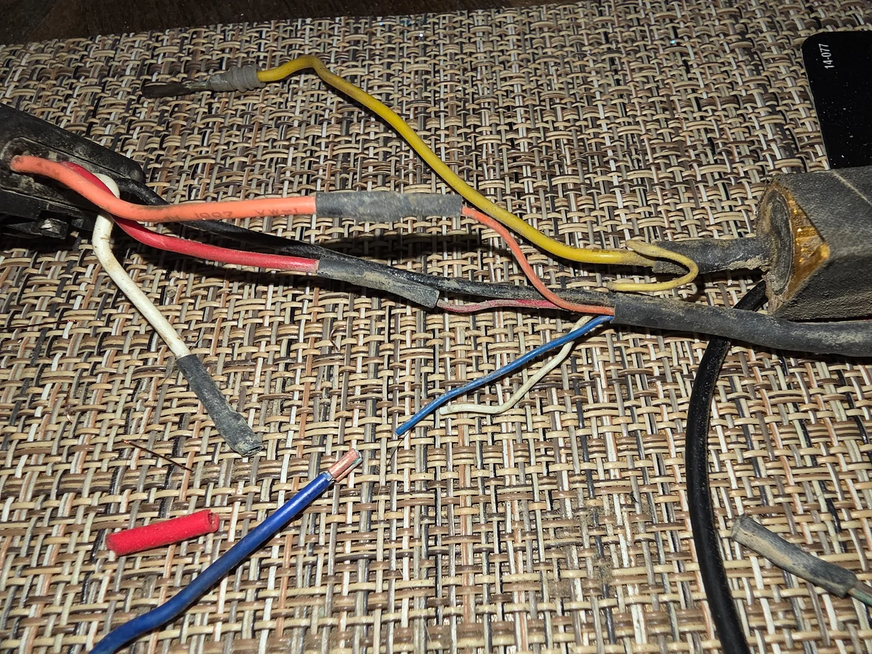

Well, It broke again, so I took the light off the truck and pulled the harness apart. I have to say, this is probly the lamest wiring I've ever seen. They changed gauge size right after the pigtail and then the heat shrink tubing isn't even fully tightened down. (Look real close in the pics) The blue wire and white wires were completely separated. They are crimped together (you can see the green corrosion on the blue wire where I peeled the heat shrink off).
This is really frustrating. There have to be better ways to do a wire gauge change. And on a $400+ set of lights to boot. I sent the photo off to AAL, lets see what they say. These were installed in September. Driver's side is still working but I'm going to have to pull that apart as well, just to ensure it doesn't go bad as well.

As far as stepping down gauges, theres better options vs just crimping like they did, but it's not uncommon to do it that way and if done right it wouldn't be an issue. If they would have used a better quality heat shrink with glue then it would have been plenty good, but the poor heat shrink allowed the smaller wire to flex too much at the crimp and it caused it to break.
It sucks seeing things like this. I get it, they want to make it as cost effective and easy on their end, but I expect a quality product regardless the price point.
The heat shrink is definitely what what let them down. Didn't even fully shrink down to seal the smaller wire. Once it warms up, I'm going to pull both lights off and rewire these. And since I've got a tazer and can set the truck to LED, I'm going to see if I can eliminate that annoying heat sink too
