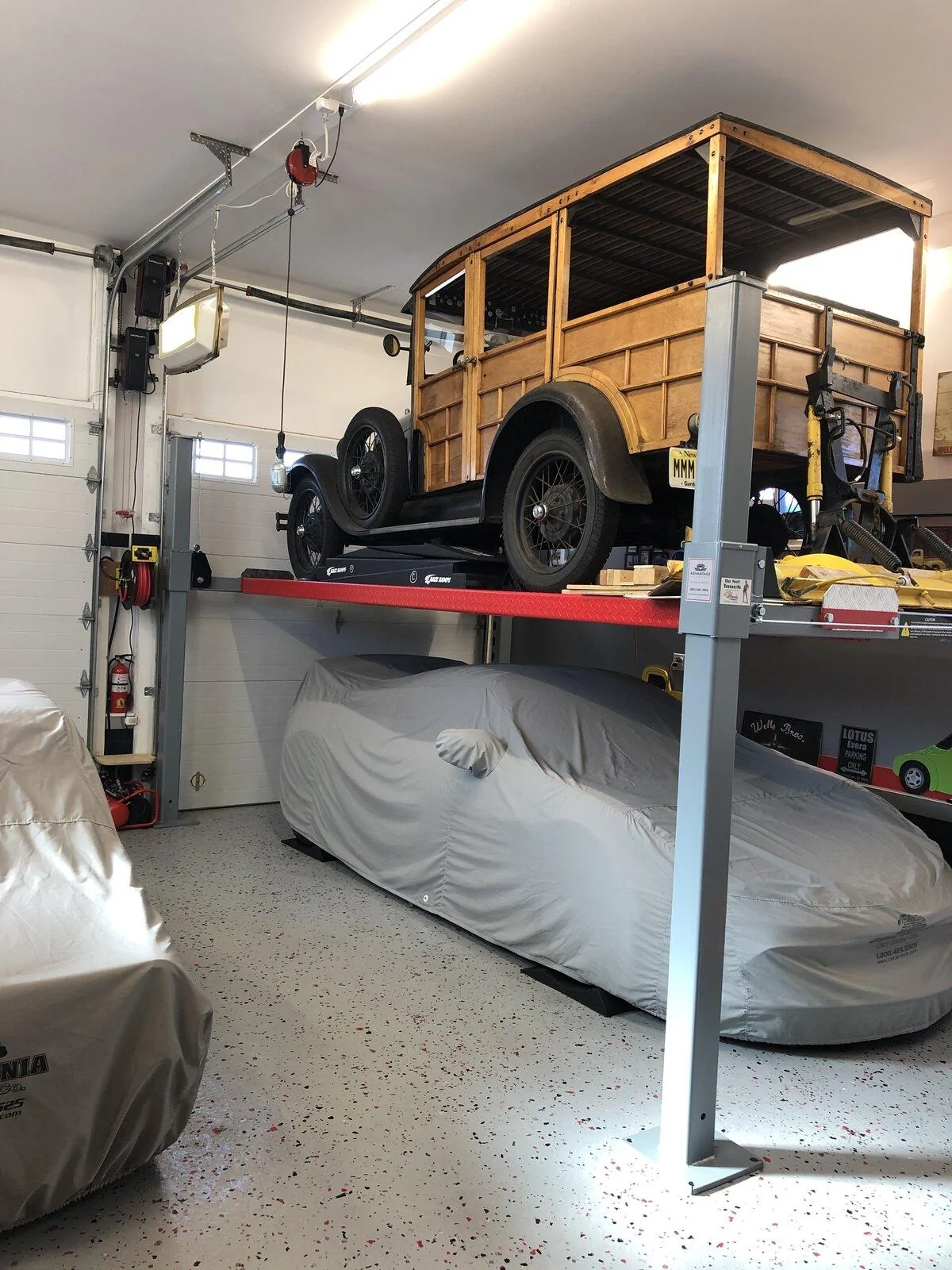

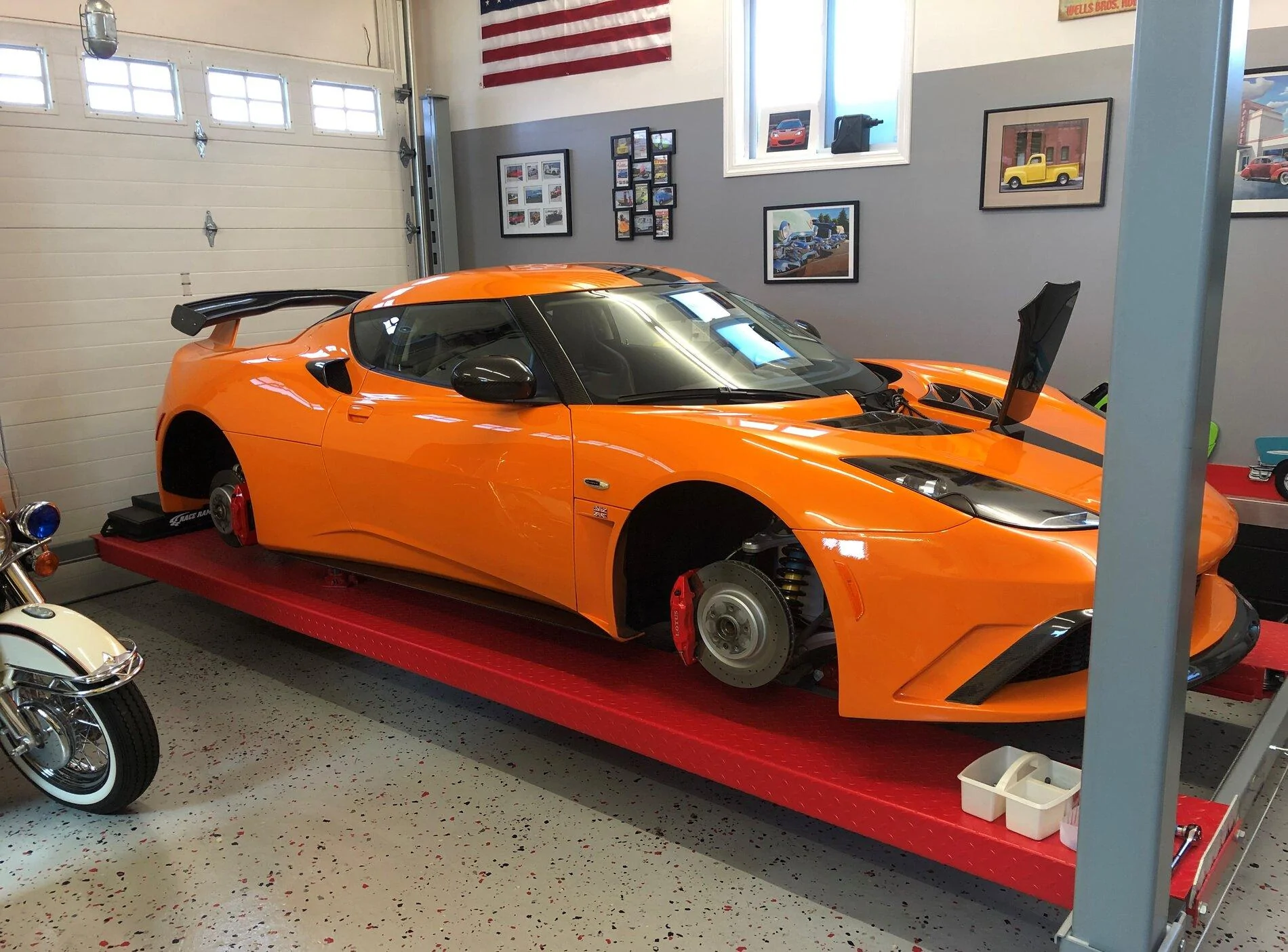

Cool garages, I don’t really think those type of lifts are as useful as a two post as you cannot rotate tires or do brakes, two pretty common things I do.
My lift has two hydraulic jacks built into it on rollers. I can roll them forward or back and lift the entire vehicle off the lift for tire rotations and brake jobs. One of the greatest things about the four post lifts is they don’t have to be bolted down, in fact mine came with “casters” that I can pin on, lower the lift all the way and move it anywhere in the garage I want it. IMO the four post lifts are way more functional, and way safer than the two post lifts.
Exactly. Well put! For my home use the 2 poster with the jacks has been the best of both worlds, and I do move it around quite a bit because I constantly change the garage layout.

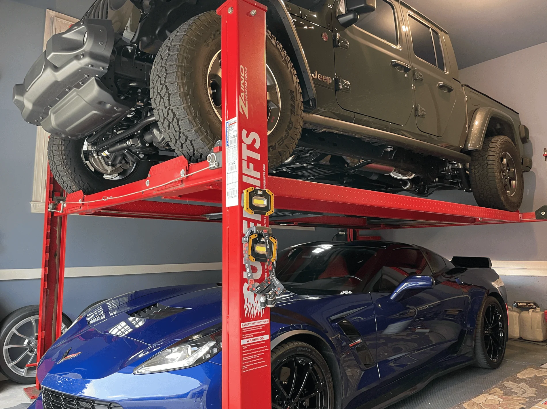

Remembered to grab a photo of the Jeep under our lift. Has plenty of clearance should I decide to get a lift/bigger tires on it down the road. Photobombed by our pup.
Perfect. Exactly what I was looking to see. THANKS!
Ordering one, and will put the other lift in the smaller garage. Will look great with a golf cart on top! haha

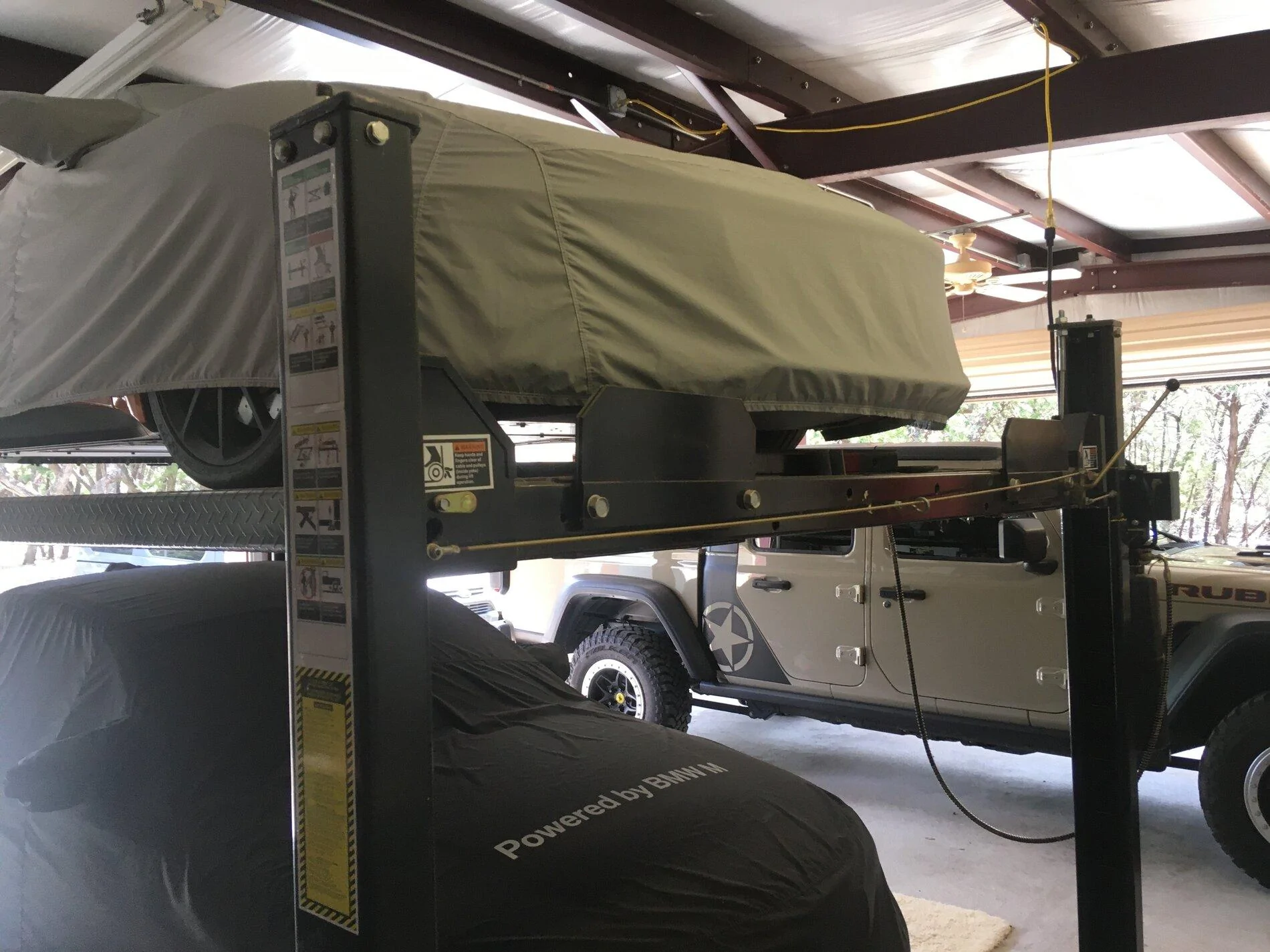

ctimrun
Dec 27, 2019
SoCal
Jeep Rubicon
Was out in the garage a little bit ago and realized the lift isn’t as high as it goes. There is another position higher that the locks will lock into so there would be even more clearance than what the picture shows, would guess another 6” higher.
Wildfire is a family owned business and seemed like very nice people. I don’t think you will be disappointed.
