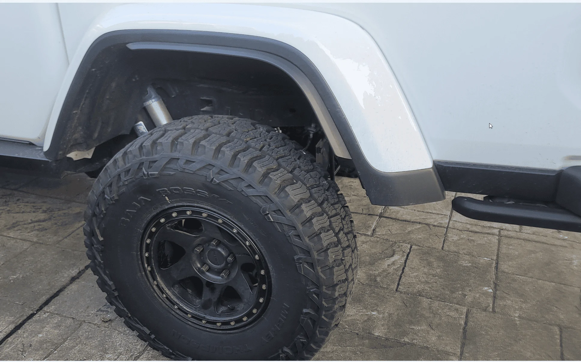

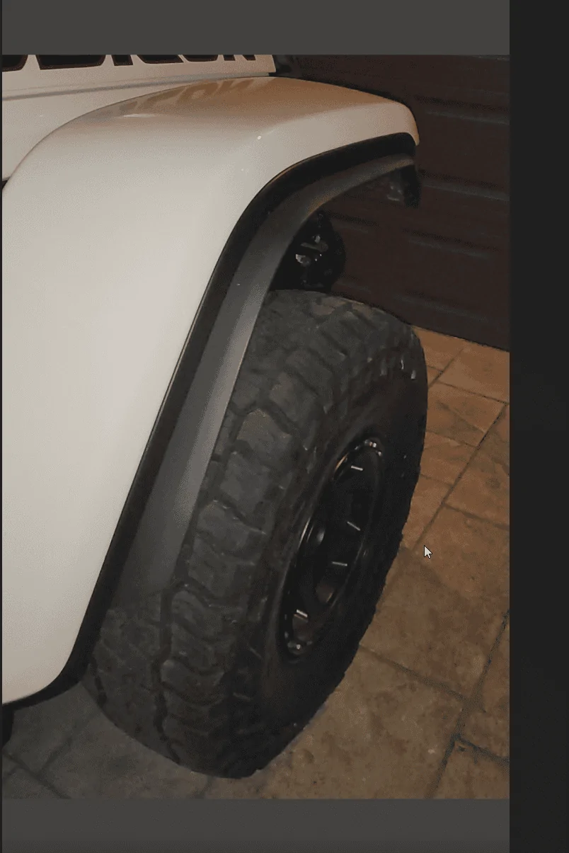

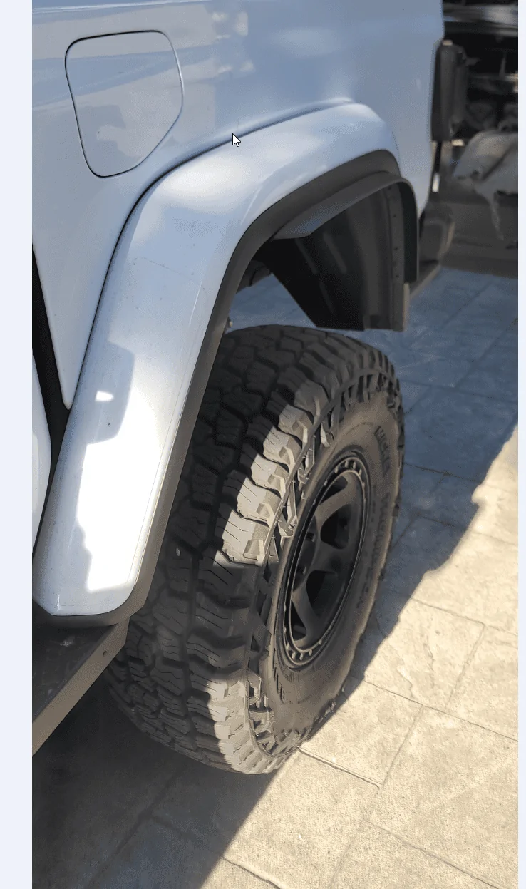

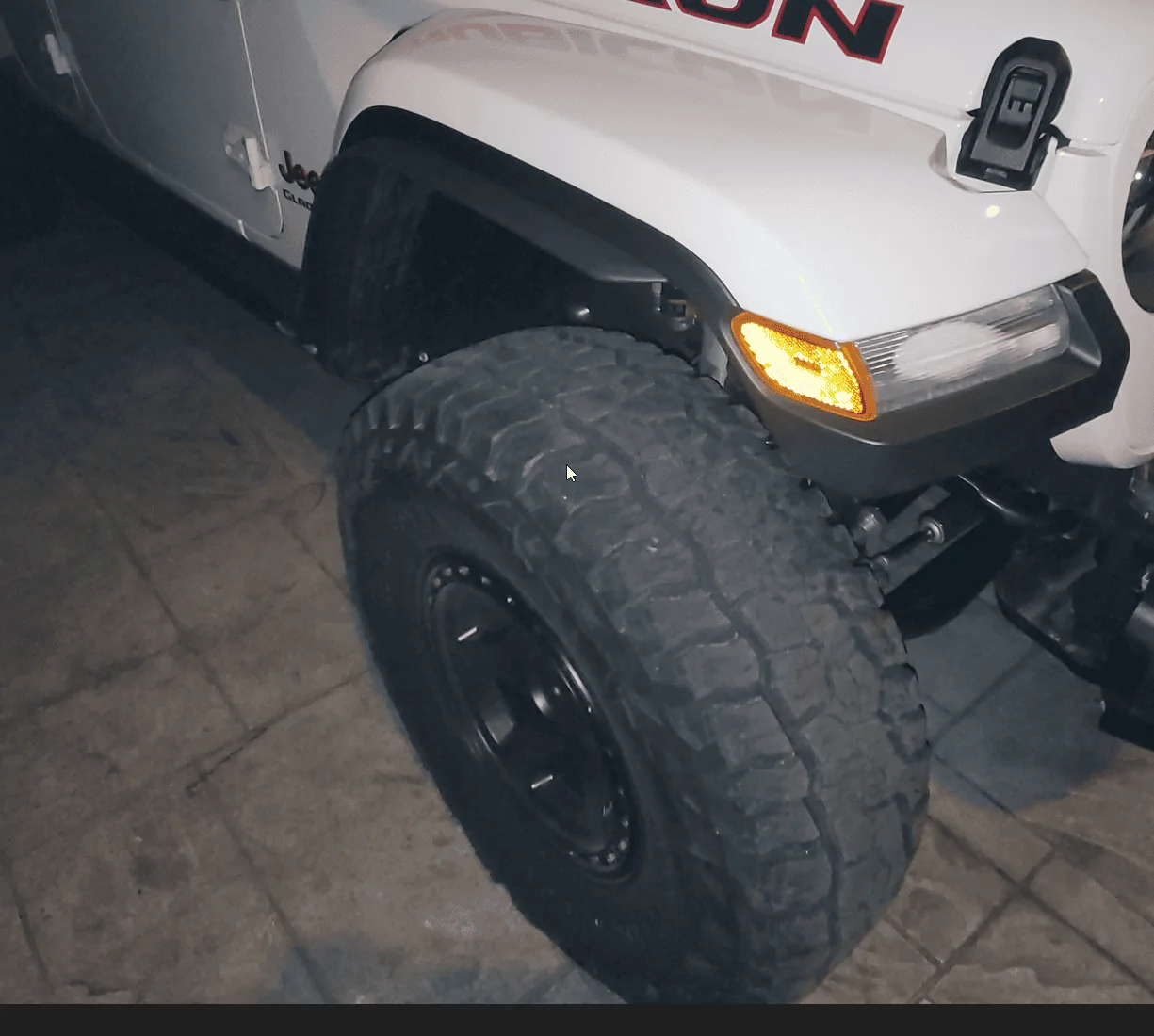

Picked the JL extensions up today from the dealer. Here are some pics of the front on my Diesel Gladiator Rubicon. I just popped the center of the plastic rivets out with a small screw driver and then used the older style christmas tree plugs to reattach the new extensions for now (shall see how they hold).
I will see about fitting the rears tomorrow. They could probably be put on just by drilling a few holes in the extension since the holes don't match the fenders of the Gladiator but I need to play with the fitment to see if the rears need to be heated and bent a bit.
Anymore pics during the day? Do all the holes like up perfect for fronts?

Yup all the front holes lined up, didn't have to drill anything anbd the christmas tree plugs seem to be holding just fine ie don't need to get the plastic rivets. However I think for the rears the plastic rivets will be necessary. I didn't get to the rear install yet as I am waiting on the right side to arrive this week.

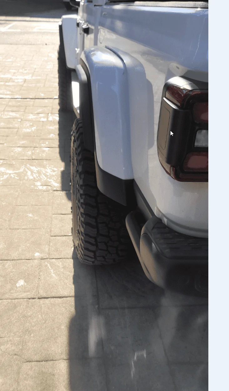

Decided to install the one rear I had. I needed to drill a few holes in the extension. Used one plastic rivet in the middle and Christmas tree plugs for the rest. Little bit of a gap in the corner. Will take a shot from the rear later, forgot.
Not ideal as they are small but easy to replace when something else becomes available.
