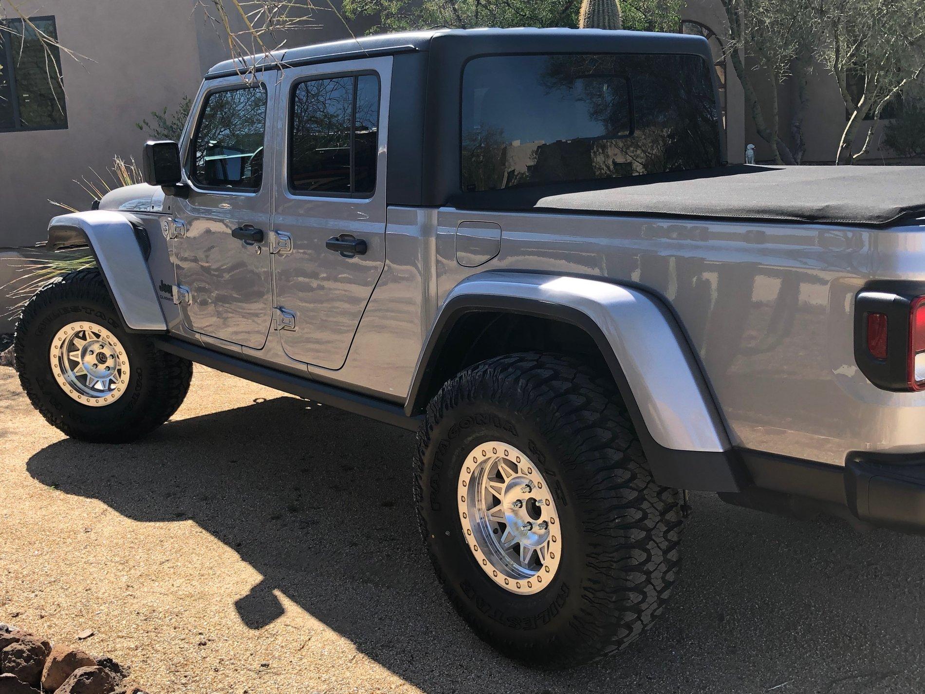

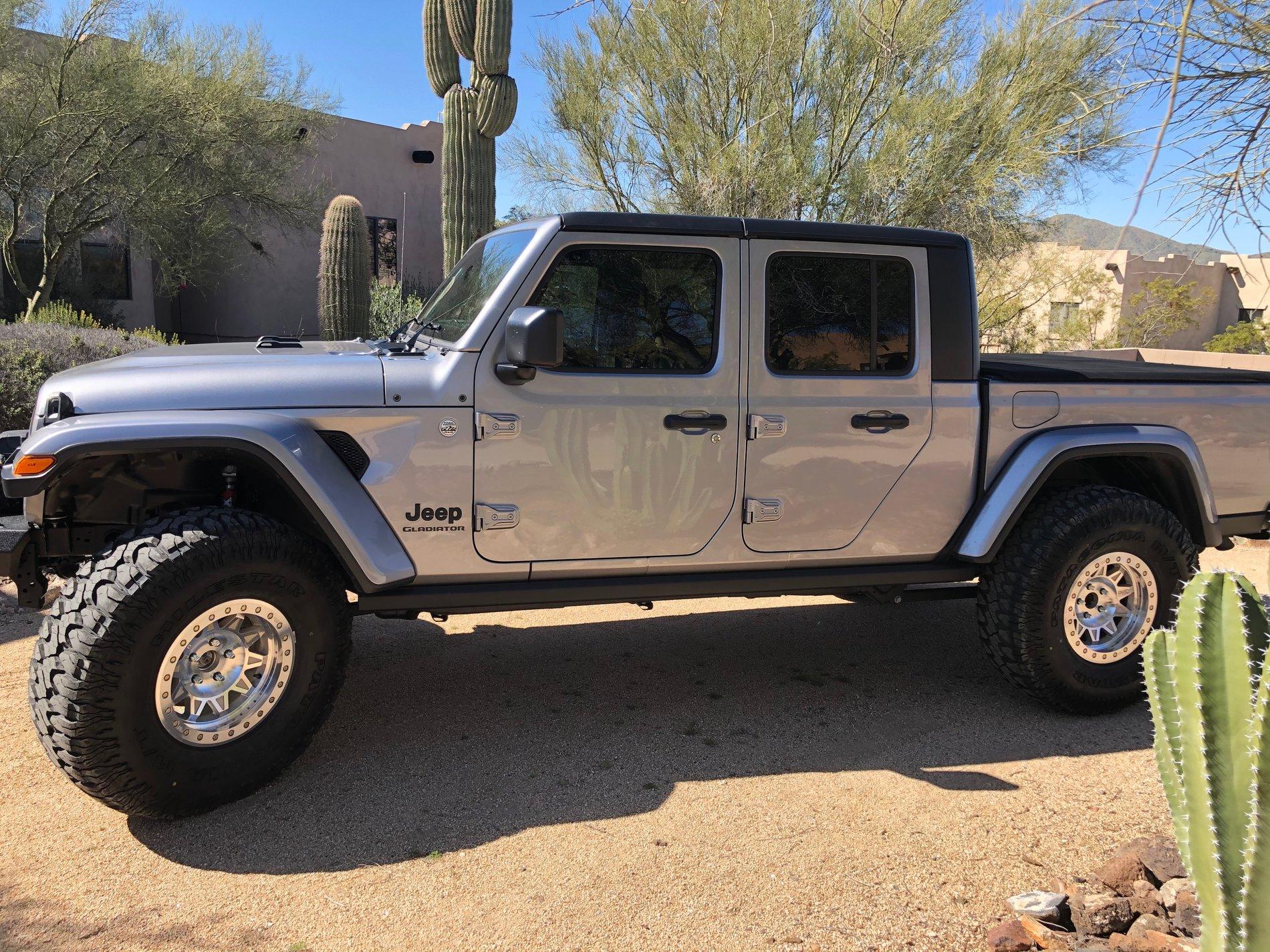

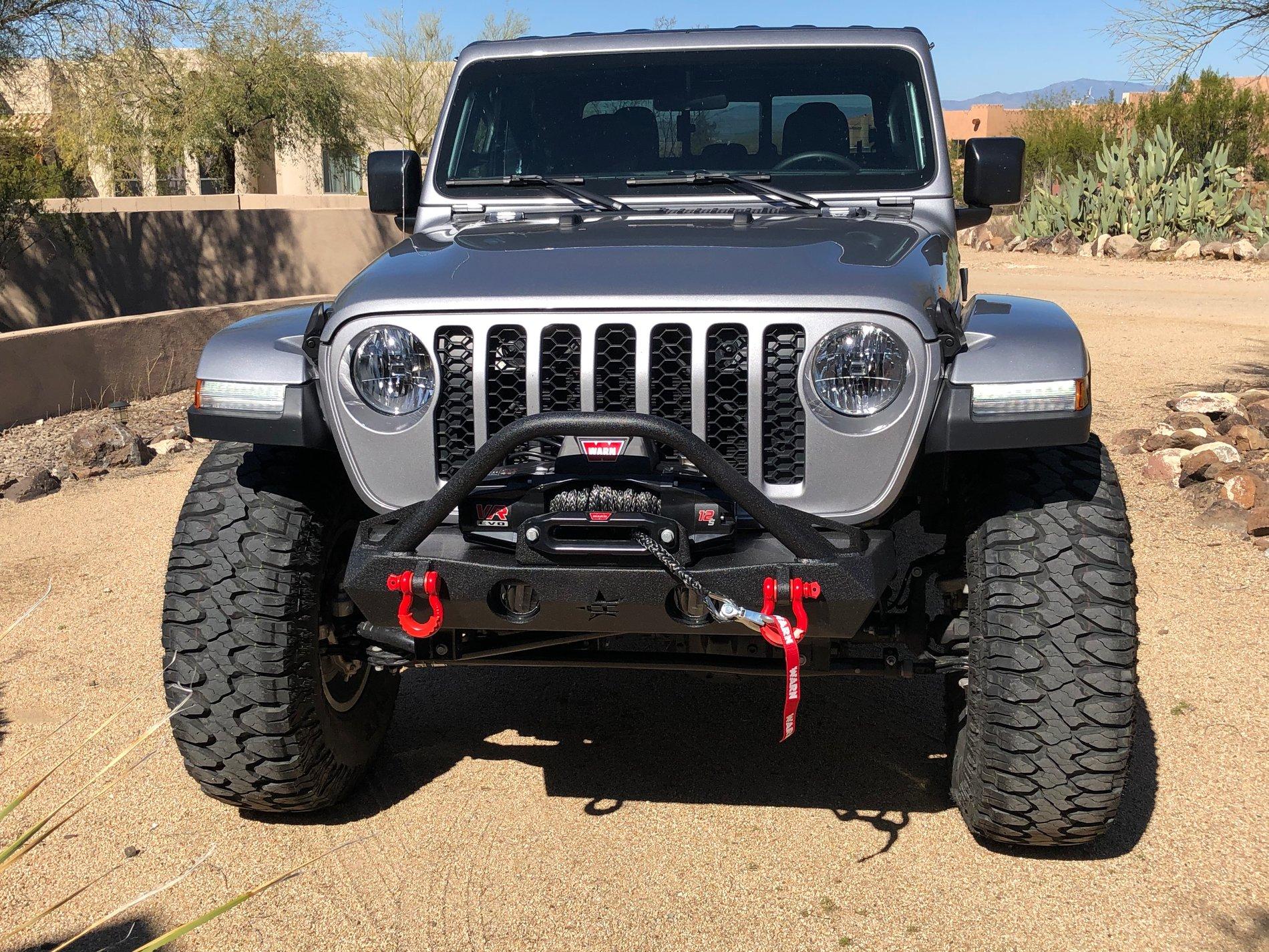

I swapped my Max Tow fenders for Rubicon fenders, it was a good upgrade for clearance. The Rubicon fenders had the LED DRLs and signals and it just took a program change to operate them.
No, the Tazer programmer allows you to select this. I also have the LED Fog Lamps and last week added the LED Headlights, all programmed with the Tazer.
