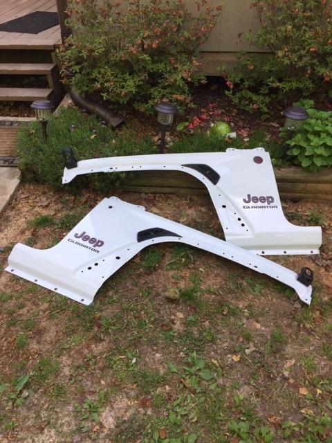

That's a pic of the actual fenders, not flares.So anyone else upgrade the flares? Will the Rubis fit on a sport s max tow or will the flare panels be different?
any updates on the liners? I have a chance to buy a set of flares with no lights and no liners, will I be able to make them work?
Pic is of the flare panels that makes me think they differ from sport max tow
Did your stock inner fenders work with these?I swapped my Max Tow fenders for Rubicon fenders, it was a good upgrade for clearance. The Rubicon fenders had the LED DRLs and signals and it just took a program change to operate them.
No, they are different. As are the mounting brackets for halogen and led dlr/signals. So if you have halogen dlr/signal lights but got the fenders that are for the factory led ones, you wont be able to properly mount the fender flares.Did your stock inner fenders work with these?
So if the ones I found are halogen then they should work is what your saying?No, they are different. As are the mounting brackets for halogen and led dlr/signals. So if you have halogen dlr/signal lights but got the fenders that are for the factory led ones, you wont be able to properly mount the fender flares.
