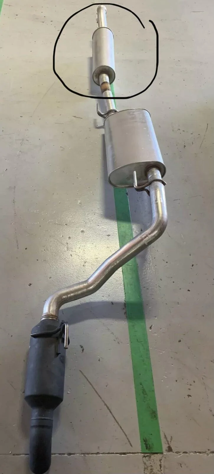

I'm guessing the resonator has more to do with eliminating drone noise at certain RPMs than reducing the exhaust noise level. Does anyone know for sure? I removed the resonator from a Ram and didn't notice any difference at all (idling in the driveway), so I put it back on.

I cut out the muffler on mine and just replaced that area with 2.5" pipe. It has a nice growl when I get on the accelerator and just a little bit of drone at highway speed but nothing too awful.

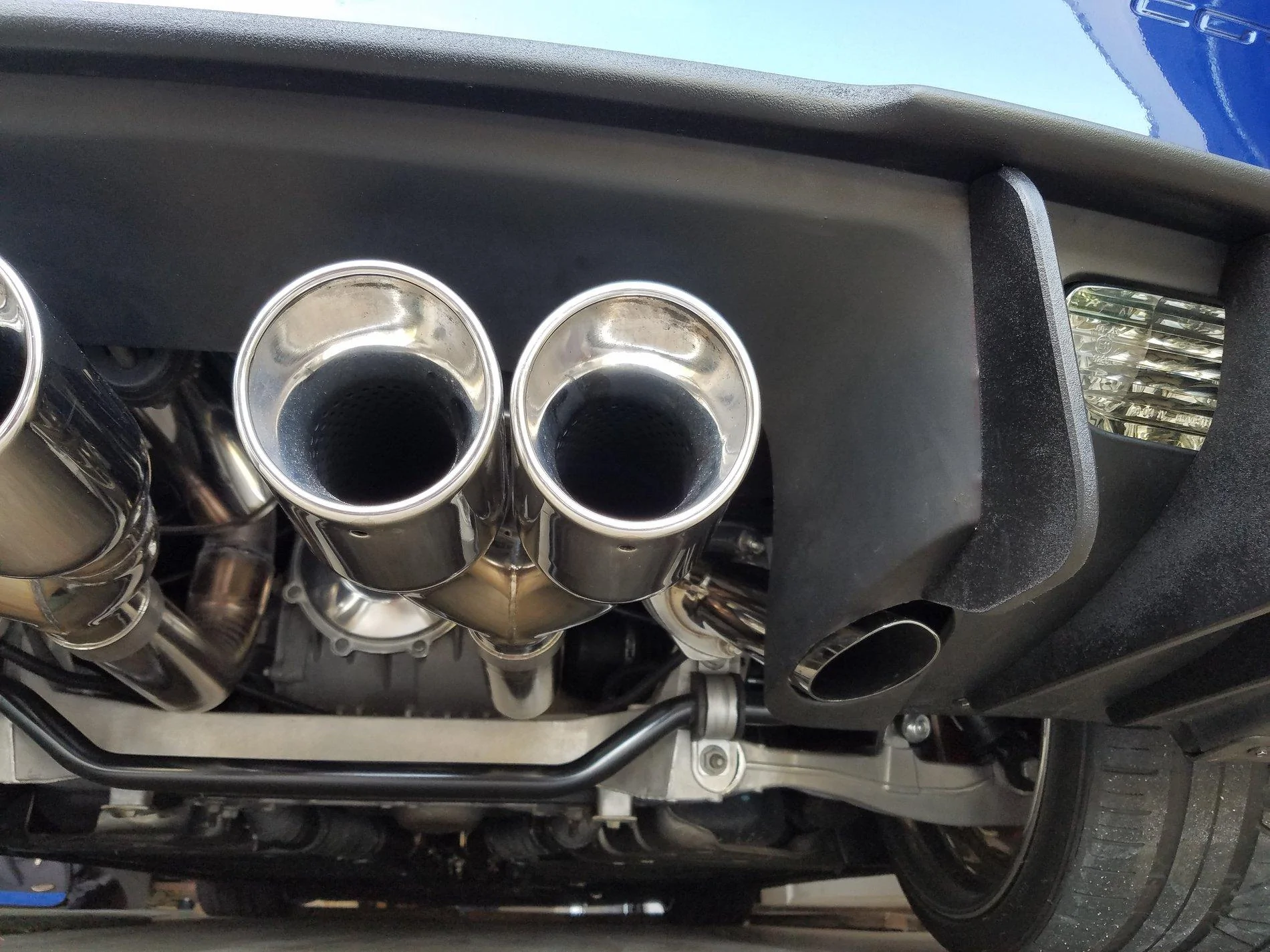

I'm thinking about doing an exhaust cutouts and can then do mild to wild like on my 05 Vette.

So today I got home from work and did exactly what street speed 717 did in the video. I cut out my exhaust, starting just in front of the first resonator/muffler, as close to the resonator/muffler as I could, cut the back resonator/down tip off, removed everything and then used a 2 1/2” coupling to attach the down tip to the pipe just after the cats. I was having trouble getting the coupling on the exhaust pipe itself (the down tip fit well) so I ran it to a local guy down the street and he welded the other side of the coupling to the pipe. To be honest I’ve seen better weld jobs but for 60$ they added a “custom” hanger and in their defense they were trying to fill in and fix some of the “mistakes” I had made cutting off the old exhaust. Overall I am very happy and it made a Huge difference in the sound. I love it, it’s not tooo loud or obnoxious, very comfortable at higher speeds but when you take off it’s noticeable!! I truly believe it’s a much better option then any of the 600-1300$ aftermarket exhausts I was considering. Thanks to everyone for getting this post going, it was the final research I did before making my decision.

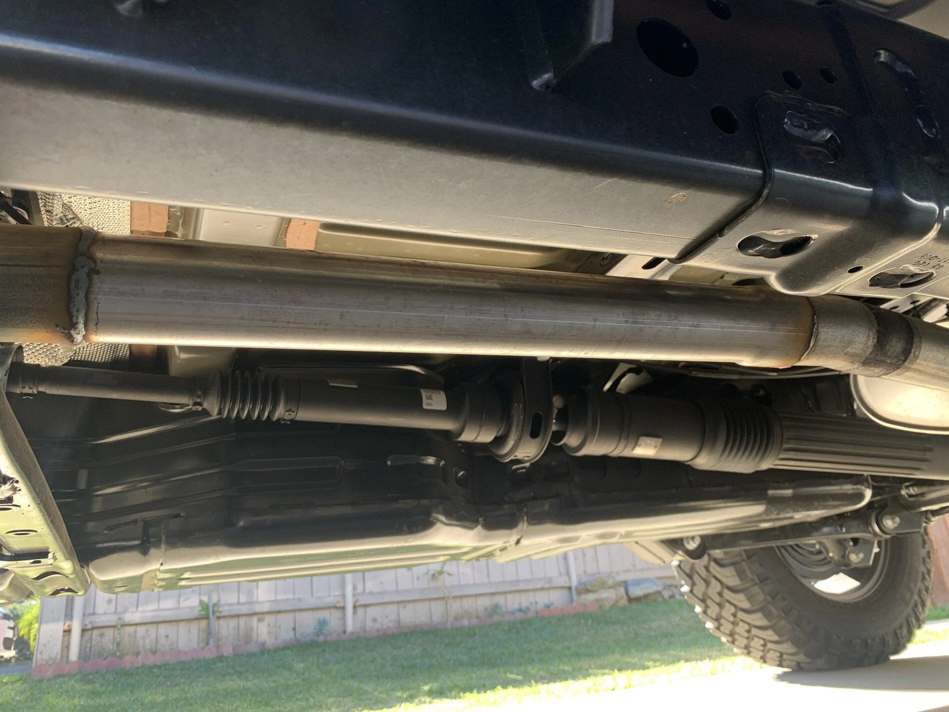

I chose to cut the very first muffler from the front and left the rest alone. It gave me a good growl. Very satisfied with it.

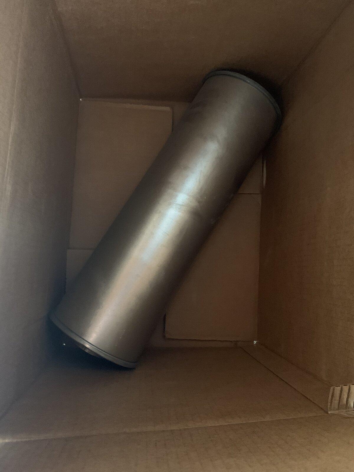

Update: Deleted the resonator today and it really didn't do much sound wise. I'll get some better pics tomorrow and hopefully a video too.
