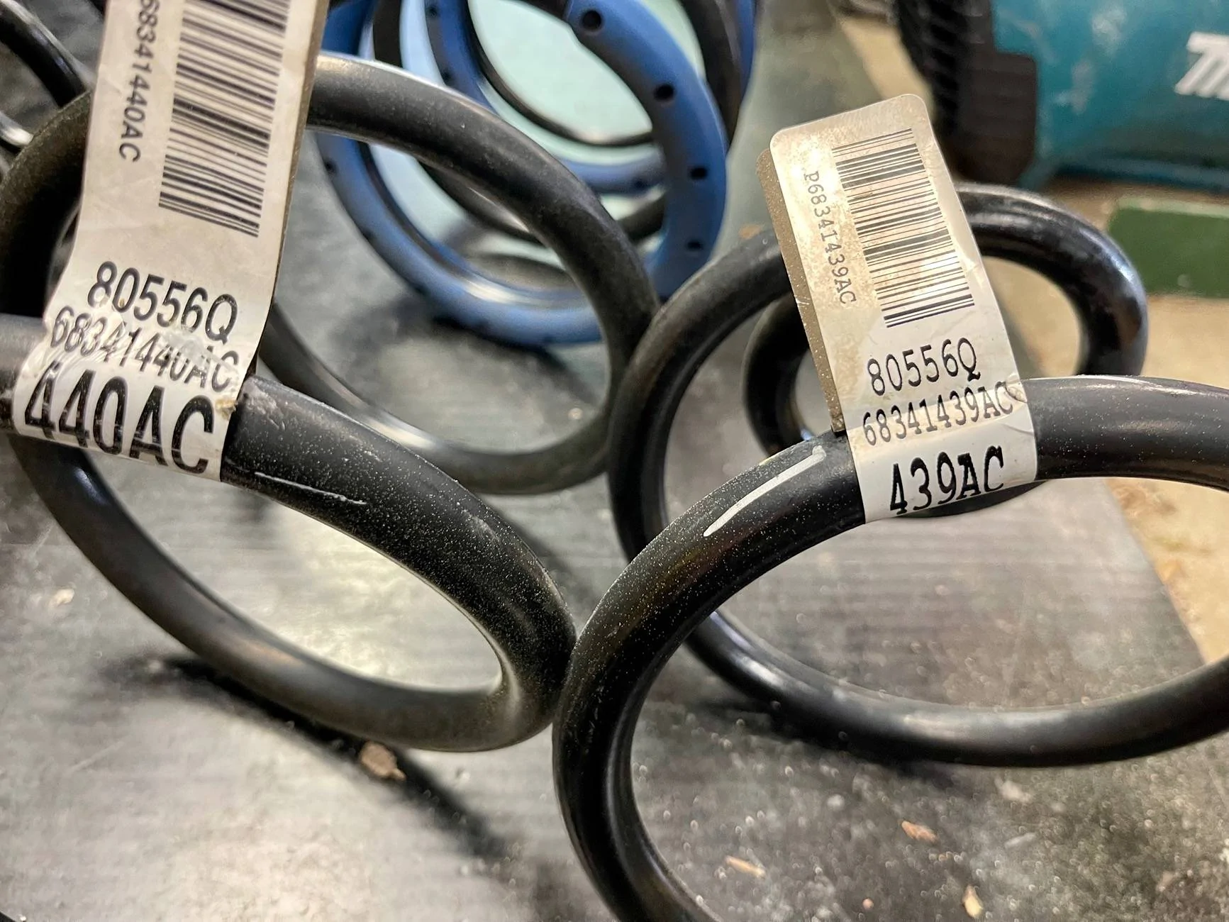

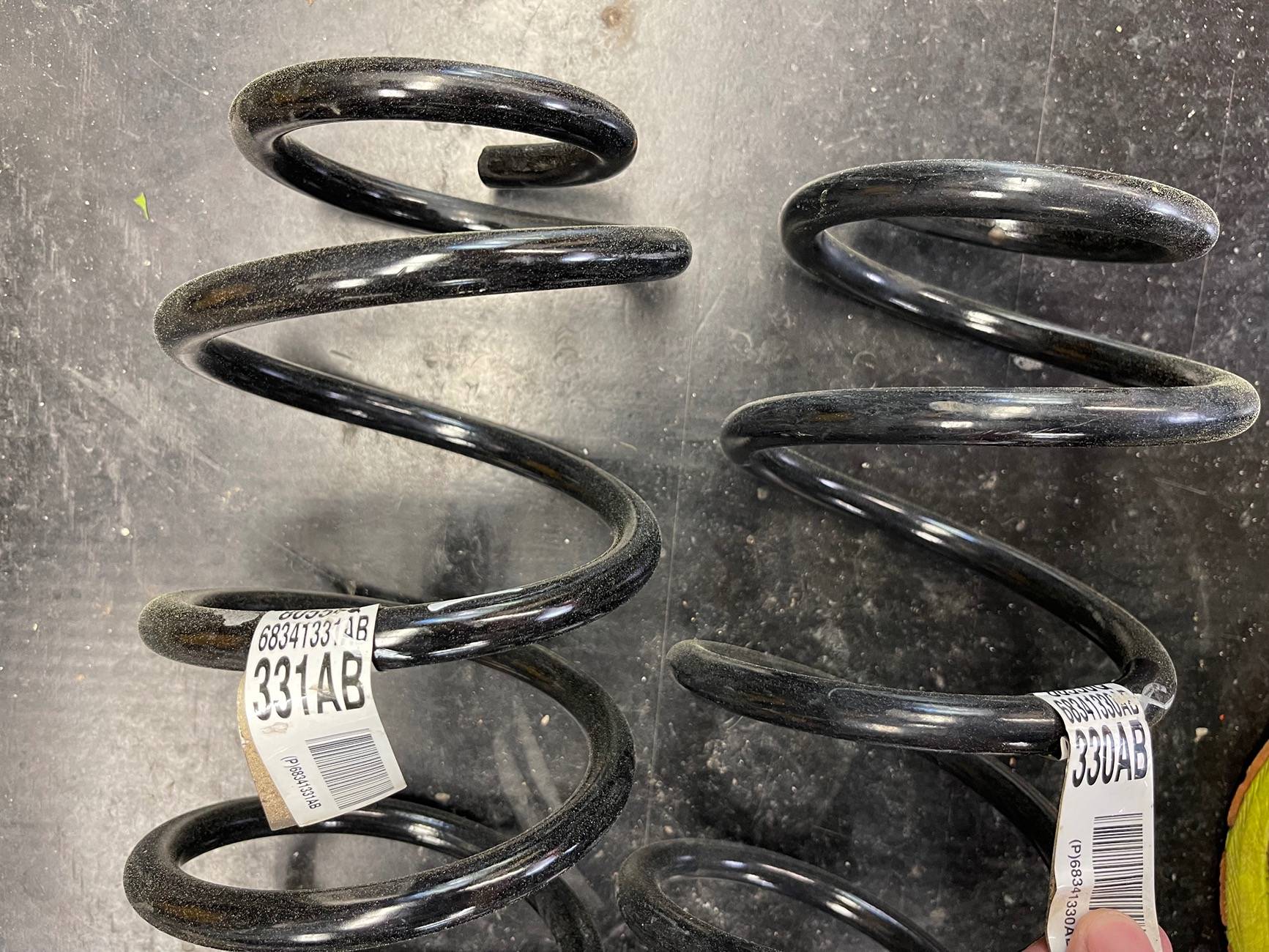

These are my Overland springs.

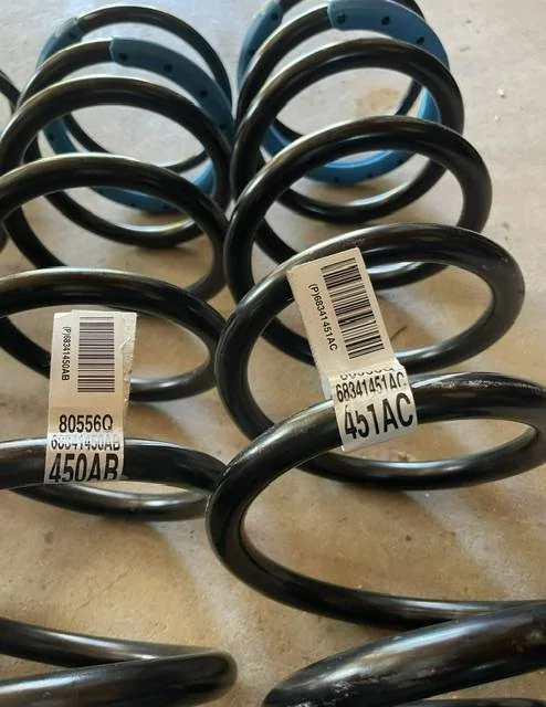

My 2020 Overland had 439 (left) and 440 (right) rears
Rubicon set I bought had 449 and 450 rears
My 2020 had 325 and 330 front springs.
Rubicon front spring pair I bought were 339 and 340.
The higher number is a higher spring rate - so the Rubicon spring rate is heavier - "stiffer".

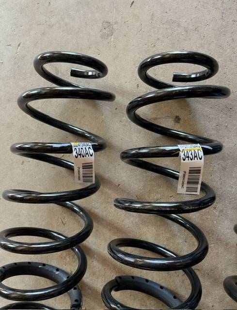

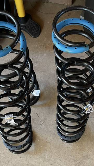

I found a pic of my LE springs with the part numbers. I wonder if the LE shocks were a different part number or if they changed something internally for cost cutting or other reasons on later Fox shocks. Not only do they work wonderfully, but they still work great after countless loads of up to 1500 lbs in the bed and many times pulling 4-6k. Allegedly, more a few times.
340/343F
450/451R
