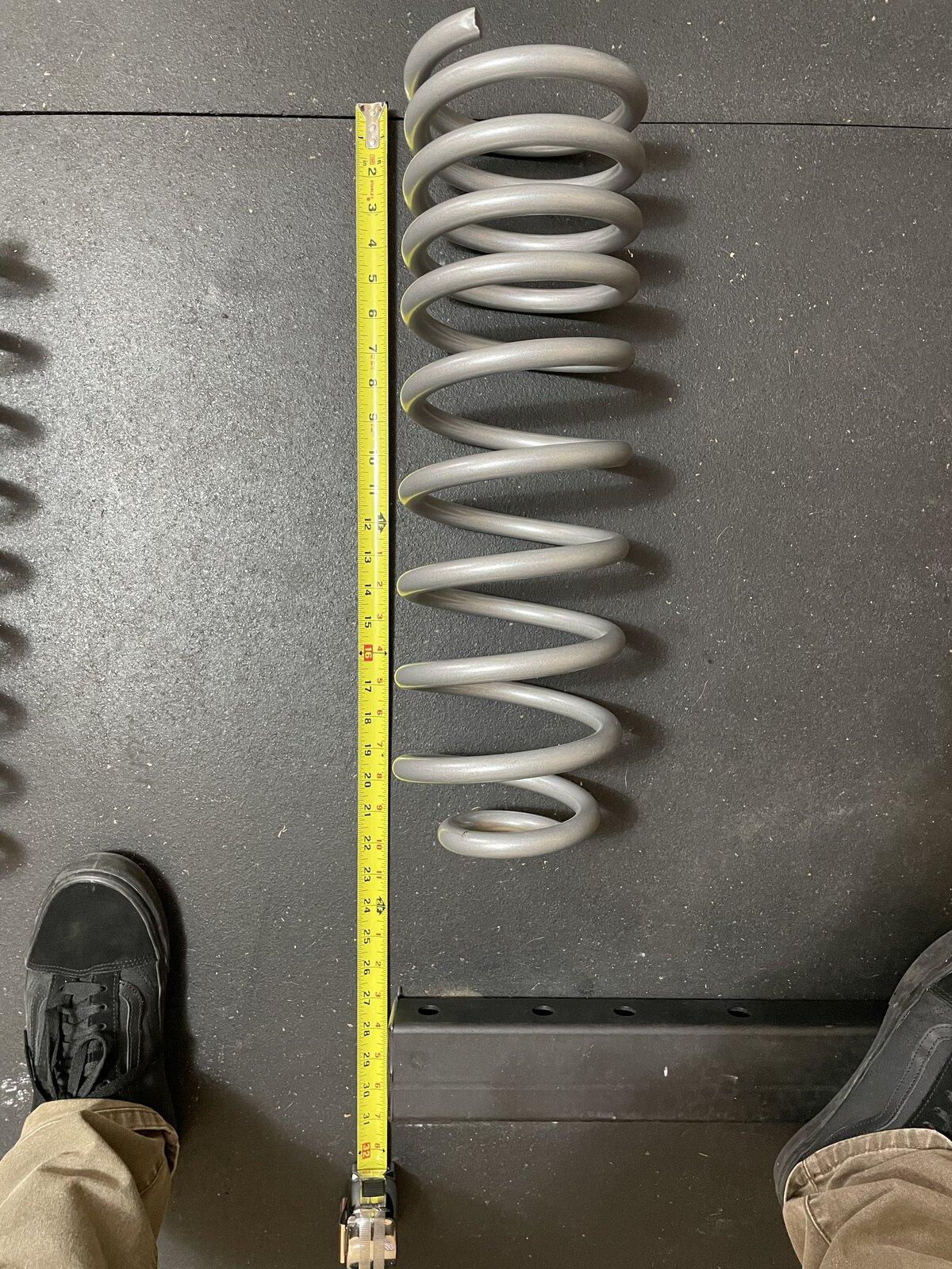

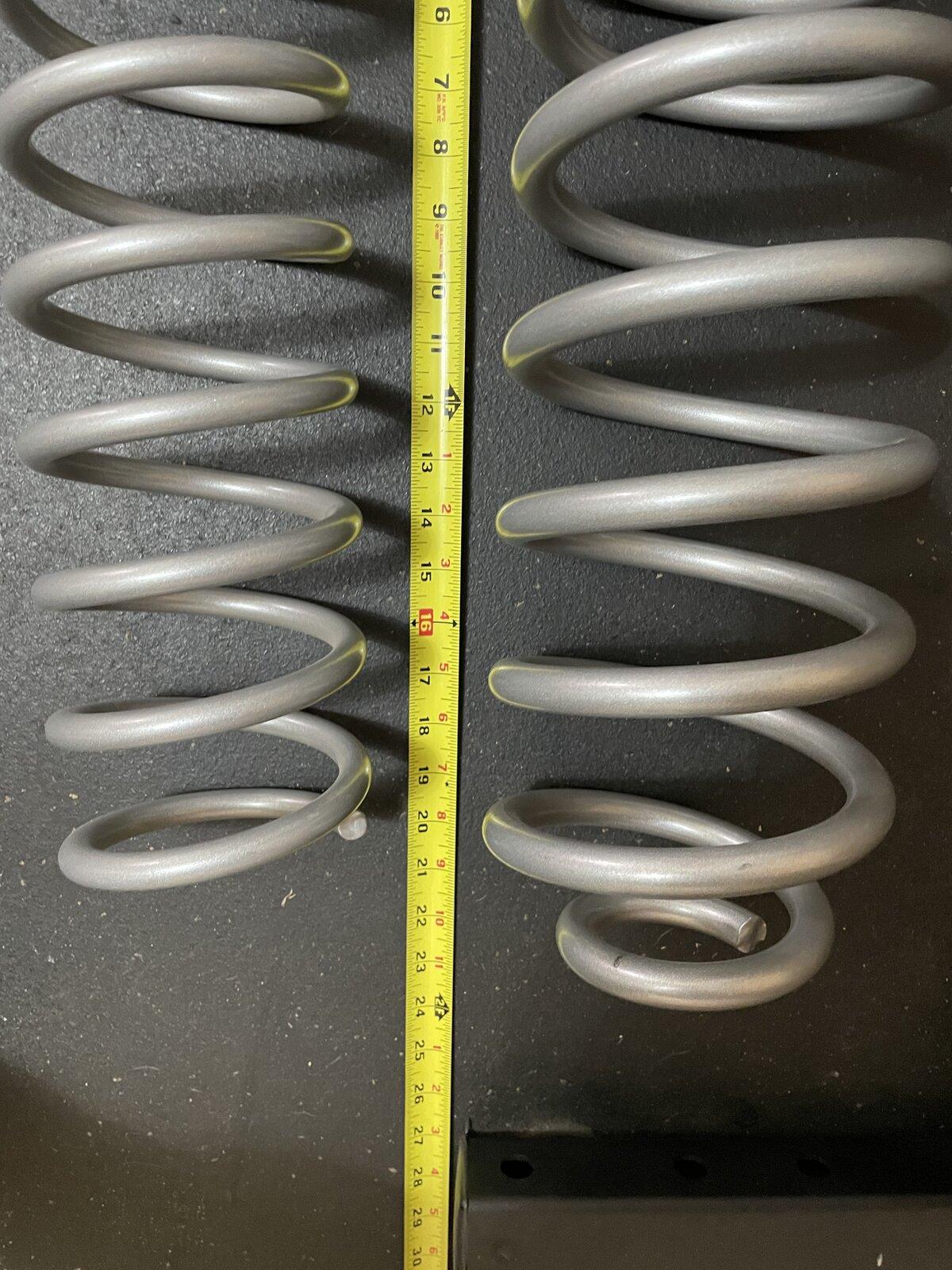

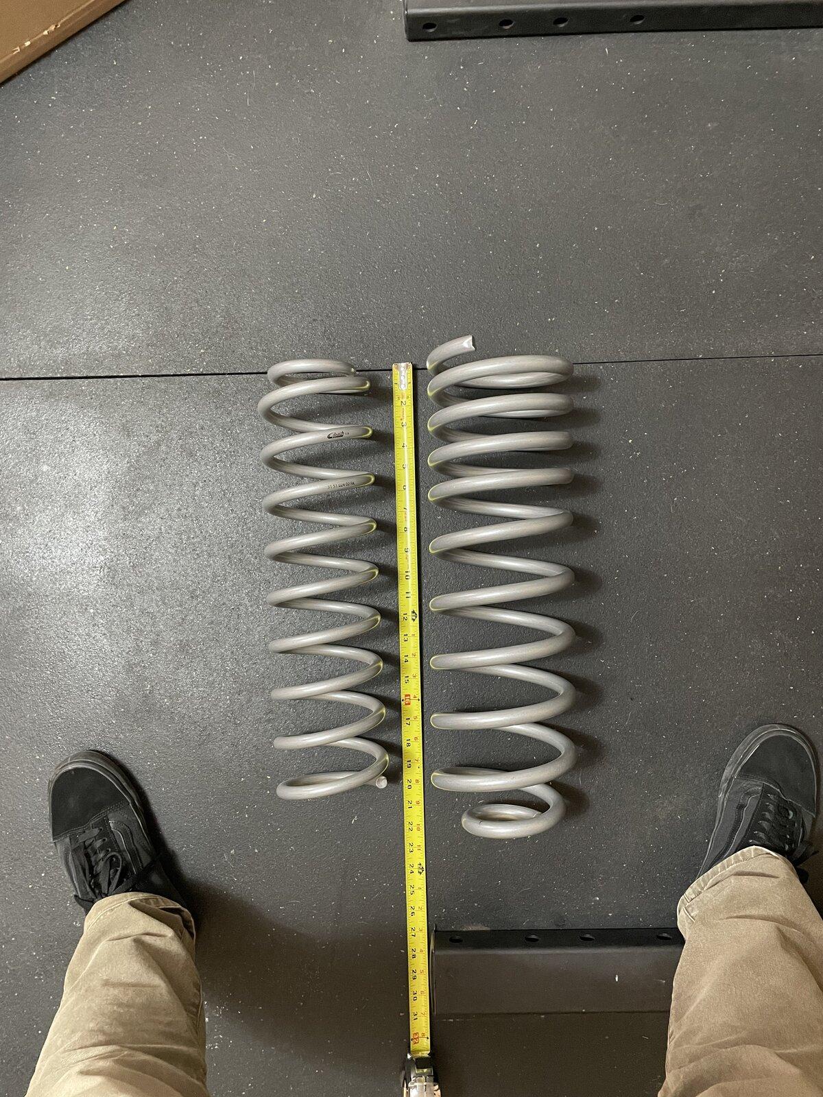

Can you get the free length of them when they come in?
Rear springs are 21.5” roughly and the fronts are about 19.75”. I don’t know what the stock rubicon springs are. I can say the rear springs are stout.

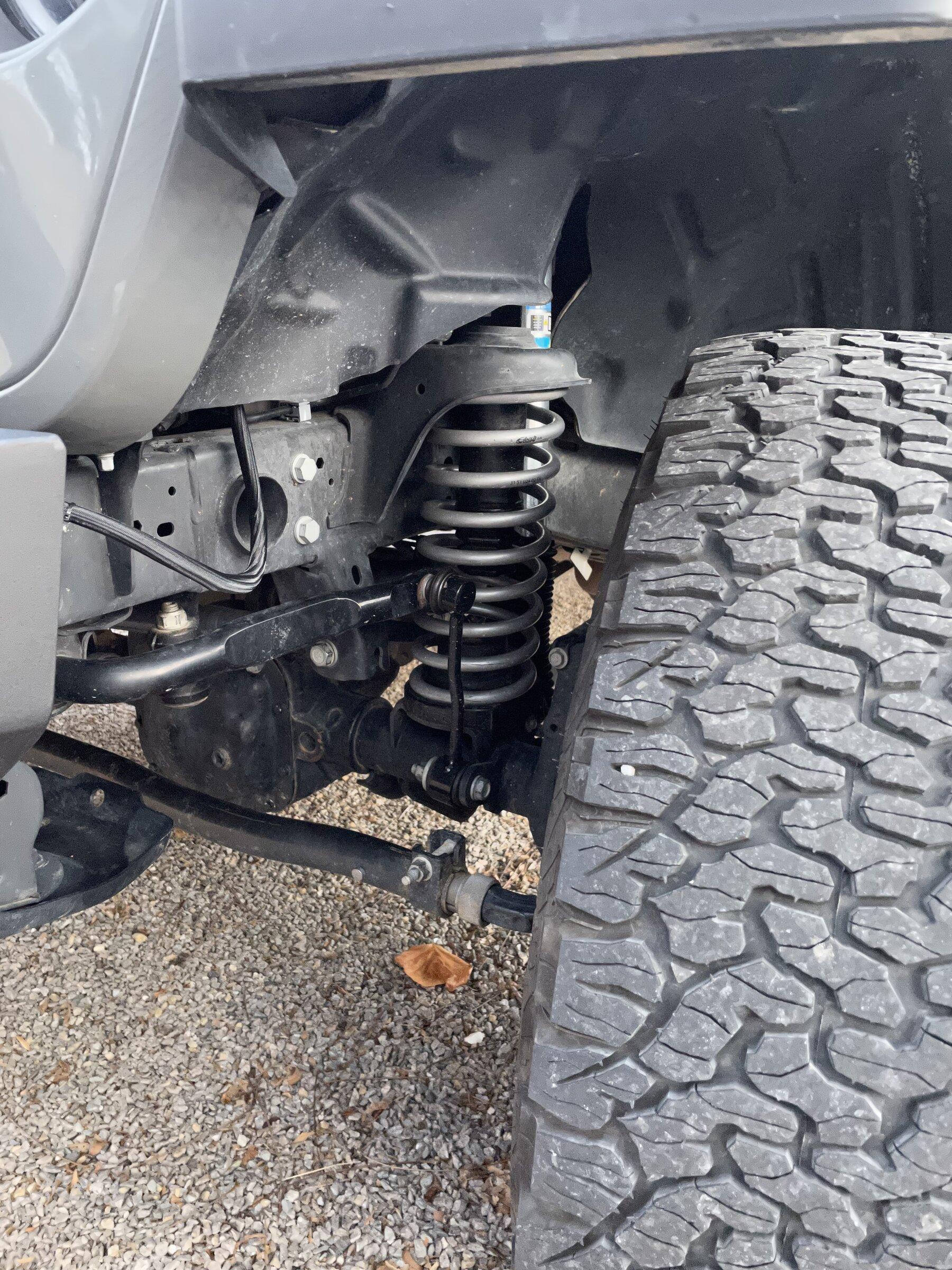

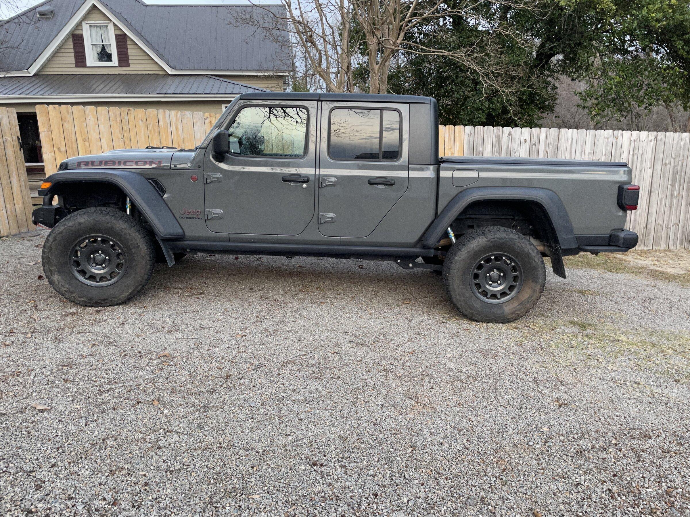

Here of some photos of the truck as it sits now. They are 2” springs and has good stance. The rear now supports tons more weight than stock before it starts sagging. The drive way is on a slope. Those are 315s amd there is plenty of room
That looks fantastic. Thanks for posting
