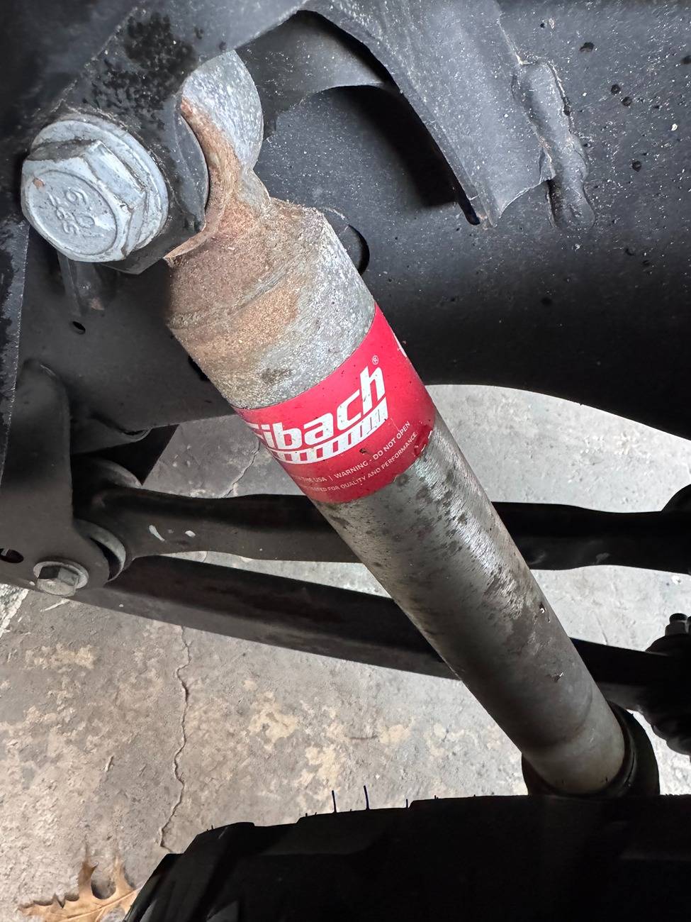

I installed the Eibach Pro-Truck shocks last spring. There is significant surface rust at the welds and calcification on all four of them. They look really bad. Curious, has anyone else had this issue?

Got any pics of this for reference?
FWIW, I have had Rancho and Bilstein shocks look like crap in a year also. No getting around a steel body shock and eventual rust forming.

All four look similar.

The bodies are stainless so this is probably going to be declared a regional conditions issue if you try to claim their lifetime warranty. They even state coating is not covered.
I've seen shock bodies like this, especially on OMEs still run their lifespan out without issue. Just monitor it, possibly coat them if you want.
I live in Washington and had no rust on mine after 2 years of use, we don't see much road salt in our area, I also always clean the underside after any snow storms out of precaution.

My jeep is garage-kept at work and home too. Not driven much, under 28K miles 2021 model, shocks probably have 6k miles on them max. Why would they look like this?
Exposure to salt and moisture as far as i understand. The salt just accelerates the corrosion process. If it's on the truck and there's moisture it just speeds up the process. Maybe residual salt on the road from winter, or being close to the ocean, high RH/humidity. Even if it's stored inside, if it got on and wasn't cleaned off it remains an accelerant. There's more to it than that, but it can happen quick. The shocks are coated, but it's not up to the same level as frame coating.
In short I've seen this a lot, brand doesn't seem to make any difference.

Yeah, I would say that is above average of what I have seen. Like mentioned, I do not think that is going to warrantied since it is cosmetic and probably will be fine for the expected remaining life of the shock.

Yup I have seen some sad looking shocks living at the shore and it had no effect on how they worked. Just like some of the jeeps I have seen around here

The only time I've actually had any issue with surface rust was while running adjustable coil overs, rust in the threads is a different issue altogether.
I would recommend occasionally popping the shaft boot off the body and making sure there's no rust starting on the shaft itself. Rust there will eventually empty that shock.

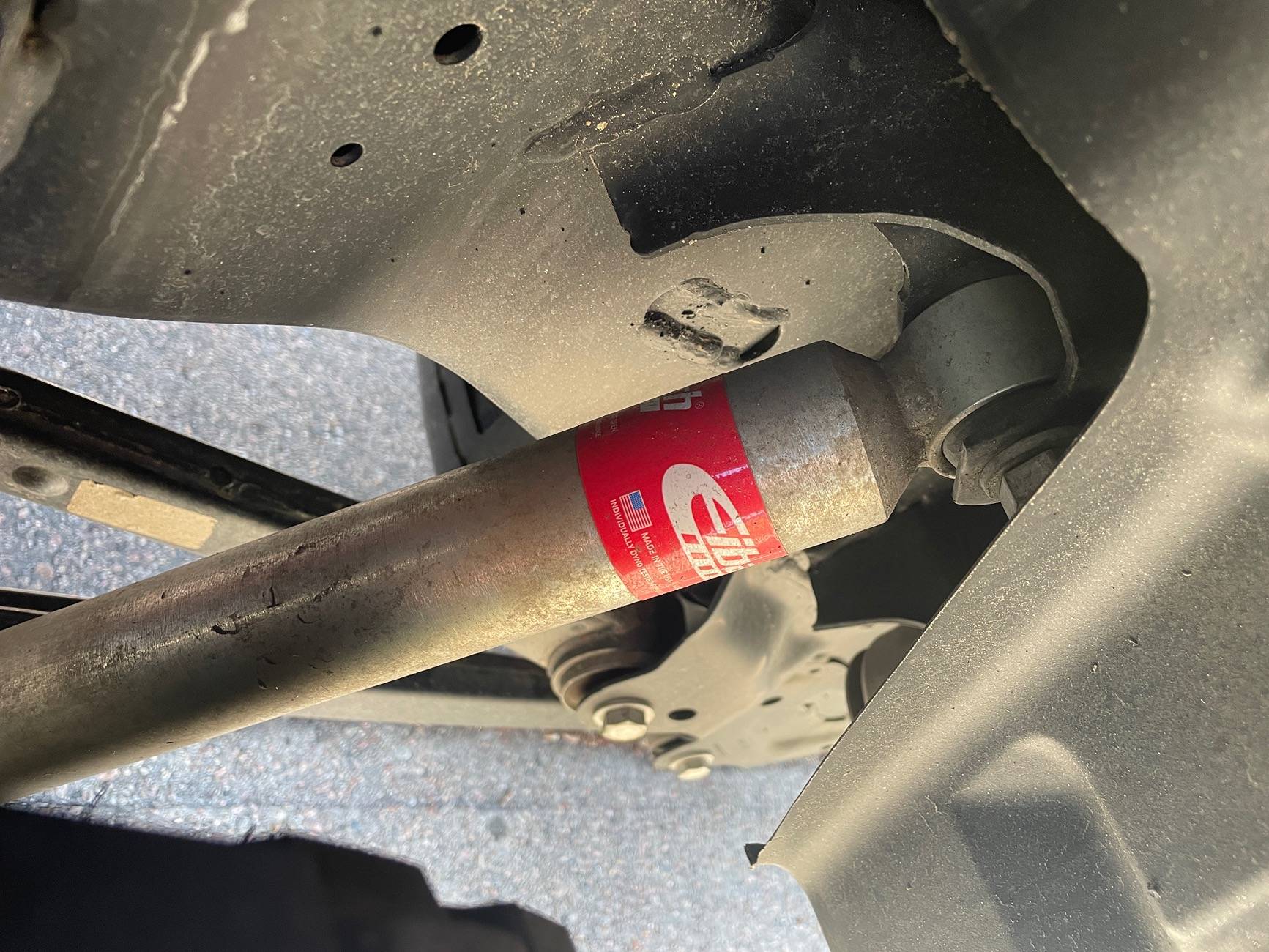

Strange, I've had mine for at least 3 years with no visible red rust. Granted, I'm in the high desert but they do see a fair share of snow and mag-chloride.

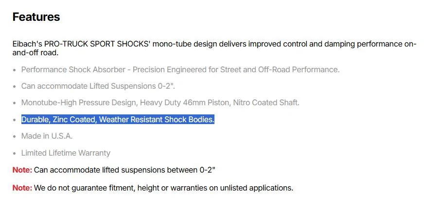

They're zinc coated, not stainless

Stainless? I don't think so based on the appearance of mine after a year or so. I left them on the truck when I traded it.
Eibach even states the appearance isn't guaranteed, almost like saying "expect problems". Weird.
That's definitely UNPASSIVATED zinc white spots (I see someone already said that)
They really aren't using a quality process on the shock bodies, IMO (I do zinc plating - that's horrible for after a very short time)
Yeah I thought as much as well, the search I ran came up with them being SS according to Shock Surplus, theyre usually pretty accurate. The coat looks the same as the Billys, zinc. Just checked and it is in fact zinc.
None the less, its definitely per app, ran them for probably 40k on a Tundra over about 2.5 years and never had that happen. Mine just looked ashy, like my Foxes do right now.

Here’s what mine are looking like after about 35K mi. Just dirty and slightly ashy, no red rust. Zinc coating is doing its job
