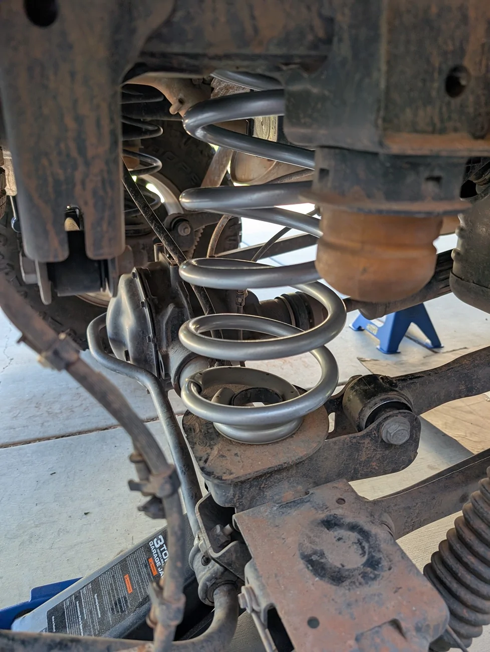

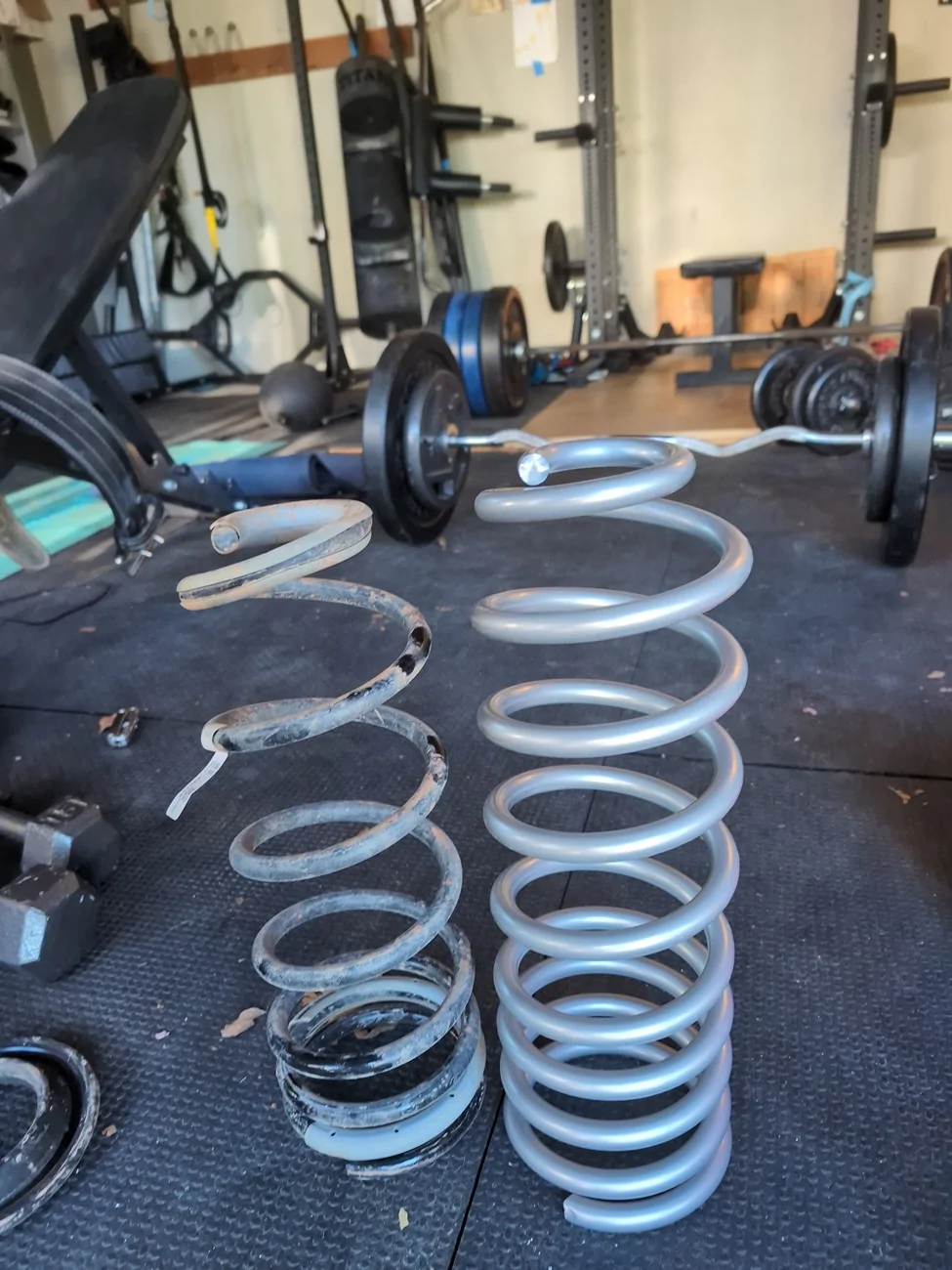

So I bought their 1" rear coil springs to compliment my Rancho 1.5" level it front coil springs and Eibach shocks all around.
Installed them today, install was easy, rear coils take maybe 25-30 minutes a side. Hardest part is lining up the dam rubber upper isolator nipple with the hole.

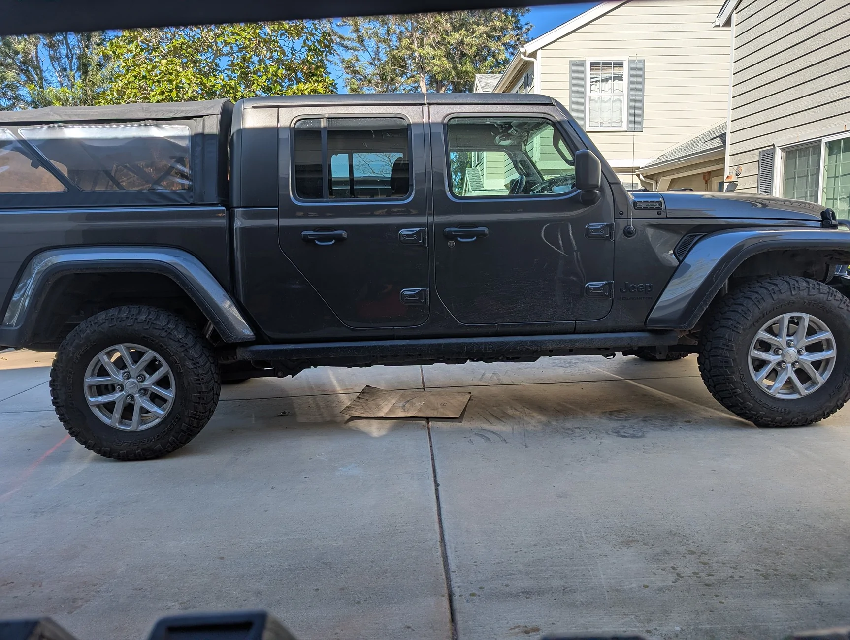

Like most lifts, their coils are designed to lift a Rubicon. So their 1" coil lifted my sport and actual 1.5".
Which is perfect because I got 2" form the Ranchos up front. Truck has a nice 1.5" rake again.
Ride is exactly the same as OEM coils as the spring rate is similar.
I'll need longer sway bar end links but no track bar needed. Axle didn't even shift left or right.
