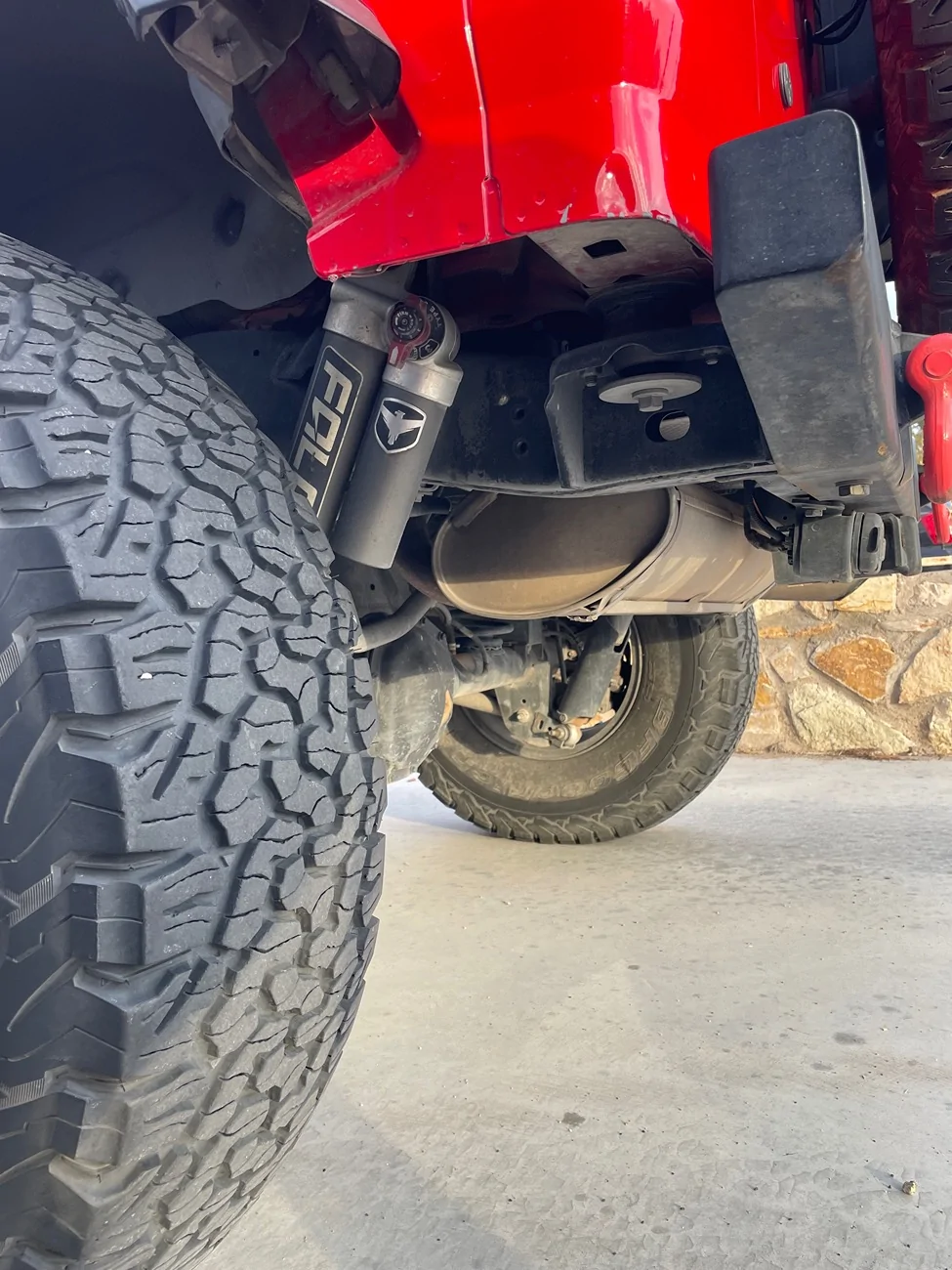

I did find an image of a JK with them upside down.
Thanks. I could have just looked under my truck, huh ? 😂 Sometimes I can’t right then for whatever reason. But yeah, F that with the shock body upside down for multiple reasons.

On the JL Wrangler they are not upside down. With the way the rear shocks are mounted on the JK you would have to crawl under it to adjust them if the knob was on top.
Jeep Gladiator Let’s talk shocks: Falcon 3.3 vs Bilstein 5160 IMG_9430
