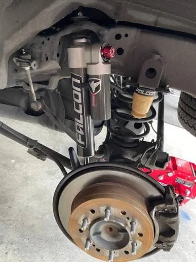

The Wrangler rear shocks are on the outside, on the Gladiator they are on the back side so they face the inside of the wheel well.
Jeep Gladiator Let’s talk shocks: Falcon 3.3 vs Bilstein 5160 IMG_9428
Not my Gladiator as I have Mojave Fox shocks on it.

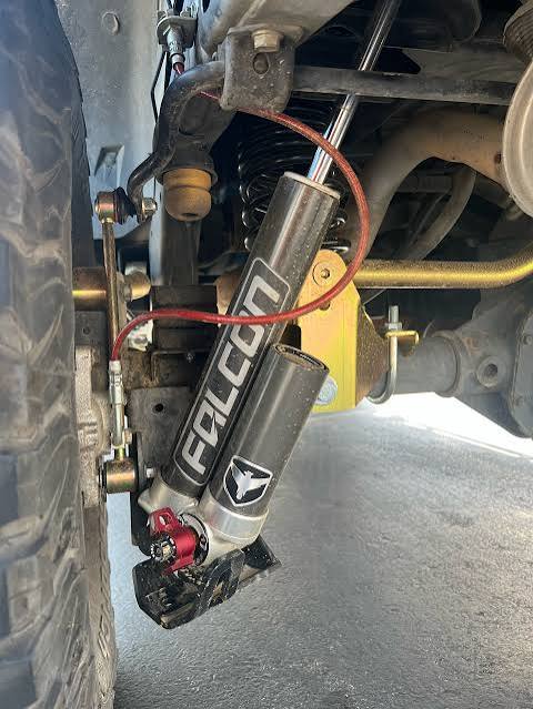

I did find an image of a JK with them upside down.
Jeep Gladiator Let’s talk shocks: Falcon 3.3 vs Bilstein 5160 IMG_9429
