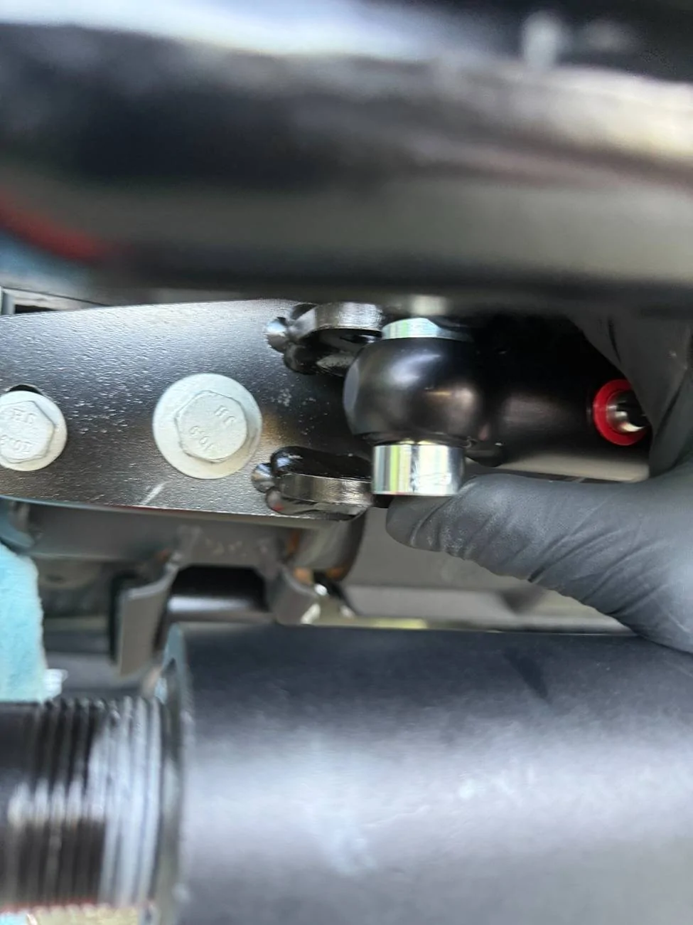

Got a question if you do! Because i cant get my FOX ATS to fit inside the bracket
Glassco Member First Name Ivan Joined Jun 1, 2025 Threads 5 Messages 13 Reaction score 5 Location Houston Vehicle(s) 25 JT Texas Trail Jul 17, 2025 Thread starter #1 Got a question if you do! Because i cant get my FOX ATS to fit inside the bracket Sponsored
whysoserious Well-Known Member First Name Joe Joined Mar 20, 2023 Threads 13 Messages 546 Reaction score 921 Location Central Texas Vehicle(s) 2021 JT Mojave, 2006 Rubicon Occupation Professional former employee Jul 17, 2025 #2 SteerSmarts says... "***Note*** JL/JT Fox brand stabilizers w/ machined bushing will not fit w/o modifying the bushing slightly -- a few mm will need to be removed to fit properly."

Walldo Well-Known Member Joined Mar 19, 2020 Threads 3 Messages 183 Reaction score 224 Location East of Albuquerque Vehicle(s) 2020 Gladiator, 2016 JKUR Jul 17, 2025 #4 I used the Fox ATS for a Jk with the Smart Steer bracket, tie rod and drag link. No issues. Sponsored
