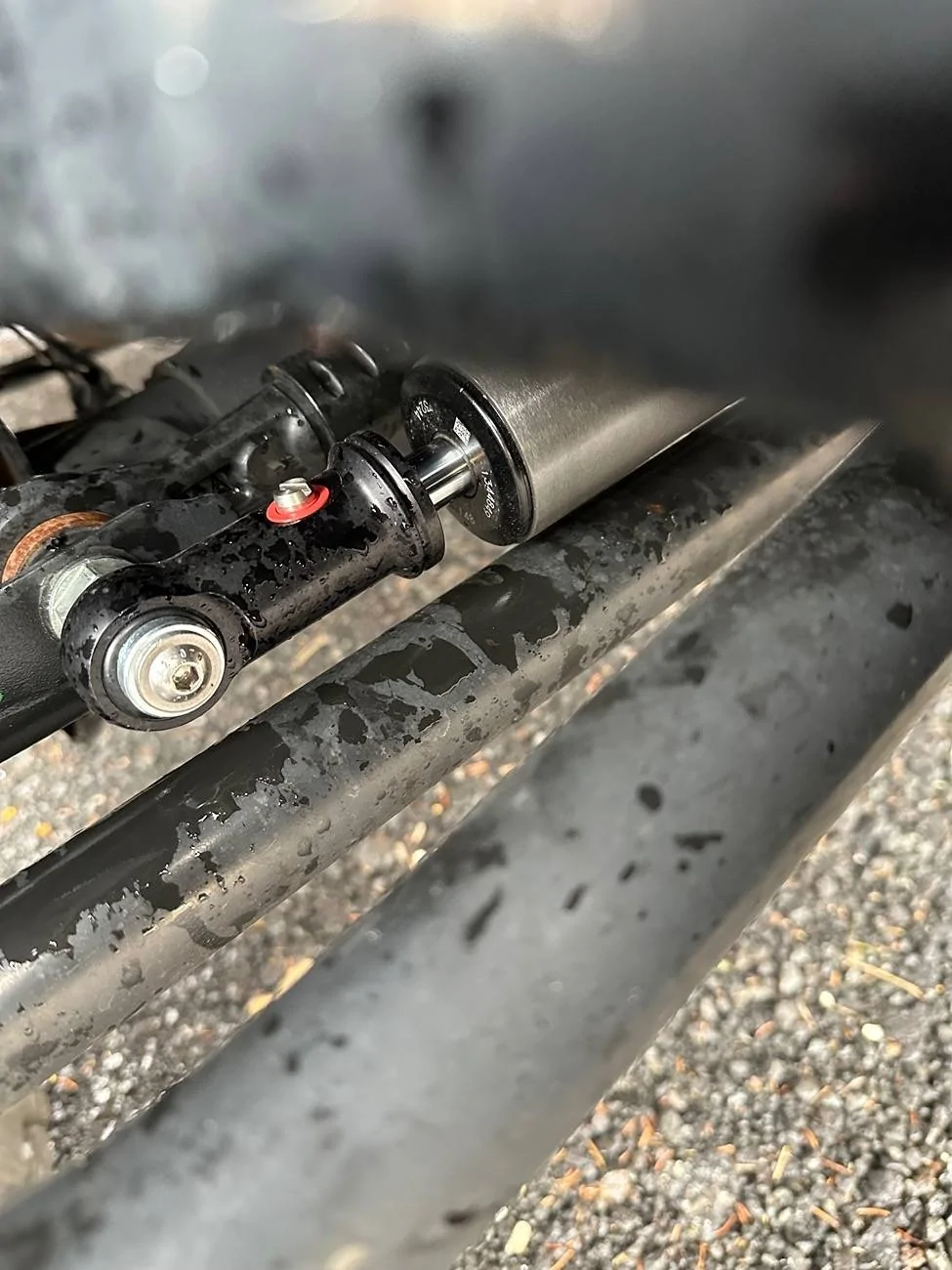

Could you guys post a full lock to the passenger side photo for me to see?
I’m wondering if I’ll need to adjust mine. Not sure if it’s pushing against the stabilizer when I’m turning all the way to the right. Earlier I pulled out of a parking spot and it felt like I needed to do a 2 point turn to get out of a big spot.
The photo is mine, all the way to the passenger side without someone or something holding the steering wheel.
Instructions does state that all the way to the passenger side needs to be 1/4”. I’m wondering if it’s where someone will need to hold the steering wheel and then set the stabilizer to the 1/4” clearance.

You can stick a piece of tape at knuckle steering stop and apply a little grease on the shaft, then turn to full lock and checks.

Mine touched at full lock, I just installed a Clayton relocation bracket and it made the fit perfect and gave me a extra 3/8" clearance.
https://www.claytonoffroad.com/prod...bilizer-relocation-bracket-2007-2020-jk-jl-jt

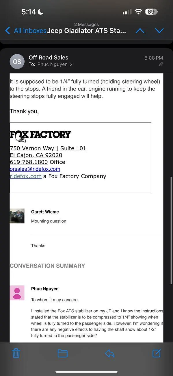

Got the confirmation from the Fox service techs.
You’ll need someone to hold the steering wheel full lock to the right and then it should be a 1/4” from there.

you also need to verify in both directions you have extra play. i would remove the stabilizer and use a sharpie to mark the max fully extended length and how much shaft is exposed then target to have 3/8" of extra, same applies for the other end too. I would use a point pen and mark stuff and refine stuff until i get everything where i liked it. The marks help you track your adjustments. Then use break clean to remove the marks or leave them so you can see if the clamp moves or turns.
